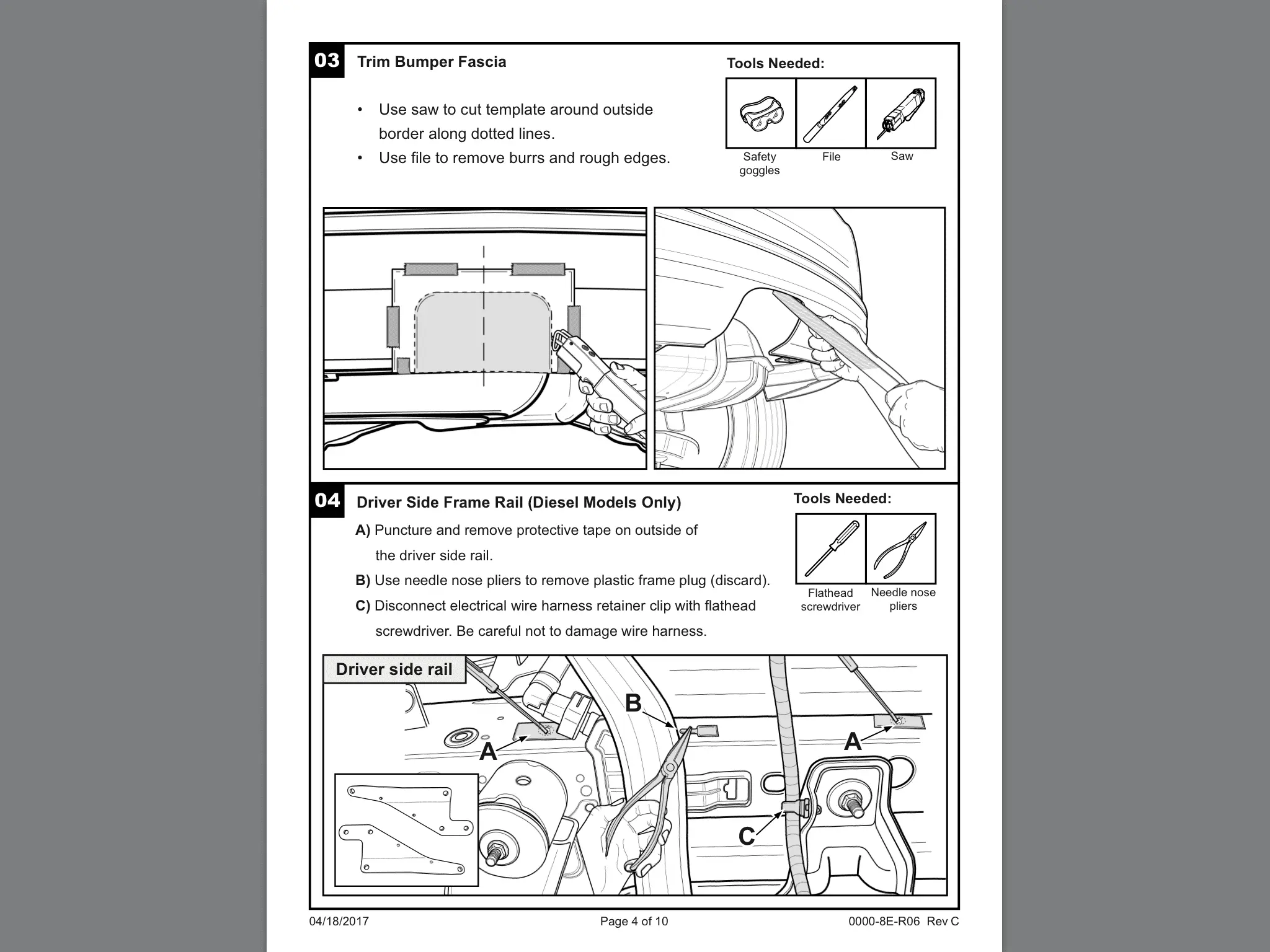

Yes, thanks for posting this! That is what I expected. Mazda corporate admitted that this is not what the installs look like now. The new ones require a cuttout like the template I posted earlier.

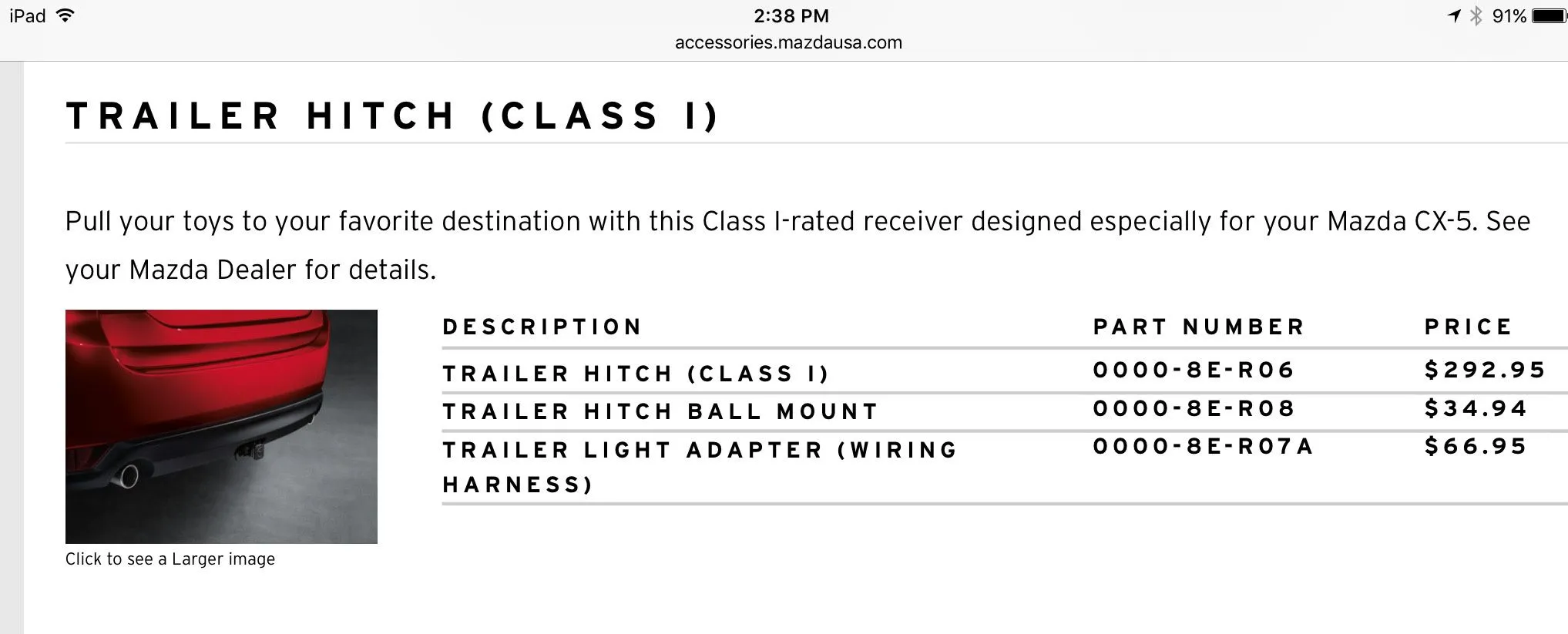

Found it. Right from the Mazda USA accessories site:
Does not look like mine.......

Wow... I thought that picture was actually a joke. I'm speechless... just a reminder keep doing auto things myself.

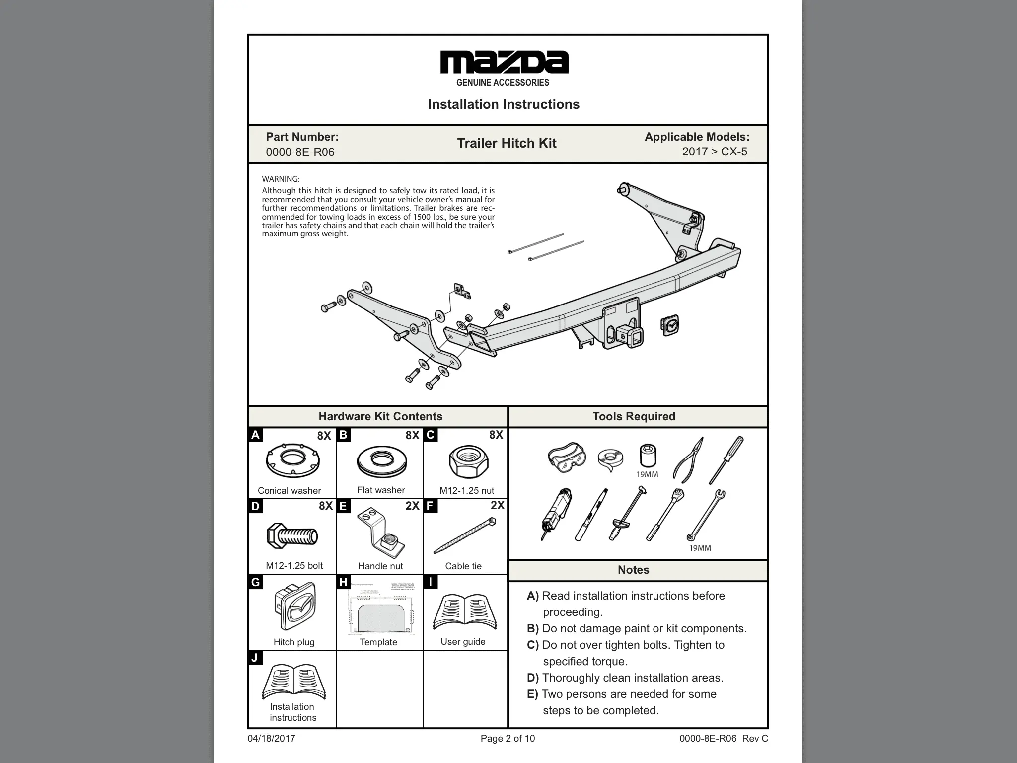

Looked everywhere for this, could not find the install manual. Dealer will be getting a copy.

Maybe that's the problem, CX-5 OEM is a class 1 not a class 2. I think the CX-9 has an OEM class 2.
I think that there is a cutout on the CX-9 Class II installation. The picture shows the hitch high up close to the crease in the bumper. I requested that a Class II be put on my CX-5, which most likely resulted in a cutout although the Mazda installation guide shows a similar installation with cutout for the Class I but with a much smaller hole than mine. See attached photo.

As far as I know, there is no OEM class 2 hitch for your car. all the aftermarket hitches i have seen for the CX-5, sit below the bumper and don't require a cutout. Even the CX-9 cutout would not be a giant hole like on yours.
Looking at the cuts made on your bumper, even if they had the wrong template, the person went way outside the lines - you have cuts outside the hole. I would give up trying to figure out what happened here.
