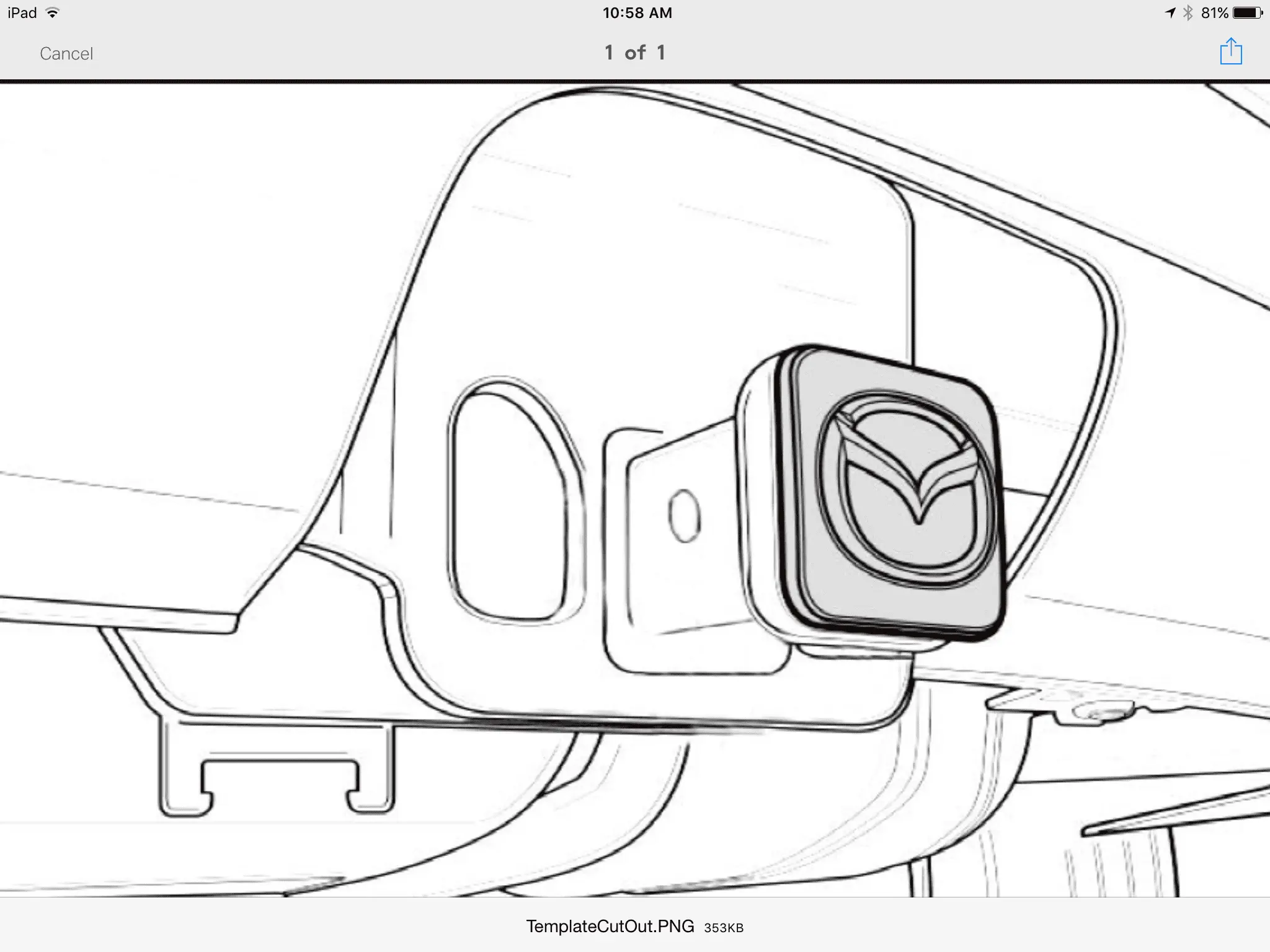

I have no reason to post fake stuff. This is hard to believe but true. My purpose here is to warn others and hear suggestions as to what the solution(s) might be. The dealer used the wrong template and did a horrible job cutting the bumper. Should never have been delivered like this. The service department head told me that he was upset that his guy did it this way. Of course I asked him why he approved the delivery! This A big dealership in our area.
My main point is that buyers should be aware that the OEM hitch requires a cutout and some dealers are not aware of the proper way to do this. Customers should be made aware of this before the installation. I added a picture from Mazda Customer care that shows the proper hole template/cutout.
Tom

FYI - this is our official accessory for towing:
You can get different aftermarket types here which including a cut out of the bumper

If they do install this trim as you mention, how will it be supported from behind? That’s a big cut out. The usual Mazda installation involves some trim but that is to cover the cut edge and make it look finished.
No problem puyapim. I totally agree that there are those who complain about everything. The responses here have been helpful to me and I have a clearer idea as to what needs to be done. As I reported earlier, Mazda Customer Care in CA was excellent. The Garnish part covers a large part of the bumper and will pretty up the hole while protecting the bumper. Probabaly best solution to put it to bed. Hopefully my posts will alert others to ask the dealer how their hitch will look once installed.
