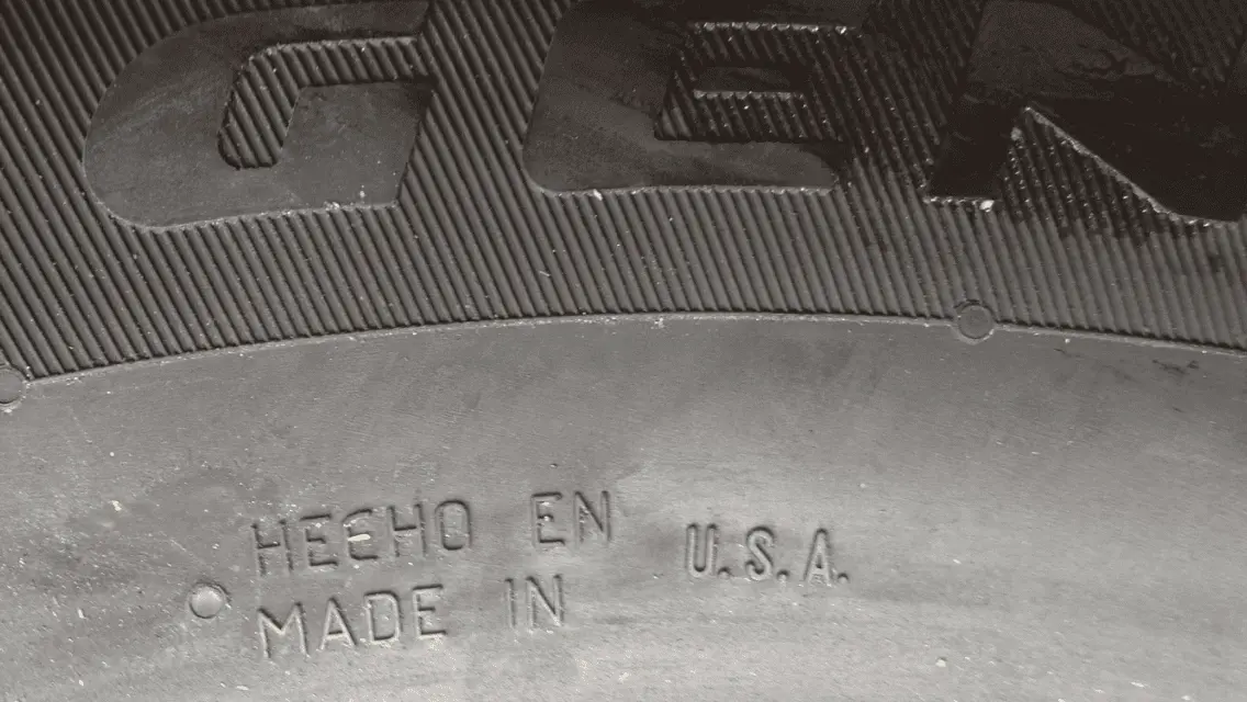

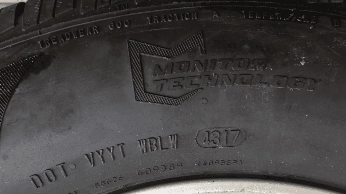

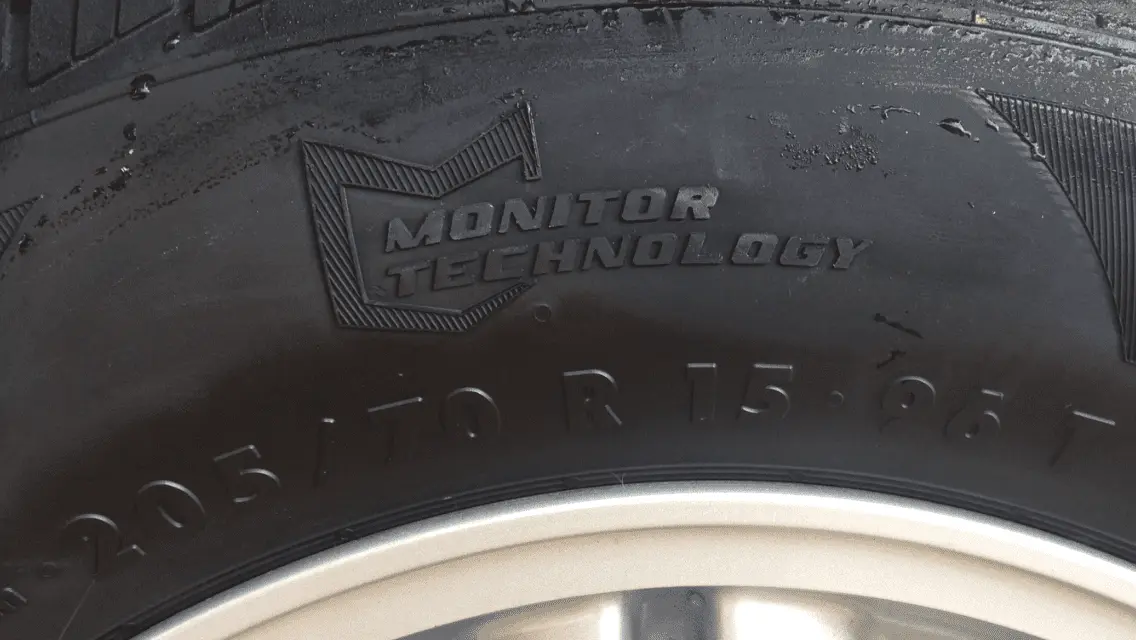

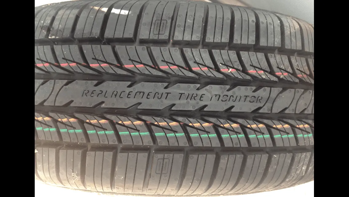

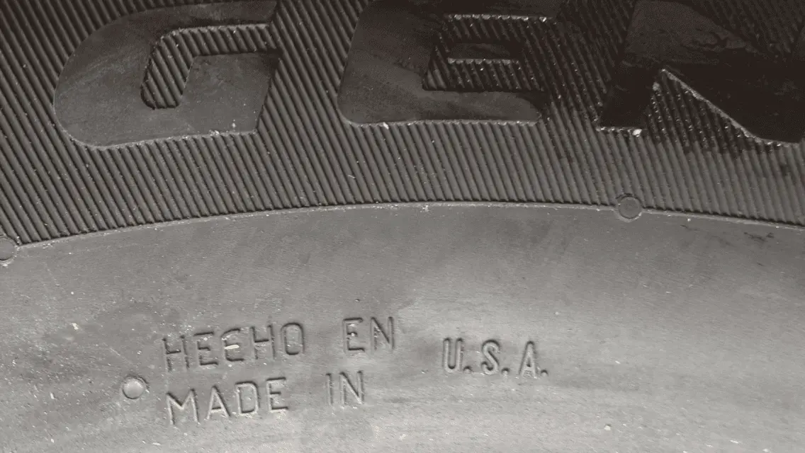

DOT tire date code is stamped only on one side of tire and is required to be seen. That's why I said one side of tire with DOT date code has to be mounted on the outside. General tires have their unique "Monitor Technology" on treadwear: "Replacement Tire Monitor" and "Visual Alignment Indicator", both can be seen in the picture of USA made 205/70R15 96T RT43's on my 1998 Honda CR-V:
attachment.php
attachment.php
attachment.php
attachment.php
