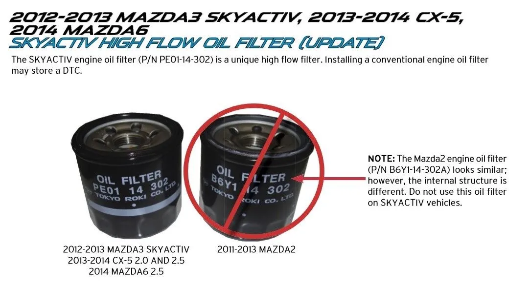

Nobody knows but here is Mazda North American Operations' PDF to their US Mazda dealers concerning genuine oil filter's installation on SkyActiv-G engines:
Here is one MNAO PDF to their US Mazda Dealers concerning genuine Oil Filter(s) installation and use for ALL SA Engines..
Mazda Dealers (in USA particularly) are also seeing stored DTC's (Diagnostic Trouble Codes in PCM) when they use even 'other' genuine Mazda oil filters in Skyactiv engines, see pic, they look identical, but it is what is inside.
attachment.php

Here is an official document from Mazda North American Operations stated that don't mix OEM oil filter used on Mazda2, although it looks similar, with CX-5 SkyActiv-G engine althiough aftermarket filters usually use only one to fit all:
Just want to throw this in here, DO NOT use a non genuine Oil Filter in any Skyactiv Engine, diesel or gasoline.
These oil filters are specifically made and designed for Mazda by Tokyo Roki.
Non genuine oil filters do not have the correct by pass and flow rating.
Using the incorrect Oil Filter can also throw up DTC's (Diagnostic Trouble Codes, 'CEL' light on dash)
See PDF from Mazda USA ( for SA-G)
Since the original pdf file is an attachment and has been missing for a while after our server update, I took a screen shot and post it here:
attachment.php
Yeah I don't believe using those one-size-fit-all after-market oil filters would damage the engine in the short term ior may be in the long run. But I certainly won't use them just to save a dollar or two as the saving here is very minimum.
Mazdas notice makes absolute sense, thanks for sharing again. The Mazda 2 had a tiny little filter that is not up to the task of the SkyActiv engines. That being said, there's no reason the SkyActiv filter couldn't work on the Mazda 2.
Yeah I don't overthink the filter, I just have always noticed that the aftermarkets around here are more expensive than me ordering the OEM filters and the OEM filters are of excellent quality (Thailand made ones).
No, OEM B6Y1-14-302A for Mazda2 has exactly the same size as those OEM oil filters used by SkyActiv-G engines like the Mazda notice said. Also remember many one-size-fit-all after-market oil filters such as Mobil 1 M1-108 / M1-108A were on the market for 2012~2013 Mazda2 even before SkyActiv-G came out. This makes me believe their specs don't meet the SA-G OEM filters which came out later.
