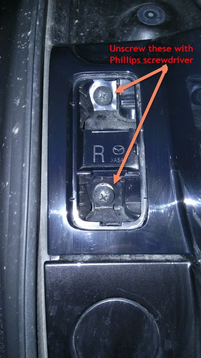

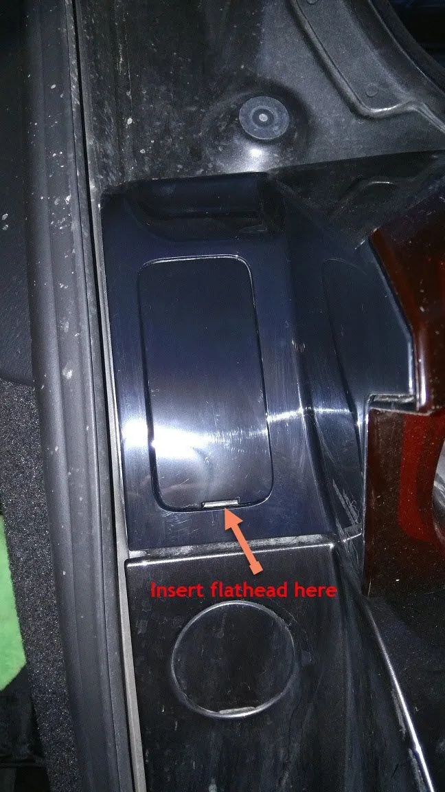

    2. Open the liftgate, then pry open the screw cover on the tail lamp. Use a flathead to pry it out.
    3. With the Phillips screwdriver, unscrew the two screws and set them aside.

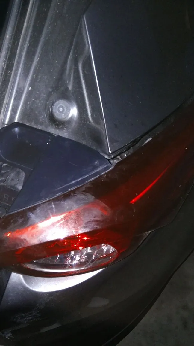

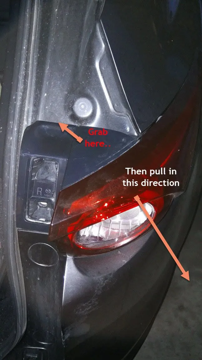

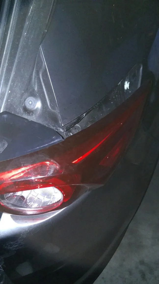

    4. This is the hardest part. Grasp the lamp housing at the top, and pull "back and out". You'll want to apply force gradually rather than trying to muscle it out forcefully. It should look like the second picture when it is loosened.
    5. If you can, wedge your fingers in the space created, and continue applying gradual force "back and out", but this time, more "back" than "out" to get the lamp loose. I took my time with this step, and I'm not sure how delicate you need to be with these housings. When it's free, it'll look like this.

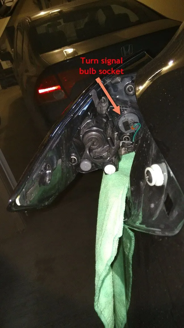

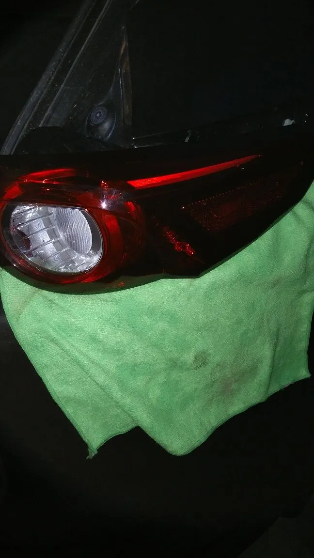

    6. At this point, it's a good idea to wedge a microfiber or something between the lamp and the body to prevent accidental scratches.
    7. The grey socket is the turn signal. Turn it counter-clockwise about 1/4 turn.

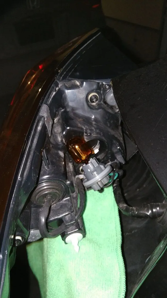

    8. The socket can now be pulled out, exposing the OEM bulb. Replace it with the new bulb. *** see post #3 at the end of this guide.
    9. Reinsert the socket, and turn it clockwise until it locks into place.

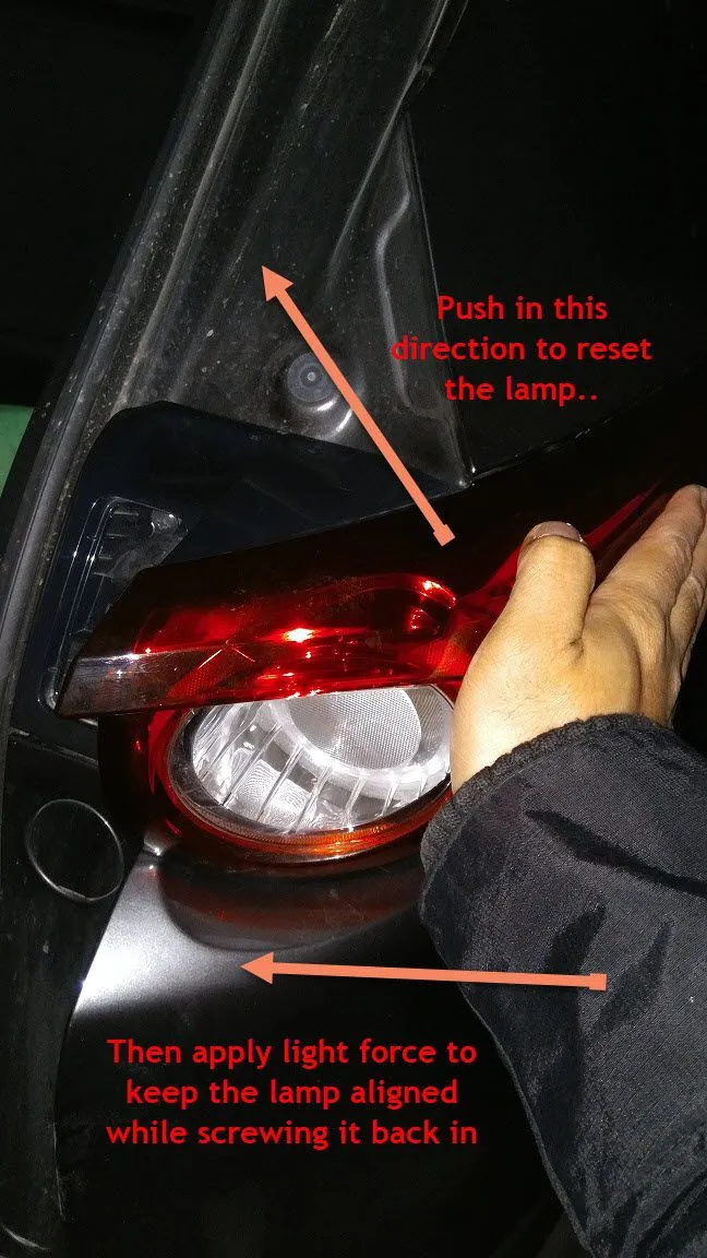

    10. Reset the lamp housing. Be sure to reinstall it by pushing it in the direction opposite the one used to pull it out. When it has been reset, apply some constant light pressure to the housing to hold it in place while you screw it back in. Put the screw cover back on.

    "When putting your taillights back in place, there is a mounting point on the body of the vehicle that receives a slotted tab on your taillight. There's a firm what I think was a rubber collar on the mounting point. When you are pushing the light back into place it takes a good amount of pressure and once it gives, it kinda sounds like you are slamming the light back into place. That is what you want to hear. Within reason of course. But you want to get that light properly seated back in place. The left light went right back first try no problem - I heard it slam. On my first try putting the right light back into position it went back but it felt spongey and it didn't slam. I took it out and did it a second time and I got the slam and it felt solid. In all actuality this probably isn't that big of a deal, but take it for what it is worth to you."
    I'm pretty sure I felt the same "slam" ACBGoldie is referring to when reinstalling my tail lights, but for whatever reason I seem to have left that detail out. If you watch the video below, you can hear the "slam" at the 1:40 mark. Thanks ACBGoldie.

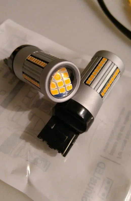

    Here's a YouTube video (sorry about the quality/shakiness!) showing the difference between the OEM bulb and the LED bulb I used. You can see that the light is brighter, crisper, and more yellow than the OEM light. There is also no hyperflashing when using the turn signals.
    Also, here's an Amazon link to the bulb I used (non-affiliate link). They are 7440A bulbs with built-in resistors. They are about twice as tall as the OEM bulbs, but fit in the housing perfectly. According to the listing, "they are rated 25 watts at 12 volts, which is the same as a standard 7440 bulb."
    *** If you purchased LED bulbs that have an external resistor, you may have to consult with the manufacturer to find out how to install them. The resistors I've used before would plug into the original socket, which avoids having to splice into the existing wire, like these ones:

    Today I replaced the these bulbs with the LASFIT 7440 LED with resistor built-in in just 10 minutes following this guide. Thanks sm1ke, every step was spot-on.
