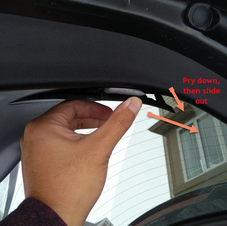

2. Open the liftgate, then pry open the bulb cover directly behind the light assembly. Use a flathead to pry out the slotted side, then slide the cover "away" from the centre of the liftgate to remove it.
attachment.php

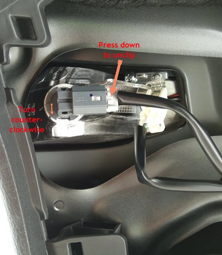

3. Unclip the white connector from the grey socket by pressing in the retaining clip on the white connector and sliding it out.
attachment.php

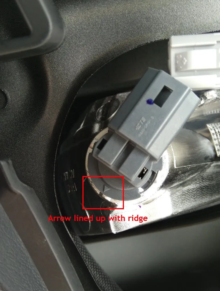

4. Turn the grey socket counter-clockwise. You'll feel resistance after about 1/4 turn, and the tiny arrow on the grey socket should be lined up with a small ridge on the bulb housing. Wiggle the grey socket out of the bulb housing.
attachment.php

6. With the bulb replaced, reinsert the grey socket into the bulb housing. Remember to line the arrow on the grey socket up with the ridge on the bulb housing when reinserting the grey socket. Turn it clockwise 1/4 turn to lock the socket in place.

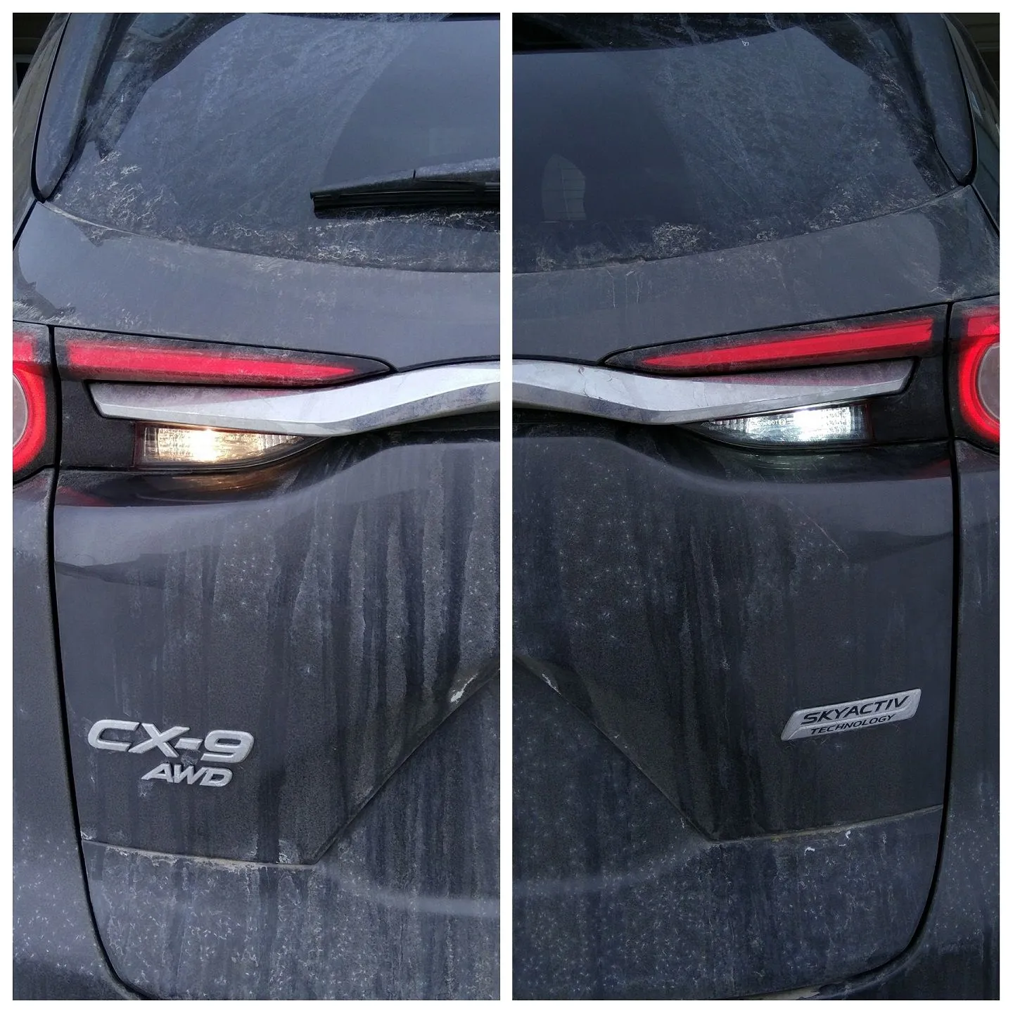

Here's a daytime comparison. I may reinstall a halogen bulb to do a light output comparison at night, as I forgot to do that lol. Also, here's an Amazon link to the bulb I used (non-affiliate link). They are 921 or W16W bulbs with built-in resistors, and measure 41 x 5 x 15 mm.
attachment.php
attachment.php
