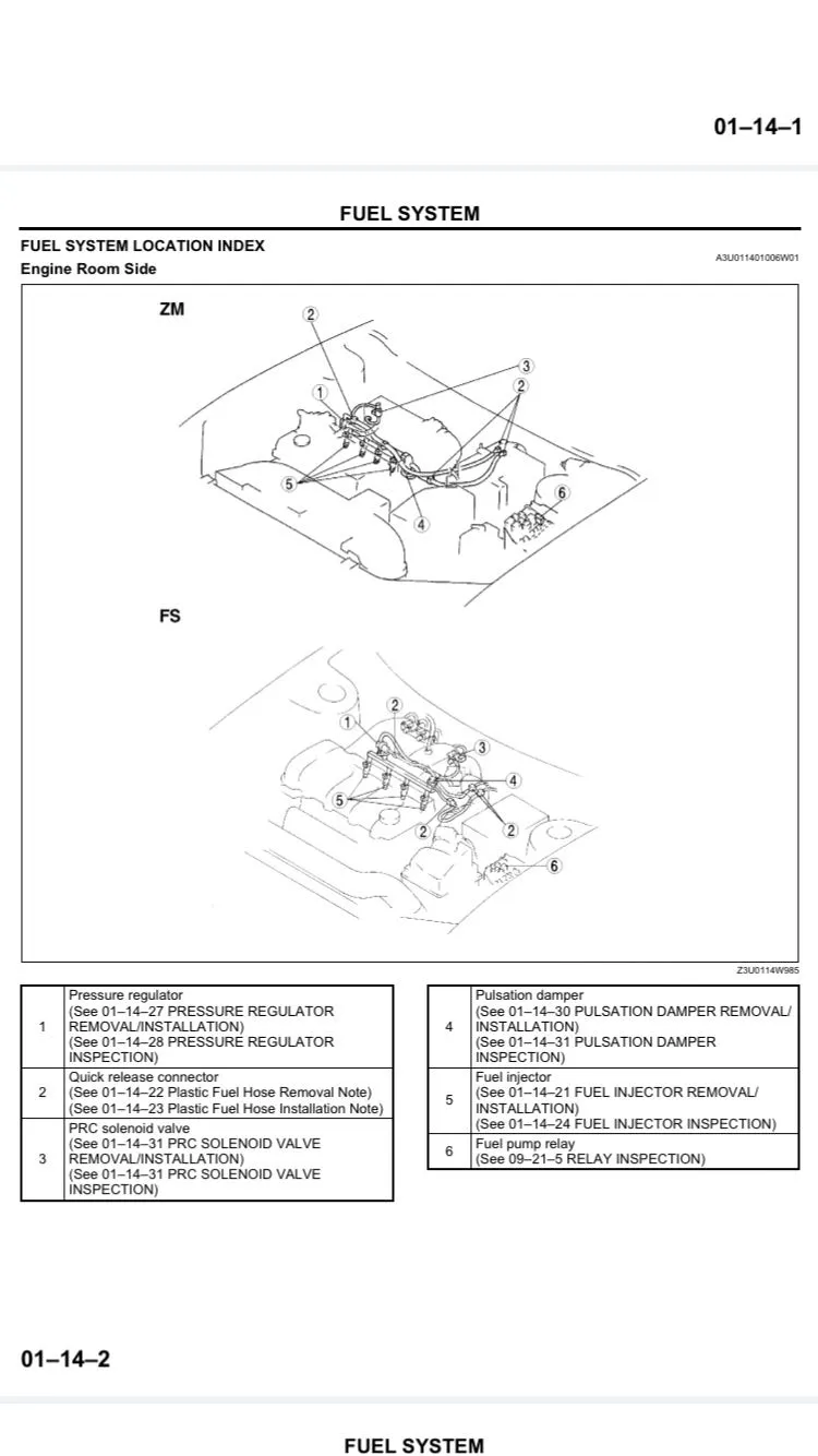

Also had a CEL for fuel pressure regulator, but put some Techron in it and it seems to be clearing up a bit. Since I am new to these cars, is the pressure regulator special to this model? Is it in the tank/pump assembly (like the Miata), or on the fuel rail? Hopefully it will clear up as the miles go on, but just in case...

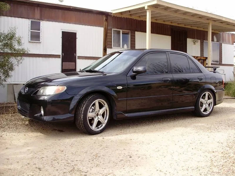

Pic attached...

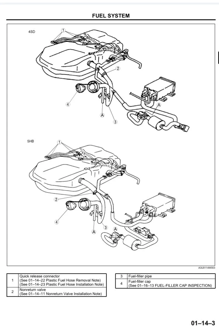

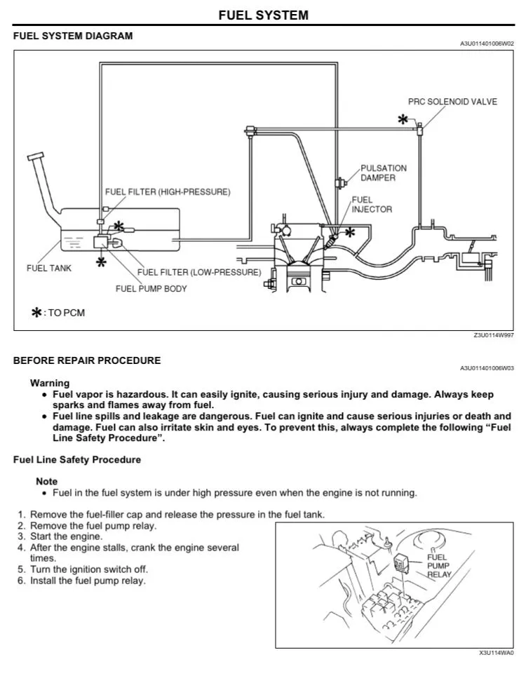

You’re never going to want to get rid of this car. I have the ‘03 P5 and will drive it forever. The car does have a rather unique fuel handling system in my limited experience - different from earlier Protgs at least. For example: it doesn’t have a separate fuel filter but one that is integrated into the pump near the tank and not a maintenance item. But the fuel pressure regulator is at the engine. See attached from the manualIMG_6997.JPGIMG_6998.JPGIMG_6999.JPG
