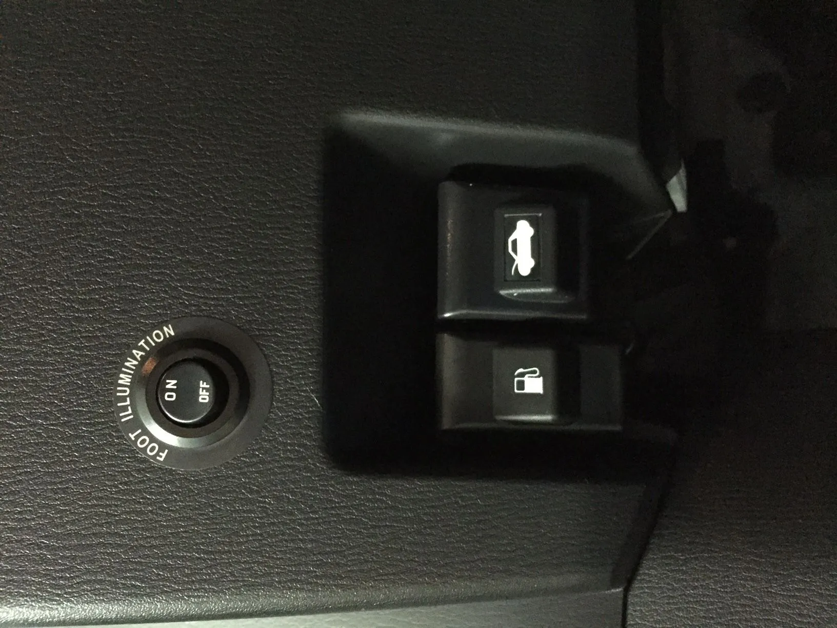

Cons: 1.to dim; 2.they installed a kill switch next to where the hood release is(it only kills when the door closed if chosen illumination off); 3. after installation rattling noise everywhere(took it to dealer they did not admit the noise due to their wiring) 4. expansive total cost $375.

Is the only difference that the switch being ON leaves the lights on all the time vs OFF only turning the lights on with the doors? Or does the off switch turn the lights off all the time.
I recently bought a 2018 CX-5 and had these lights installed. Took dealership 3 days to install, claimed it was the first time they had done it. The ambient lighting is currently synced with my factory interior map/dome lights. So when the dome lights cut out, so does the ambient lighting.
Install kit also came with an on/off kill switch. Although they installed it, the kill switch itself doesnt work. The Mazda dealership called Coporate engineers to help troubleshoot, but ultimately never figured it out. Anyone else have this issue with the ambient lighting kill switch not functioning?
+1 if someone can take some pics or a video. I just bought the kit but am now having second thoughts about installation.
I'm not sure if I understand how it will work in these cases
1. Switch off
a. Door open Lights On
b. Door closed Lights Off (Slow Dim Down After Closing Doors)
2. Switch On
b. Door closed Lights On

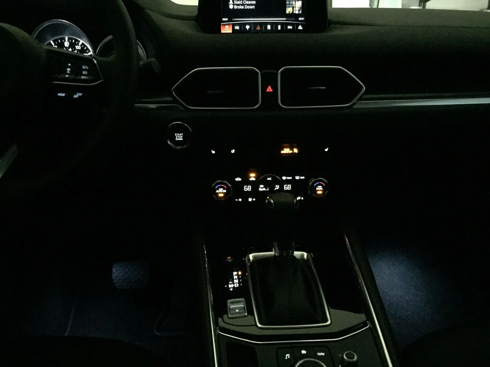

I have had it on mine since new. It's pretty subtle, but nice ambient light in the footwell areas.
attachment.php
attachment.php
I have had it on mine since new. It's pretty subtle, but nice ambient light in the footwell areas.]
So do you mind to answer the question gman35124 asked: "Is the only difference that the switch being ON leaves the lights on all the time vs OFF only turning the lights on with the doors? Or does the off switch turn the lights off all the time?" I kind of remember when I saw a schematic which shows "OFF" would turn the footewll lights off all the time.
