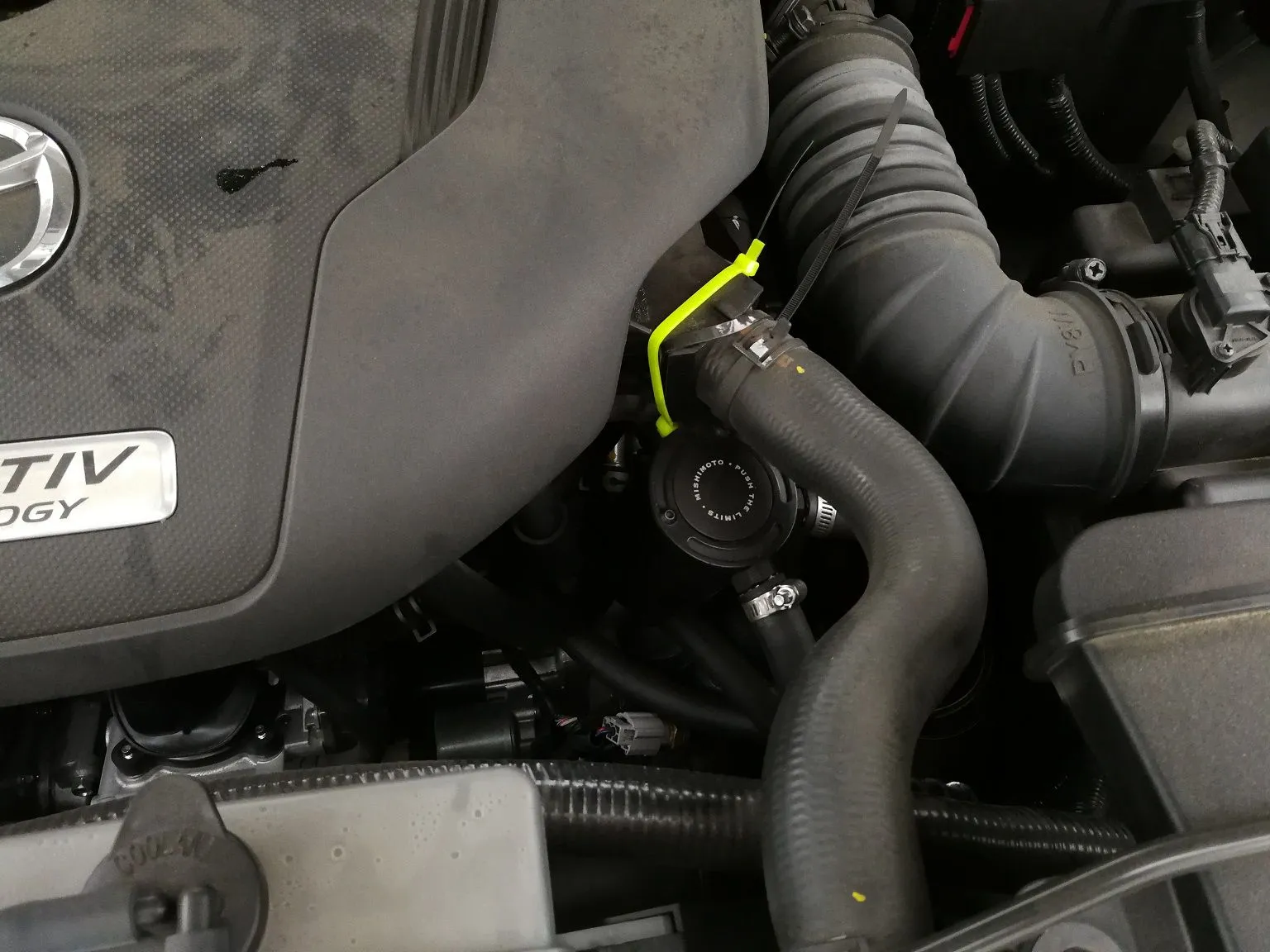

Just ordered the Mishimoto for my wifes new 2018. Have 100 miles on it now and plan to put it on hopefully this weekend.
Interesting thing to note is that little "L" shape tubing that connects the PCV to the intake tube has different size inlet and outlet. Outlet from PCV is 5/8" while the inlet to intake is 3/8". Make sure you get the right size tubes. I just change out my oil at 4k interval and drained out approx 1.8oz of oil/fuel from the catch can. So that is less than half oz of blowby per thousand miles which is pretty good I think.

"No need" is correct. However, see post #2 and #5. It appears there's still room for improvement, and the addition of an oil catch can does help.
SW, any chance you could take a few photos of your installed catch can and where you mounted it? Also to confirm, if adding an oil catch can, one should purchase a length of 5/8" tubing and a length of 3/8" tubing?

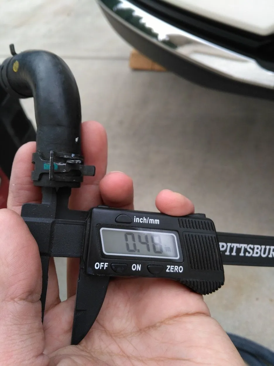

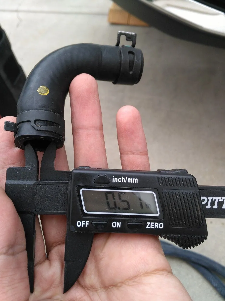

So I want to make a correction to the sizing of the "L" shape hose (refer to pictures above).
This is how I plumbed my can. So the 0.57" end stays attached to the PVC. I plugged the 1/2" splicer to the 0.48" outlet and connected to the 1/2" oil hose which went to the can's inlet. Another 1/2" oil hose bridged the can's outlet to the intake tube. Hope this make sense.
