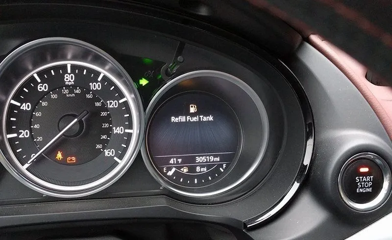

2017 Signature lemon?

No, at least in Car and Driver Long-Term Road Test case, the fuel gauge is NOT already sitting on E.
attachment.php

DBLXX did a full fill to dry tank drive test a while ago for his 2016 CX-5 Sport FWD. It went 62 miles PAST when it initially said "0 miles to Empty." This should be expected by most vehicles but apparently not on CX-9. This raised a question, why Mazda wants CX-9 to be different from everybody else on Range to Empty, including its sibling CX-5 if CX-9s Range to Empty is really that critical with no margin to error?
I was amazed that many people here only criticize OP who waited too long to get gas, but ignore the fact that the first time when it happened OPs CX-9 showed 120 miles to empty and caught him by surprise. If the problem on OPs 2nd incident is due to a totally dry tank, Id still blame it on Mazda as why a vehicle would run out of the gas when the range still showed 6 miles and it wont happen to any other vehicles. The 3rd time, it proves OPs CX-9 did have problems again and Mazda North American Operations agreed and replaced high-pressure fuel pump! OPs negligence? Definitely not! Calling MNAO Customer Experience Center? Definitely is fine as that is what CEC there for; especially OP didnt even get a loaner car during a week long repair!
1st full fill to dry tank drive
Full fill up (to the top of the filler neck) to 62 miles PAST when it initially said "0 miles to empty."
516 miles in total

As an engineer, I honestly have to say that's just not good enough. I can't stomach that kind of error rate. I don't have it in my 2018 and I cannot condone it in the OPs vehicle. As I stated before, it is just too far off. This swings in the opposite direction that other people are reporting in other threads where they chime in with a nice Reserve beyond the needle first coming in contact with the "E" marking.
If it were something significantly below 30 miles, yeah. But, as a design engineer, I would not accept this. As a customer/owner, I would definitely be concerned and searching for a fix, if one existed. If no fix existed, in all honesty, this would be a game changer for me. That coming from a guy who absolutely adored his 2017 Sig and now adores his 2018 Sig to boot.
This needs a fix.
I was amazed that many people here only criticize OP who waited too long to get gas, but ignore the fact that the first time when it happened OP’s CX-9 showed 120 miles to empty and caught him by surprise.
Which is why my first post to the OP was: https://www.mazdas247.com/forum/sho...nature-lemon&p=6565464&viewfull=1#post6565464
I think the OP has confirmed that there is indeed a problem with his CX-9. Now, the question is how soon can Mazda fix it - or will Mazda fix it at all. Again, we are dealing with the mass production environment and in such a caldron, there will be anomalies like this and others. Having said that, both Baby and Bath Water should remain together.
