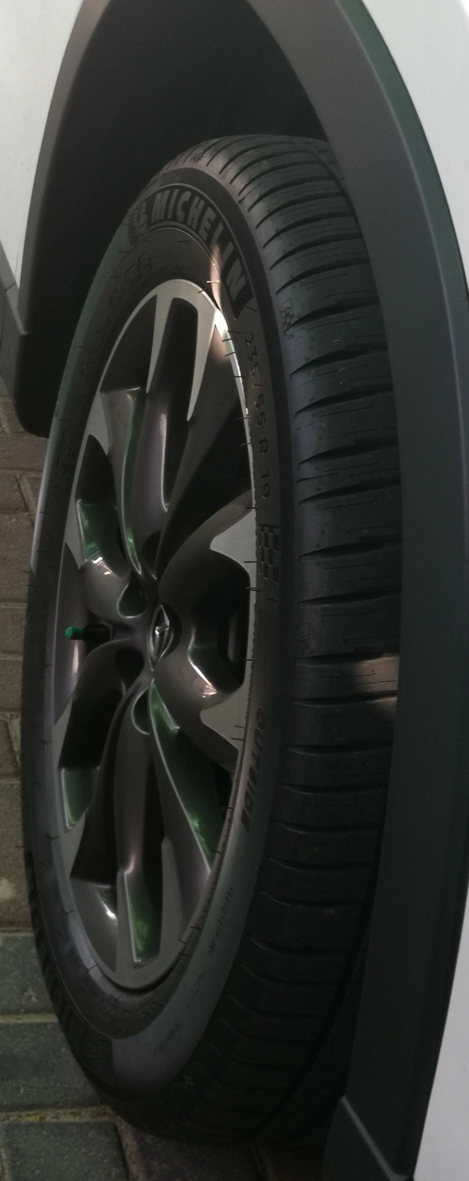

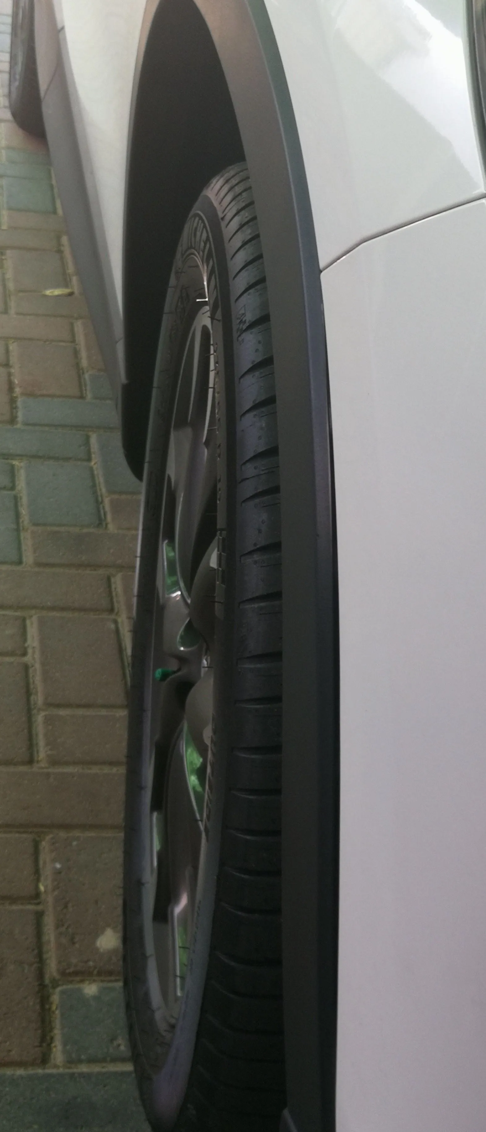

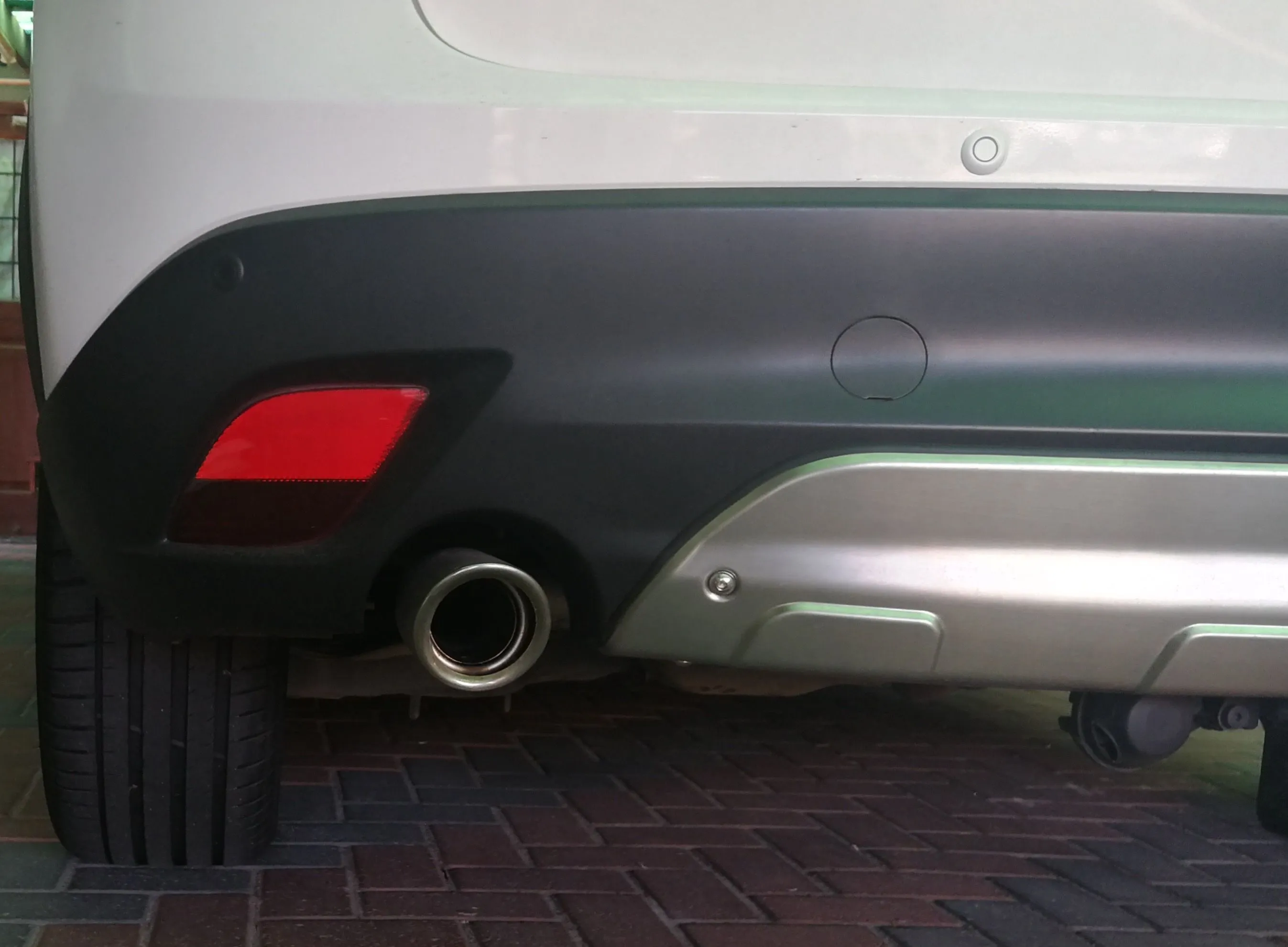

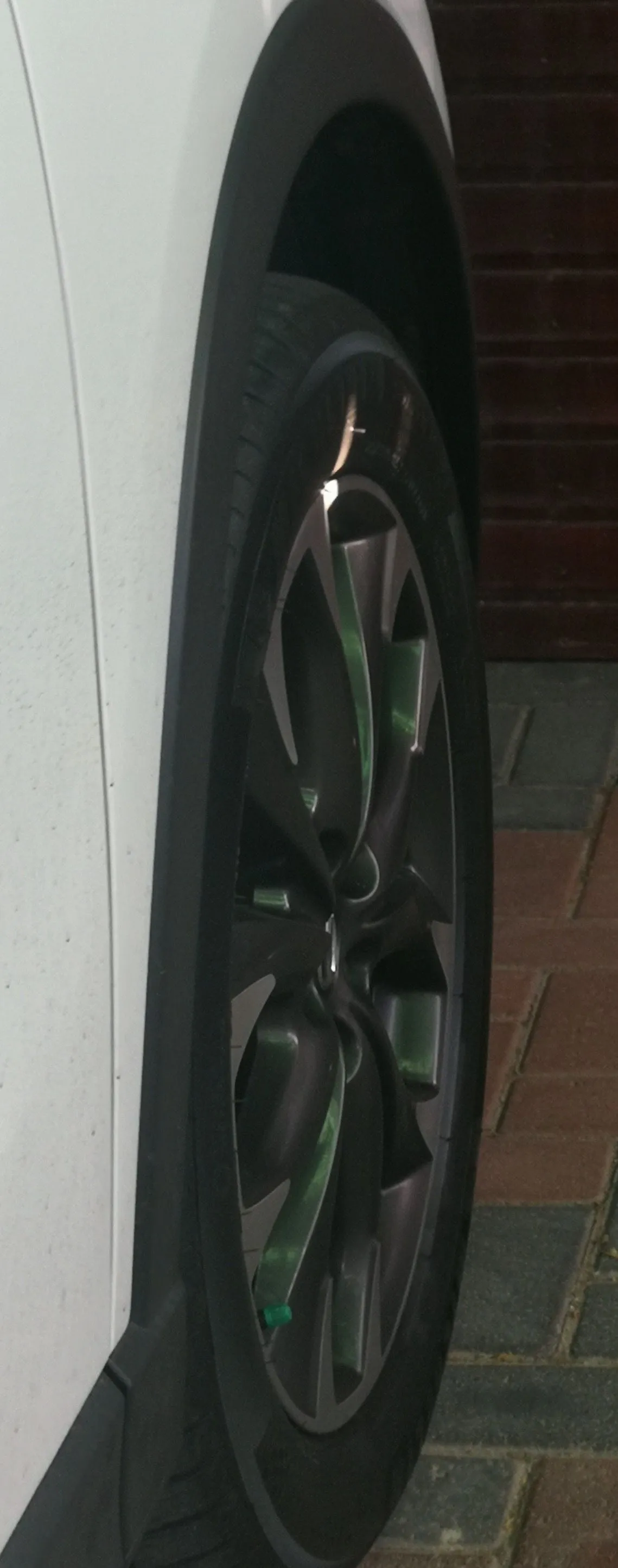

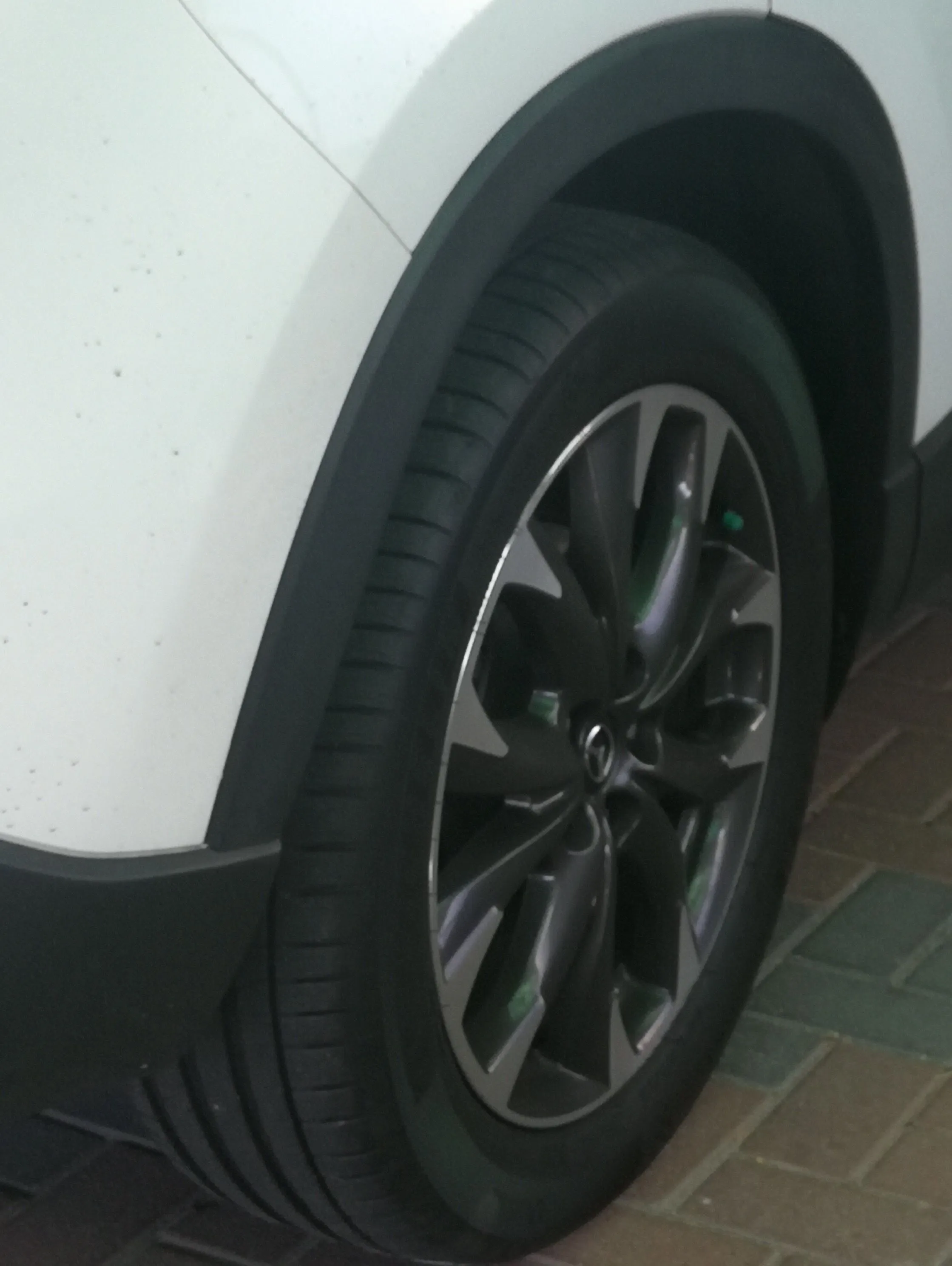

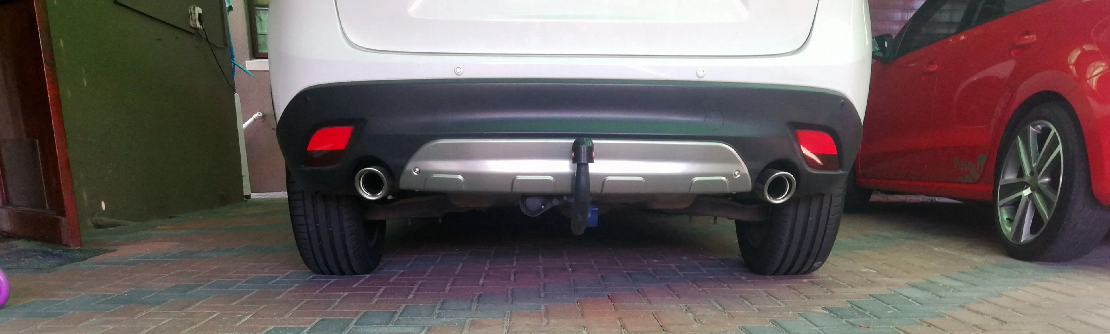

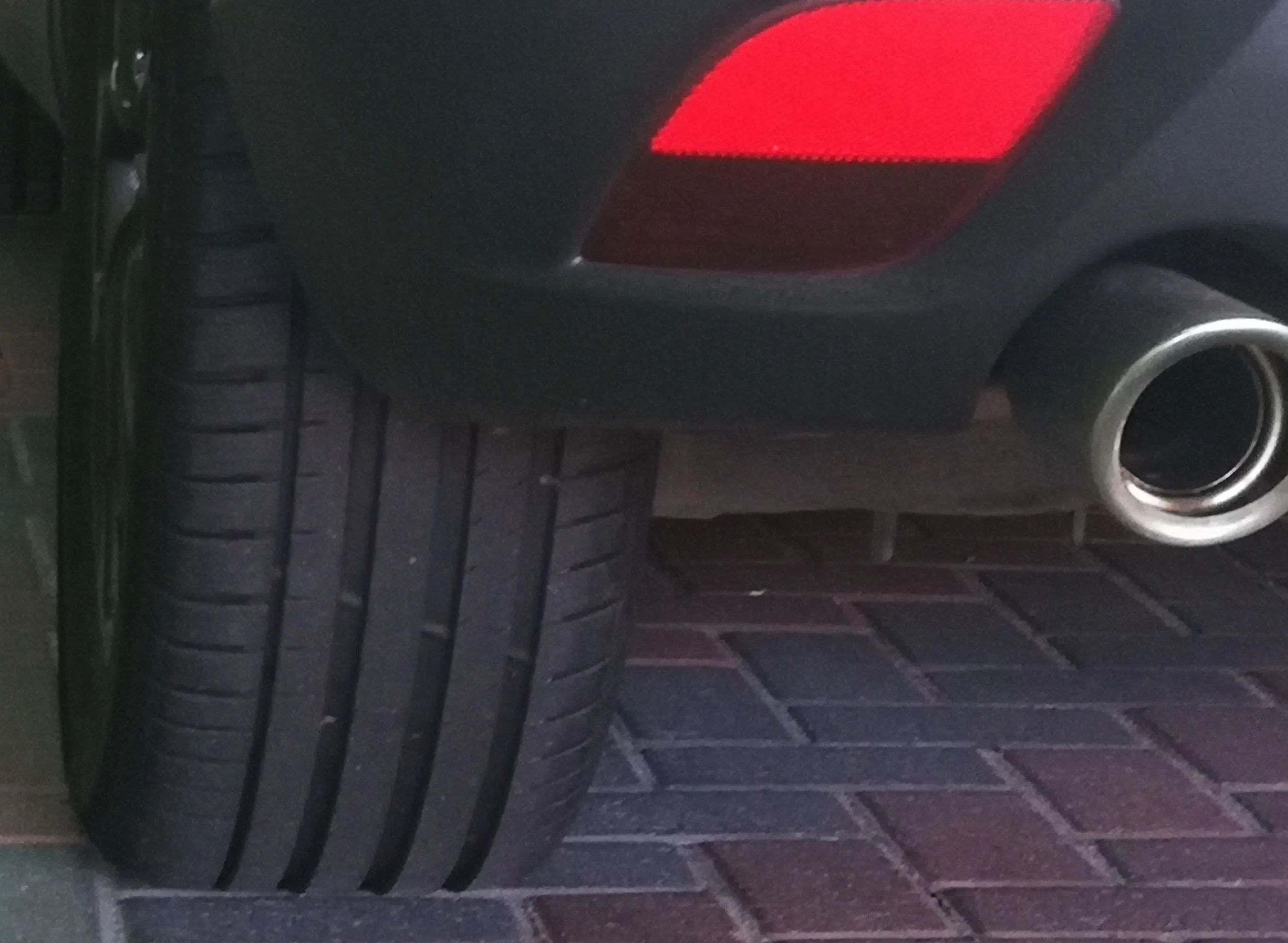

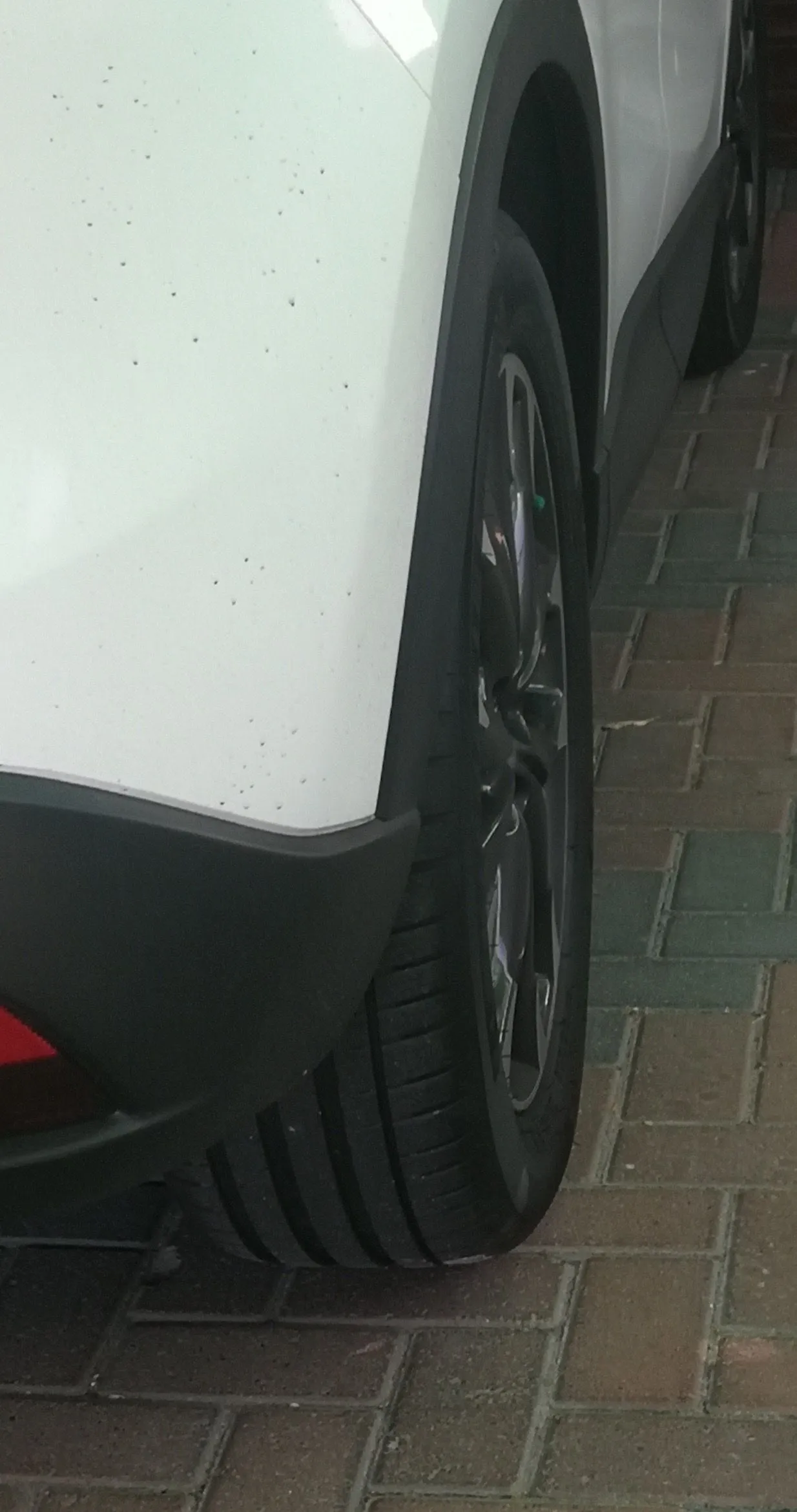

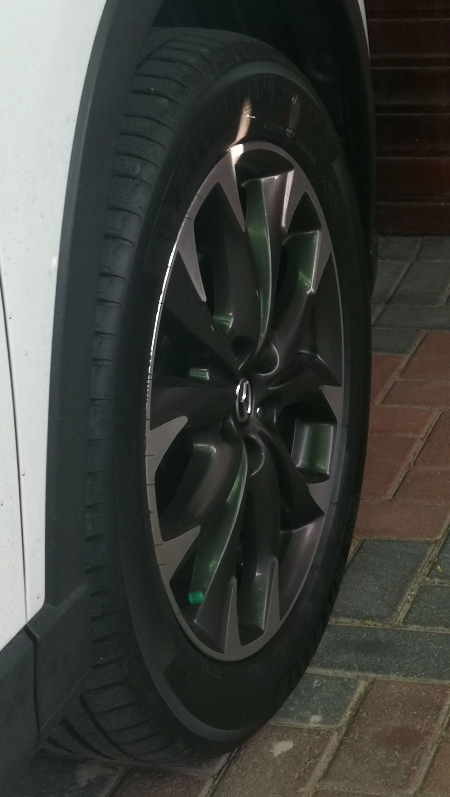

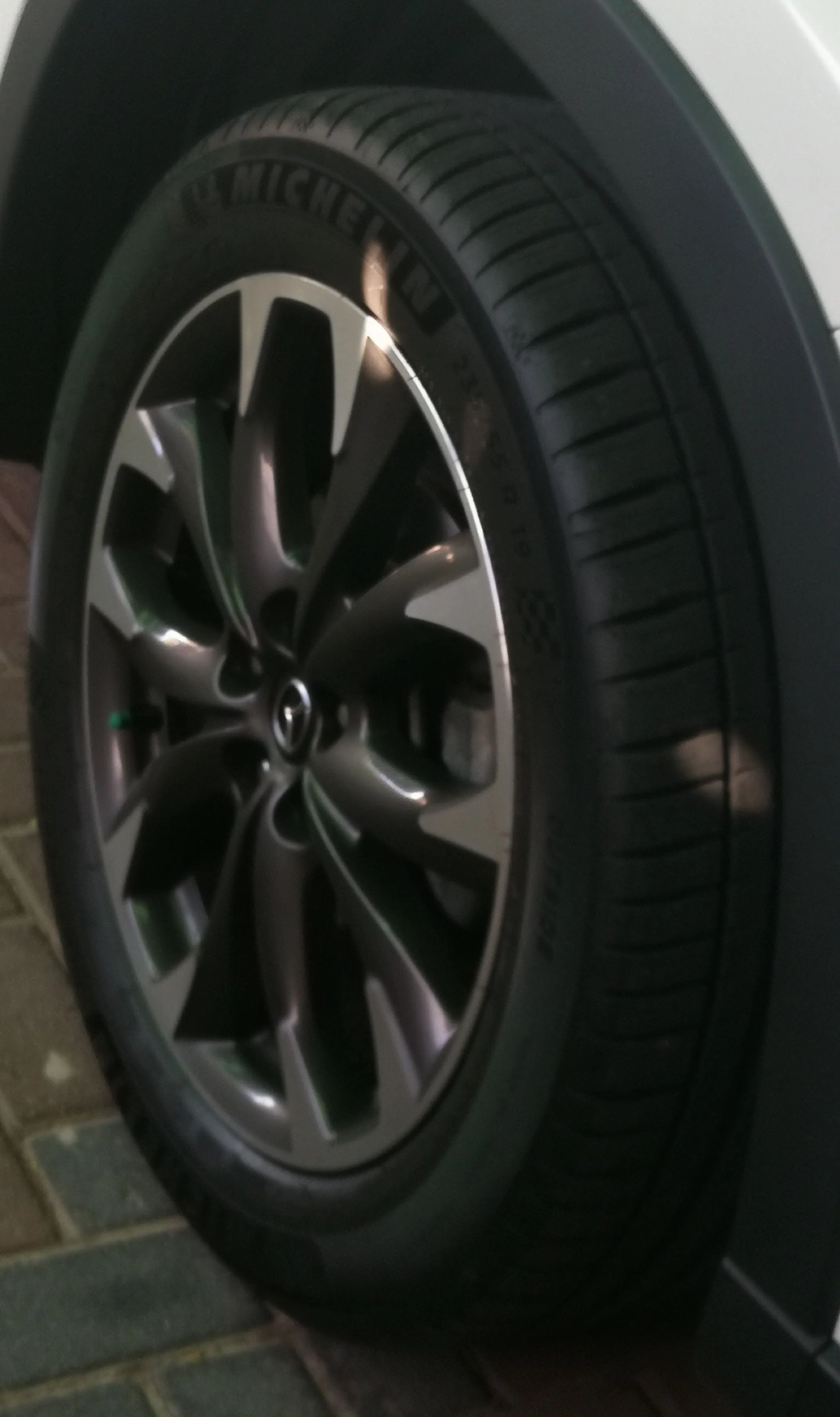

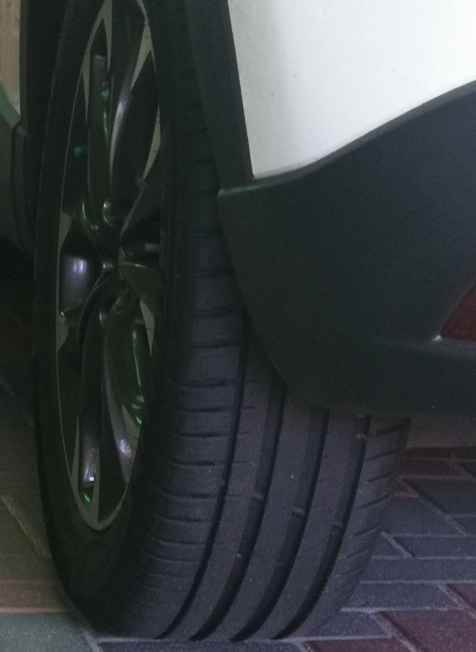

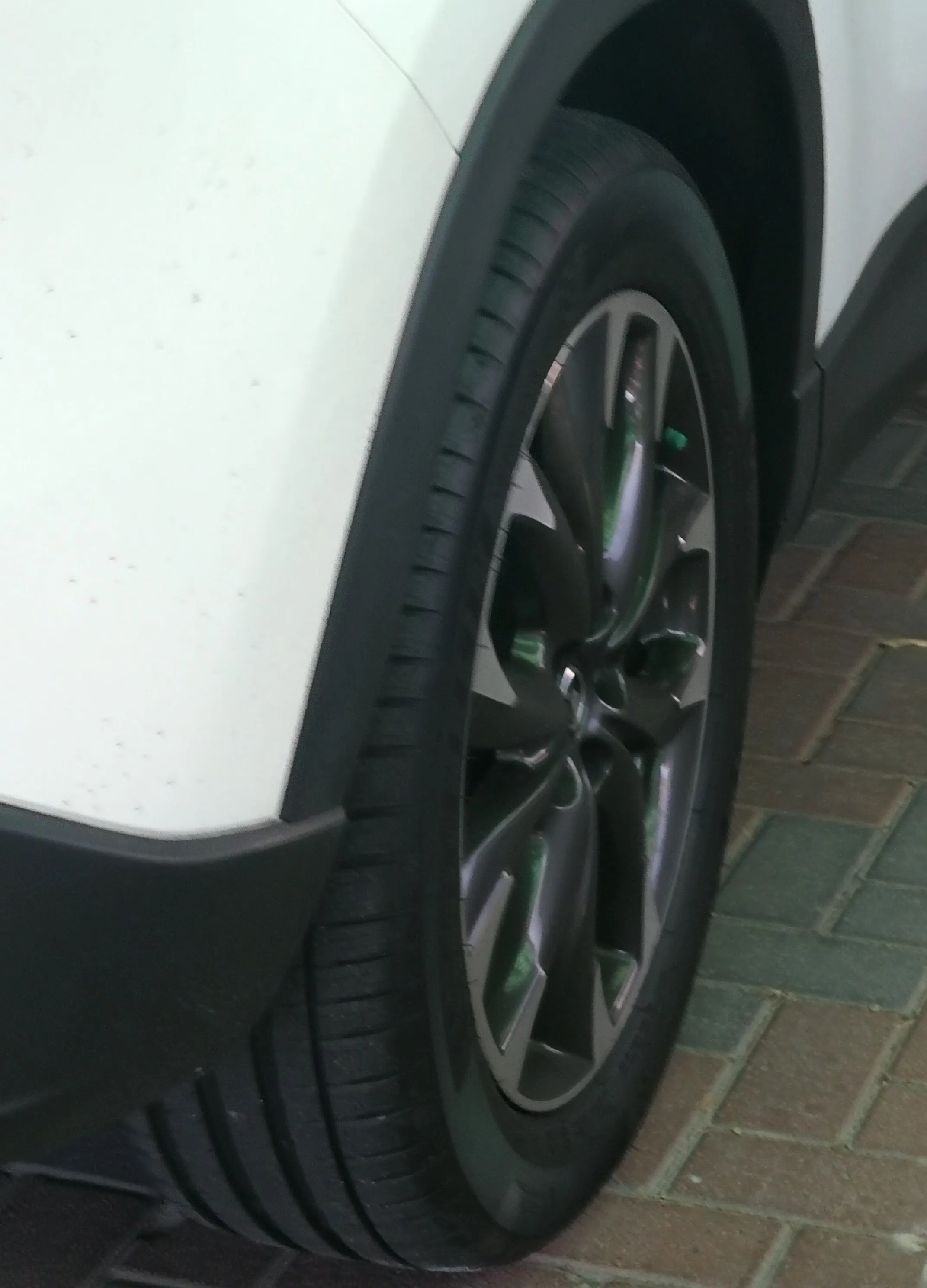

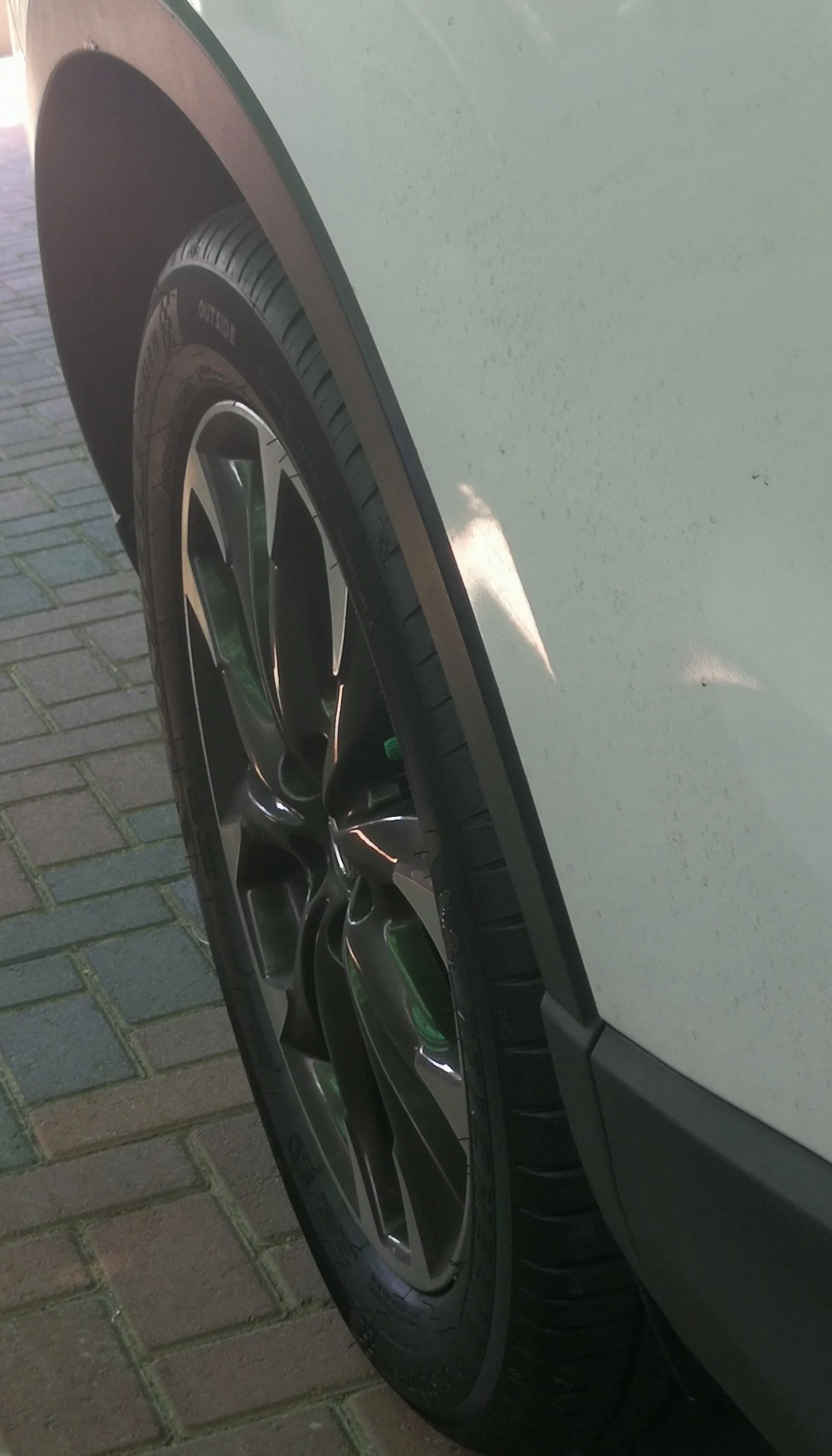

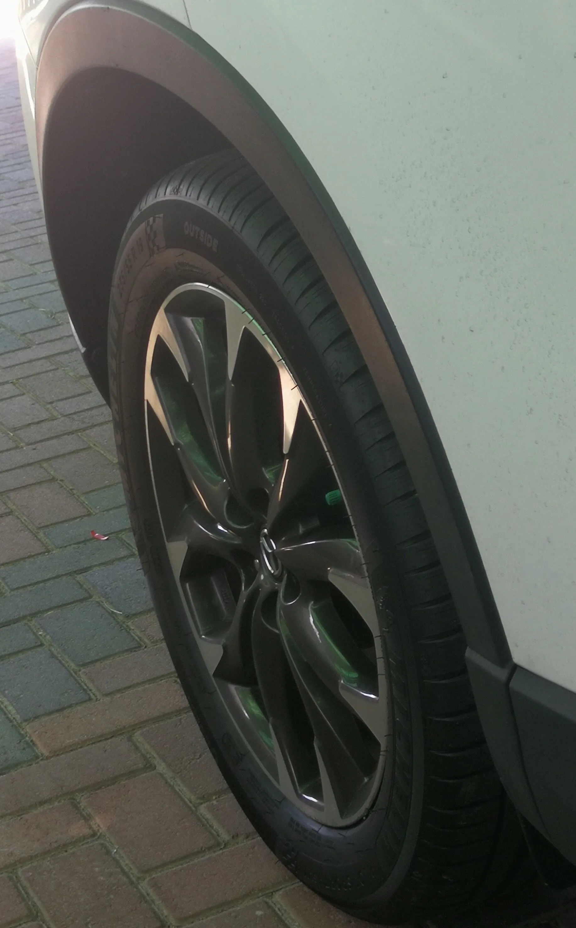

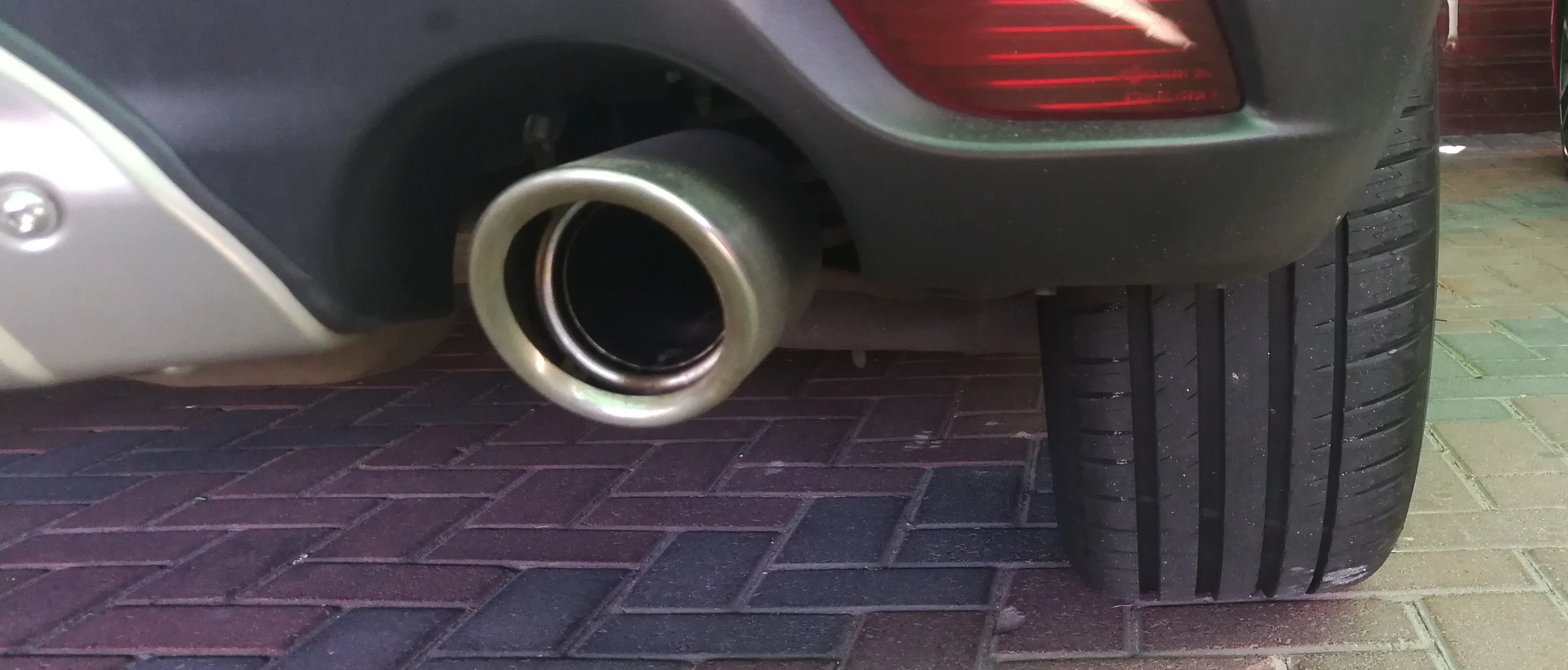

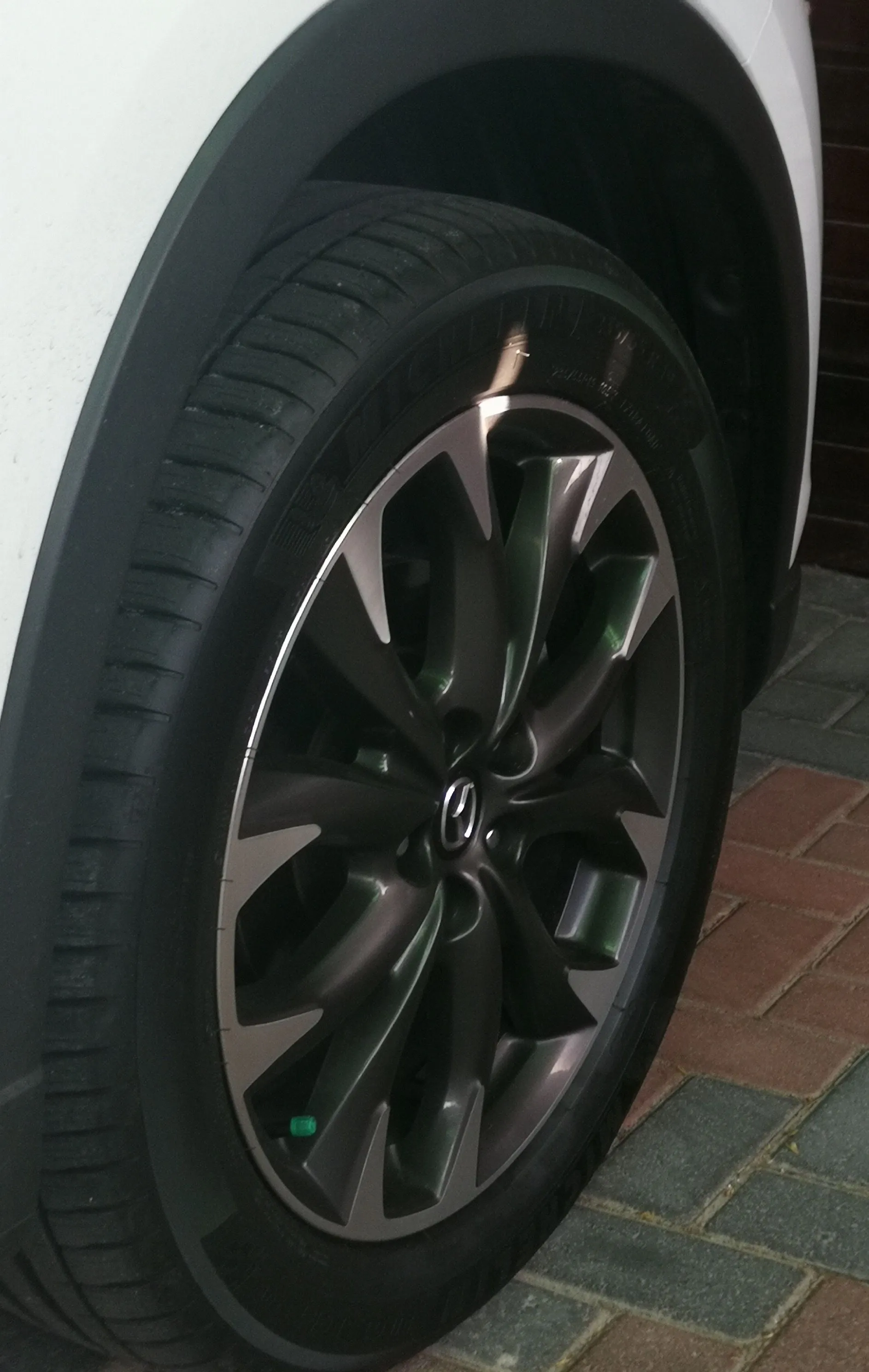

So I finally replaced my old R36 225/55/19 to 23/55/19. Could not get the 245/50/19 and went for 235 size. Bit disappointed as it did not give me the stance I wanted, but looking at using spacers now.
I must say the car feels more stuck on the road and control is so much better at faster speeds. Car feels also a bit more sluggish, but did not notice any difference in mileage use tbh.
Was so much worried about any issues that would happen with the tyre change, but so far so good.

I took a ruler and a tape measure and measure how far the tyre are from the outside arch. Front it's 20mm and rear 15mm. I am thinking of going 15mm in front and 20mm in the rear.
What do you guys think. Will this have any effect since I moved to 235/55/19 and also since I have a automatic diesel awd. Also since the spacers are different sizes rear and front.

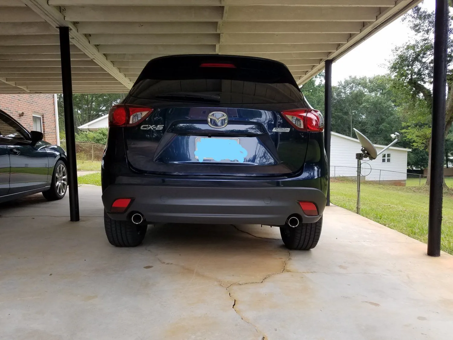

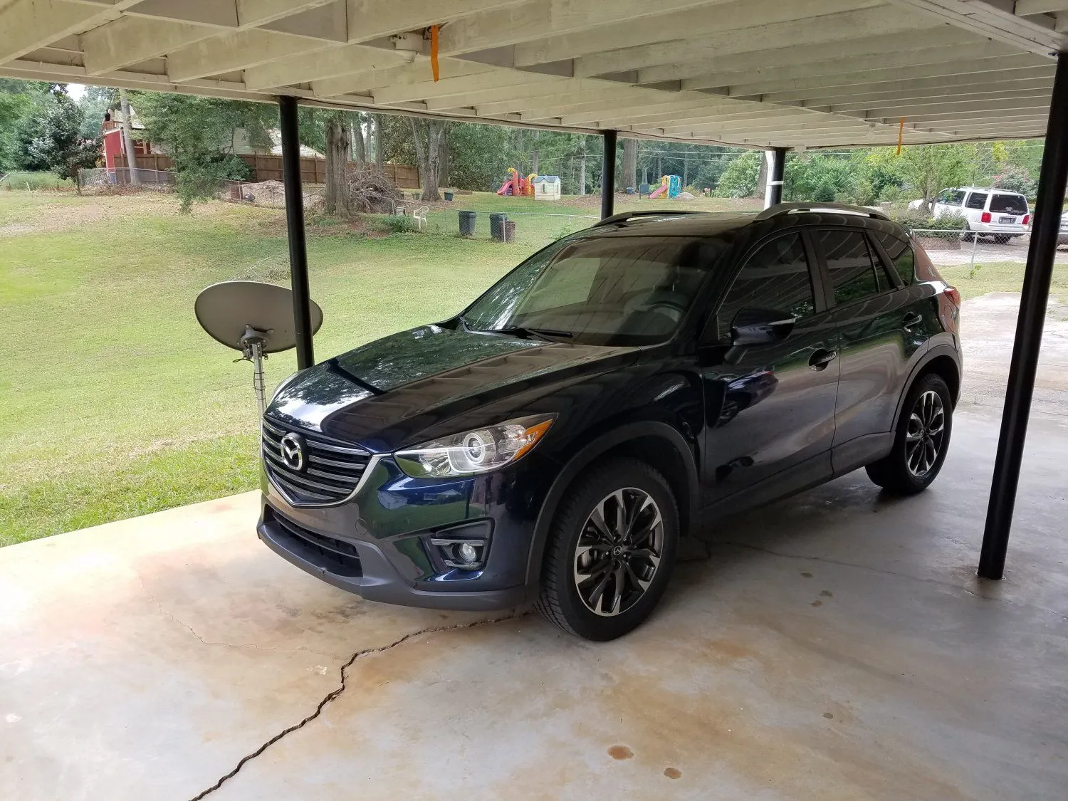

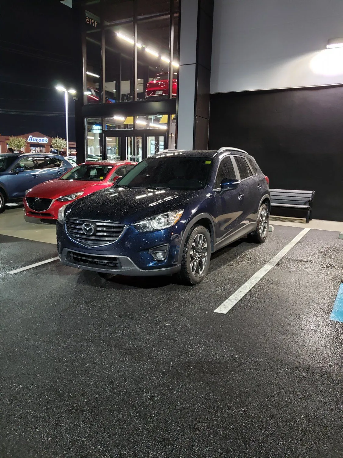

You could have actually went 255-50-19. I ran Michelin Defenders for well over 40,000 miles and never had any issues. I ran 36 PSI and had even wear. I wish I would have taken more pictures but I traded her in on a 19 GTR, (which will need tires soon).

Spacers are a REALLY bad idea. They can increase the stress on the wheel lugs. They are/were banned by some racing leagues for that reason.
Correction -- cheap / poorly made spacers are a bad idea. Spacers in context of the CX-5 will add nominal additional risk and are just an idea that needs evaluation and not as simple as "NO you will die!" Of course racing leagues have rules / guidelines (like helmets and roll cages) doesn't mean it applies to street usage. Of course adding a roll cage and helmet to your safety equipment in a CX-5 may yield additional survival rate in extreme crashes.
Use a quality wheel spacer (not an Ebay / Amazon generic), follow the install (torque) guidelines and you and your family will survive the daily commute and the cross country trips just fine.
