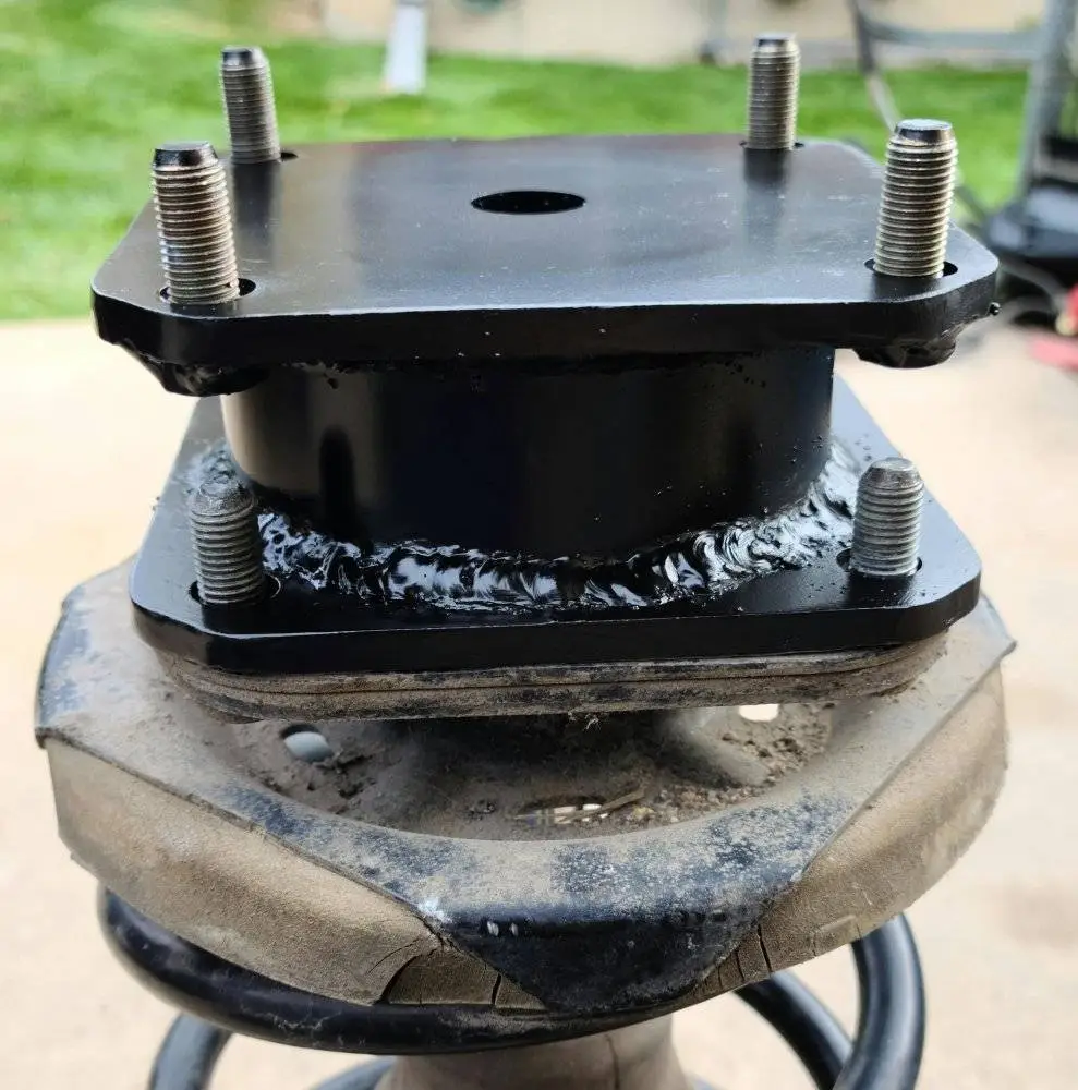

Anyone have helpful tips on *lifting* ? Like 2 inches? There is a user I found on reddit that's done it. He made his own strut mount extension/brackets to raise it by 2 inchs:
Amazong
This is a suuuuuuper old thread but I'm the person that made the Protege lift kit. Since then I've actually gone public and am currently working on my first 1" lift kit for a customer/product tester. I'll be fully selling them on our site soon if you wanna check it out. www.akelyteinnovations.com
