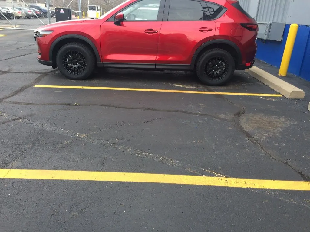

Now for the reveal. I have aftermarket 17" wheels that wear Nokian hakkapeliitta R2 225/65 R17 SUV
attachment.php
