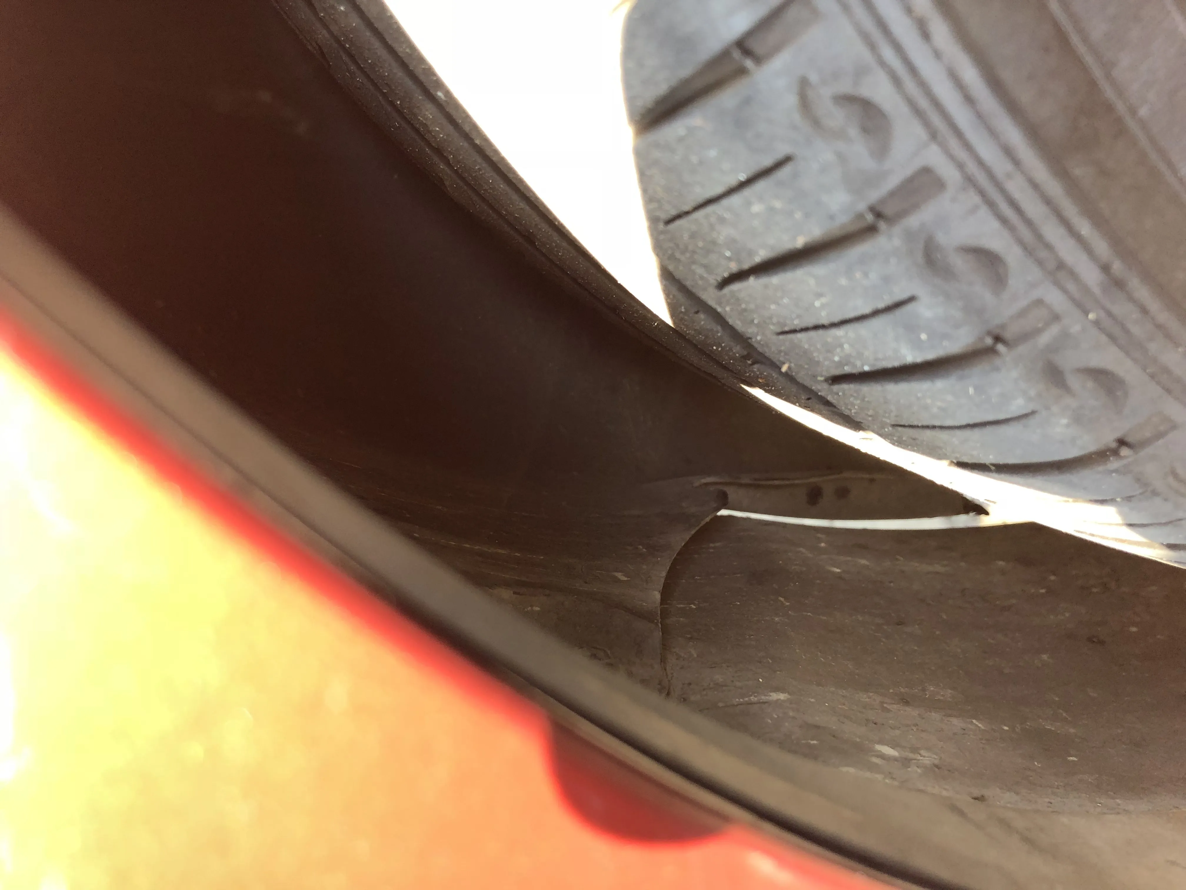

Wife got rear ended at stop light last week. Bumpers scratches
Since then there is a clunk on the rear right side. I can hear it over bumps and uneven pavement. Any thoughts on what could be? What are things I should go under and check ?

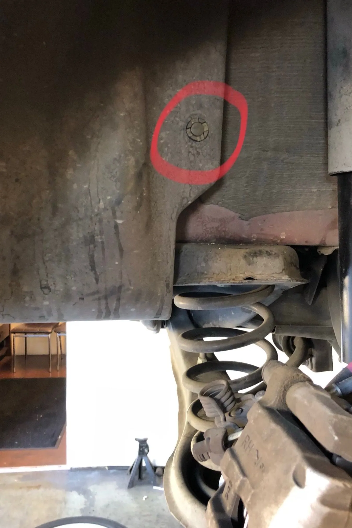

E6D15F25-4EA0-449B-A5DA-0CC127B643B4.jpegE6D15F25-4EA0-449B-A5DA-0CC127B643B4.jpegEverything is tight
This rear plastic panel is loose and is hitting
I believe this is culprit
Can I remove it for good?
Well fixed the plug on the rear tab. But the clunk is still there.
