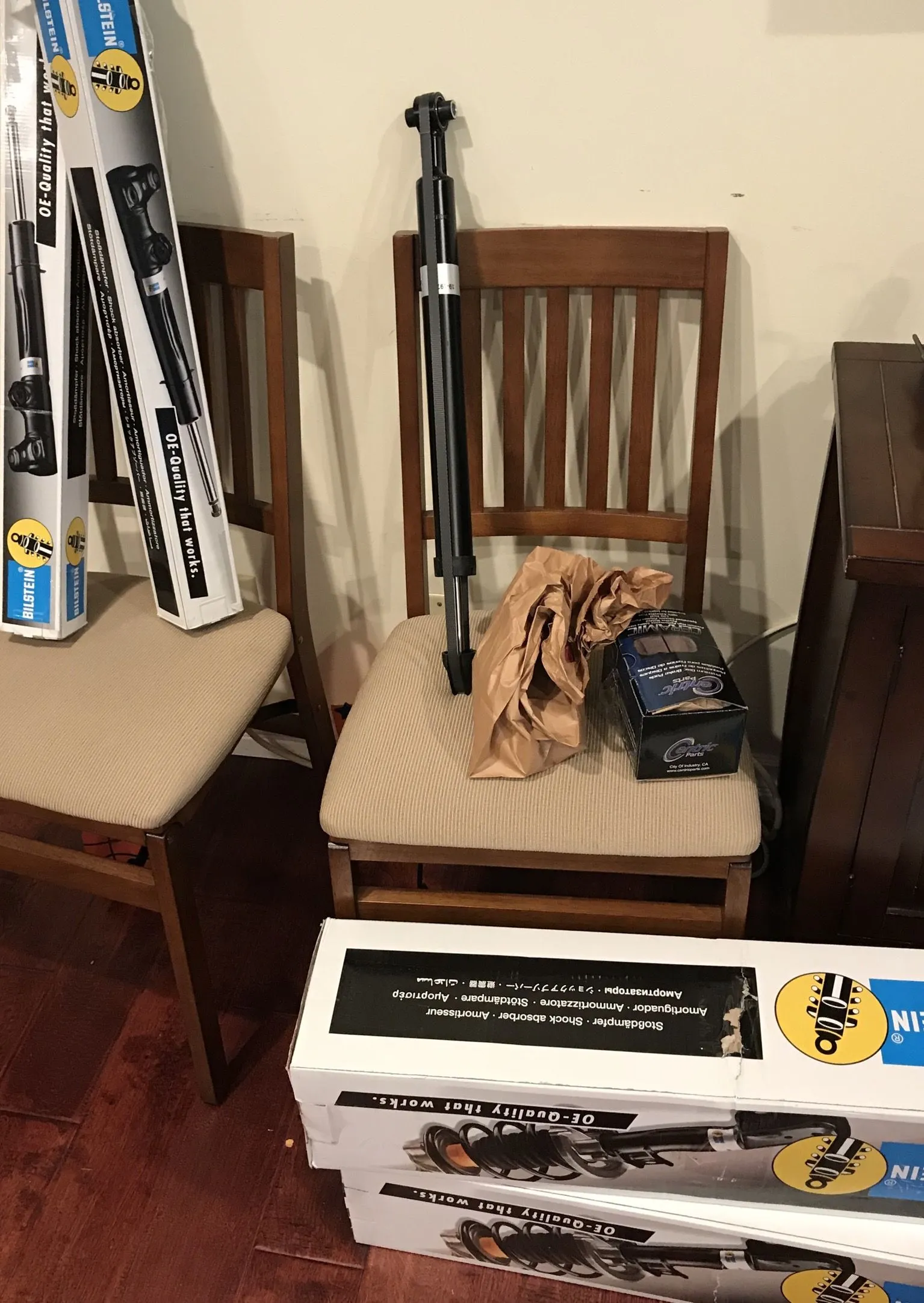

41F76795-3AD9-40CA-9343-7CA1F5F95093.jpegThanks
Front ones and pads just came
Nice. I believe you are the first posted B4 user on the Mz5. Can you do something for the greater good (and yourself too)? Take some basic measurement of 1) total length uncompressed and 2) push position down all the way and measure length again (the difference will give you piston travel). It helps to turn it upside down to compress it bc you have more leverage against the base instead piston tip/mount. Thanks in advance.
Are B4 no good ?
I will install on the 18th weekend so I still have some time
Others must be installing it as a bunch of site keeps running out of the left front shock
I had to order it from somewhere else
I will try to get measurement as you asked mid next week
Are B4 no good ?
Interesting how you came to that conclusion. But the reason is they never offered the B4 (or anything) for the Mz5 till some point within this year. IIRC, their air suspension is built on the base of B4.
I can't tell from the pic but does it have country of origin/mfg? I faintly see 'Germany' but not sure if that's a generic reference to their HQ or mfg. Nonetheless, that look like it is well built. Finishing look nice and the welds are clean. I will be 2nd online to get these when I'm ready to replace mine.
Oh I must have read your post wrong
I thought you were suggesting b4 is no good
Says made in Germany
