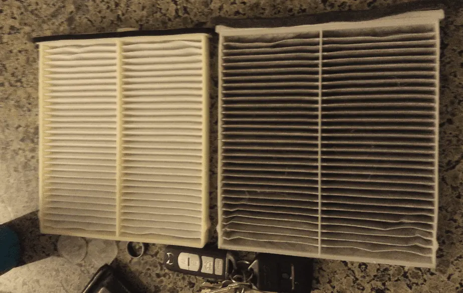

Cabin Filter after 3 months. New cheapo $5 filter next to it. Whats cool is the cheapo filter has sturdier plastic and crispier/thicker paper element than the OEM filter.
If the dirty cabin filter to the right is not your OEM charcoal cabin filter from factory, yeah it's worth a new $5 replacement. Where did you get that cheapo $5 cabin filter?
Here are different OEM cabin filters available, and don't throw your factory charcoal cabin filter away too early just because it looks "dirty"!
Went to Mazda dealer yesterday and took more pictures on 2016.5 CX-5's new charcoal cabin filter from factory, Mazda genuine non-charcoal cabin filter with P/N KD45-61-J6X, and Mazda Value Products non-charcoal cabin filter with P/N KD45-61-J6X-MV. From the comparison picture below we can see the picture you posted earlier is Value Products with white plastic frame instead of black. Value Products cabin filter is about $10 cheaper than Mazda Genuine Parts on list price.
The dirty one pictured, it was originally a clean white filter sourced from Parts Plus for $7-9 or so. That picture was after I tapped the dirt and leaves off and vacuum brushed it. If needing a newer filter right away at a cheap cost away I recommend their filters. Nothing against OEM filters, I just can't afford them at the rate I'm changing them.
I experimented with the $5 dollar made in China filter (I suspect all Asian Car filters are made in China?) via ebay. It was actually $4.xx cents but ehh round up to $5. I figured what do I have to lose but $5. Takes a while to get to your home hence another reason to order in bulk. Thoroughly surprised. Pros: fits, works, cheap. Cons: not charcoal.
