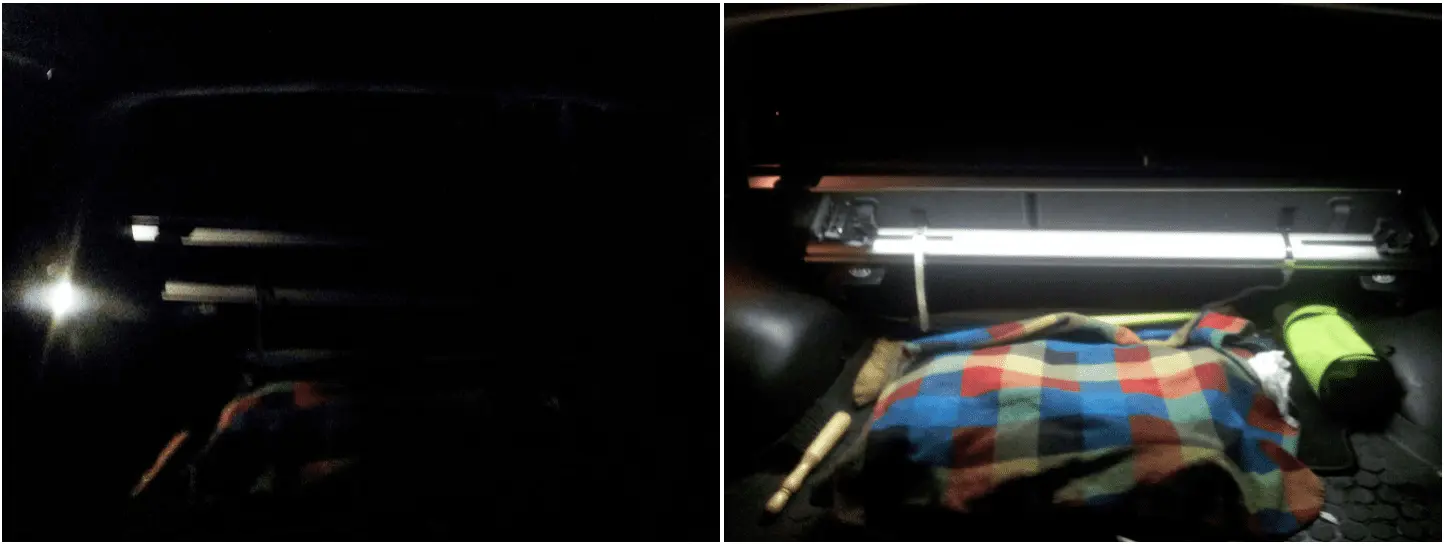

I made the light ledbar under the bar of the trunk cover by making connections in the bar and the holder on the left site..

In another car I had, I used a 6" (white) cold cathode light tube (CCLT), like the kind that are used in computer towers, tucked under the shelf that held the hard hatch cover. I think the site was elwirepros under their "Automotive and Motorcycle Kits".
In hindsight, I should have either gone with the dual 6" or single 12" for better illumination.
