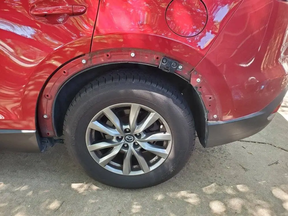

About a week ago while driving at freeway speed, with no obstruction in the road, nor collision with any type of debris, structure or other vehicle, my passenger side - rear wheel well trim became detached. It just, simply came off without warning!!!
I brought it to a local dealer (Munday Mazda), and they were gracious enough to replace it under warranty.
They alleged that they had never heard of anything like this happening before. However, my friend's neighbor reported an identical scenario. Apparently, she found it more difficult to convince her dealership (Clear Lake). Eventually, though, I was told they conceded, and fixed her vehicle too.
Has anything like this happened to anyone else? What was your experience?

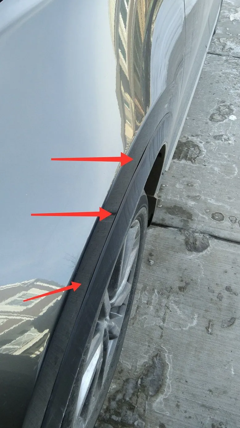

A few days ago, I noticed that my front two fender liner/guards started to either deform or begin to come loose. There are visible gaps that most would not notice, but when comparing to a brand new CX-9 on the dealer lot, the issue is clear. Immediately up front, the dealer agreed that this wasn't normal and ordered the parts to replace it.
There are only a couple of things I can think of. Either the dealership that did my first oil change somehow messed with the fender guards (unlikely since you don't need to touch those to do the oil change), or the guards somehow warped or came loose due to the change in weather. Anyway, parts have been ordered and will be installed as soon as they come in.
Here are pics of the gaps (same on both sides). The rears do not have this issue.

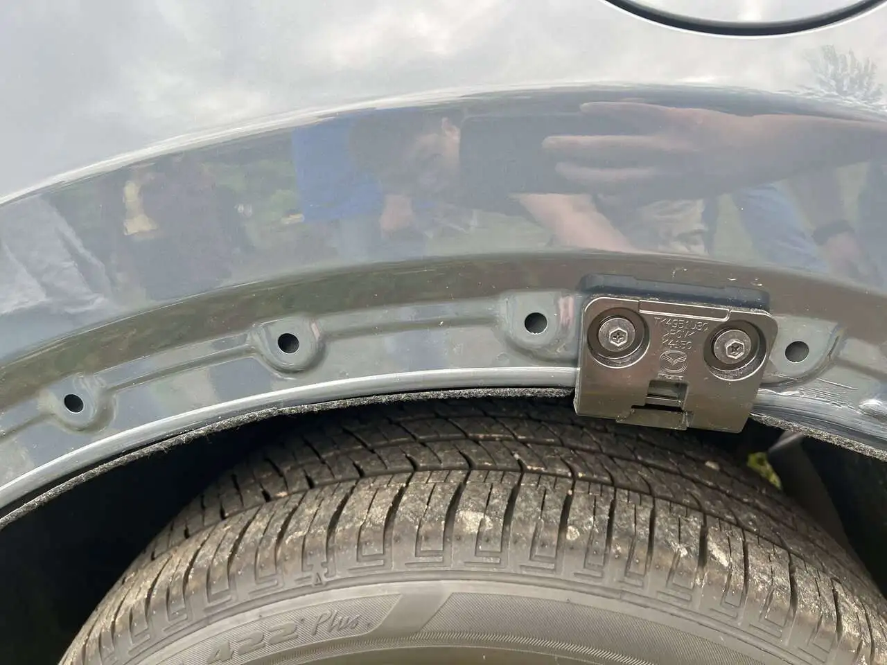

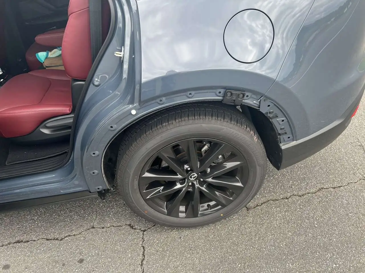

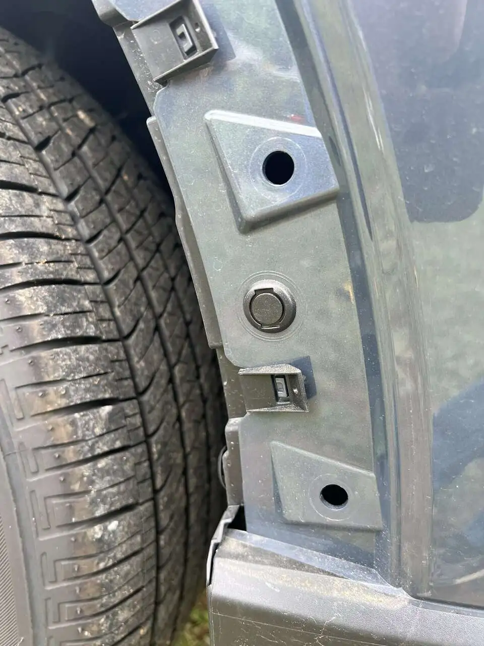

Wife just purchased a 2022 CX-9 Carbon edition. Only a week of driving and while on the highway, 90mph, out of nowhere the driver rear fender flew off. Nothing in the road, didn’t hit anything, just bam. Wasn’t sure what happened at first until I pulled over to find the fender missing. Here is the thing. See the photos. It looks like only three fasteners we’re holding it in place. One fastener staid and only two of the holes have circle markings where fasteners were.
Stealership said they will take care of it but blamed me for hitting something. Say they see it all the time and it’s always someone hit something. That tells me this is a common issue but they don’t want to accept responsibility.

Yeah. Amazing they use that line. Looks pretty clean to me. If hitting something at highway speed, as it slid along the car as it was a being pressed against the car, it would have left some damage to the paint. That thing plumb just fell off.
Trust me, I know I didn’t hit anything. I drive slammed modified cars so it’s habit to watch the road ahead of me. Waze had tire debris in the other lane I passed miles prior. Service guy said, without even looking, you hit something, I see this all the time in my 20 years of working. I got so heated. You can see most of the holes never had retainers.
Check this video out from the dealership service department. https://tvidnow.com/73v5dqw This is crazy as you can clearly see the holes that have markings that had retainers which is only 3 out of the 12 holes! Yes, it would have held in place just fine had it NOT been missing the majority of its retainer clips.
