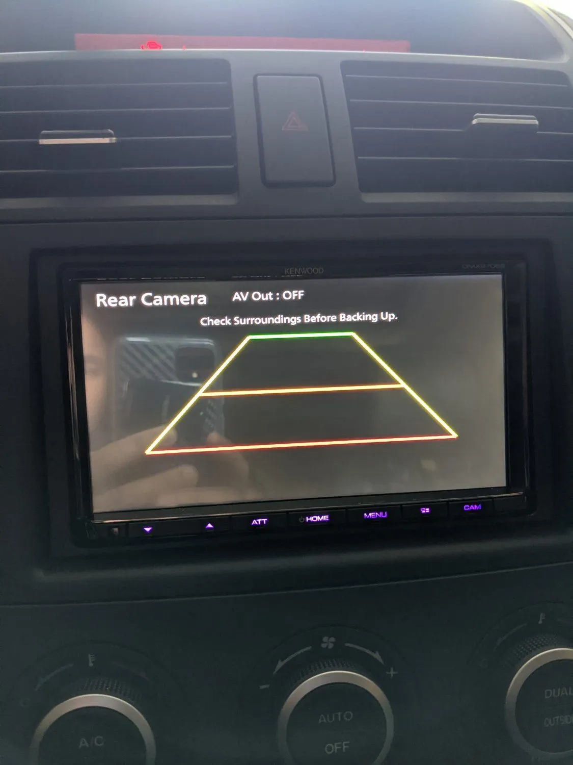

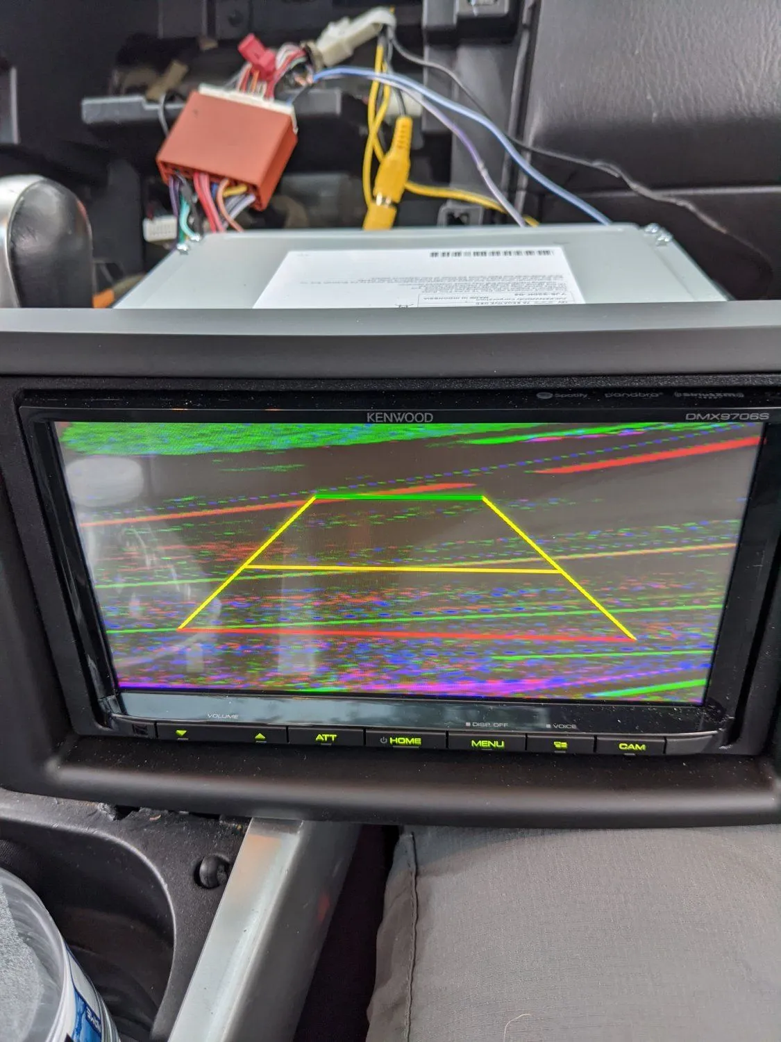

@Iristyle I think i had the same problem with you. I tested my reverse wire and it is giving me 10.8 volts. My camera has no signal sometimes wobly video feed. Is it possible that it doesn't have enough power? I am also using ax mazcam 6v
This is what’s happening when I put the car in reverse. Either I get a blank screen or a wobly video feed.

Ive tried reversing the polariy (no picture), confirmed 6V (I had to purchase a step down) and all I'm getting are crazy rolling messy pictures with 99% noise. (tried ntsc and pal). I've tried connecting straight to a standalone screen and same issue?? do they have their own standard or something? just noticed - mines the same as the second picture above. bjmigrino - did you ever get it working properly?

theres 4 wires in the harness, but to be honest I dont get how it would even work in reverse. as far as I can tell it would be video, shield, power, ground. maybe in my case the shield and video are reversed in the harness. Ive rage quit for the day, dash is in pieces LOL. I may have to revert to taking the rear skin off the door and try and mount the after market camera. I really really dont want to go running a new cable from the front to the back though!
The camera powers on when in reverse right? So you're ok with the reverse signal. I know! I even bought another mazcam coz i messed the first one. Try interchanging the 4 wires. That's what I did before until i read the solution in the thread. I changed the polarity in my stock reverse camera not in the mazcam. Maybe that will help.
wait - you took the skin off in the tailgate and changed the polarity there? I tried taking the skin off (top section first, but I broke a clip or 2). not keen on ripping the whole skin off, but I have no choice anyway - if I end up installing the aftermarket camera
awwww man i just realised all this time that you were talking about camera polarity! i thought you meant power which is why i couldnt understand how it still powered up for you. the shield and signal makes sense - im looking at a residual weak shielded signal! will try tomorrow - im confident it will work - cheers!
Thanks mate! It worked a treat. I had swapped the polarity on the video feed and heatshrinked it to cover up my really bad soldering. (That was the whole point of why I went a premade harness). now to leave the supplier a review ;)
