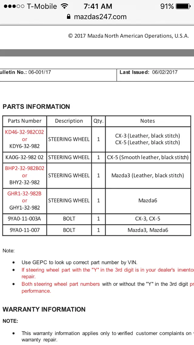

Although your 2016 CX-5 is a CPO it should be still covered under 3-year/36-month new-car warranty. You should demand your Mazda dealer replacing your leather-peeling steering wheel under TSB 06-001/17 - LEATHER STEERING WHEEL SURFACE WEAR / PEEL. The only problem is according to TSB there're 3 part numbers for CX-5 black-leather steering wheel: KD46-32-982C02 or KDY6-32-982 (Leather, black stitch) and KA0G-32-982 02 (Smooth leather, black stitch), and it's hard to tell which one would last longer. Since your dealer most likely is going to special order it, ask them to order KD46-32-982C02 if I were you as it seems to be the latest revision and the leather should come with more textured feeling and "rough" like the one jhu8 got.

I had a smooth shiny leather steering wheel on my 2012 model and it was full of bubbles, had it replaced today with the KDY6-32-982 which looks like a fake leather, hopefully it’s a superseded better one.
