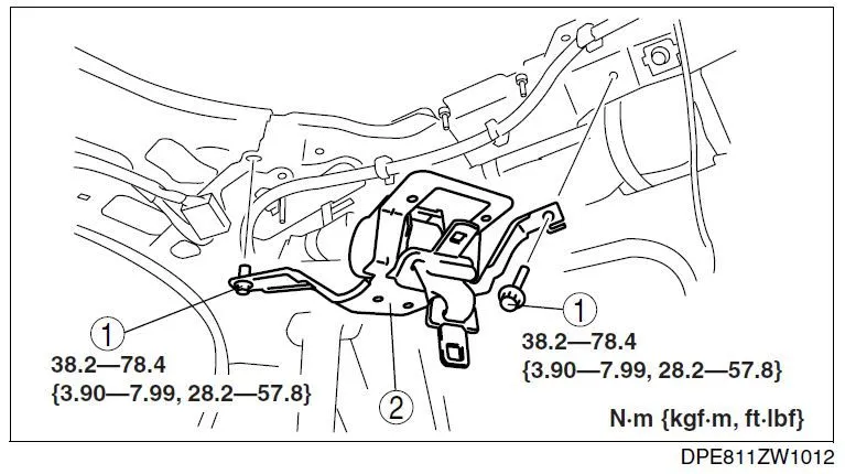

My middle row center seat should be arriving sometime in this month or next from japan.. this is the karakuri middle row, center seat thats not available in the US.. anyways.. im thinking up ways bolt up a seat belt system so it would work safely... has anyone ever removed their headliner and have taken a picture of the underside bare roof... are there any factory mounting holes for a roof mounted seatbelt assembly... (JDM / EDM)...
i would prefer to set up a 3 point seatbelt system for the center seat.. but if its too difficult. i may just settle with a 2 point lap belt.
This is the picture from the Workshop Manual:
I guess that there are mounting point in the car frame, but you need an additional frame to mount the seat belt retractor.
I have the European version with the center seat and there's quite a large bump in the left hand side ceiling that covers the seat belt retractor.
If your ceiling does not have such a bump, I guess you will have a hard time properly mounting a seat belt.
BTW: My car originally did not have the third row, but I installed one myself afterwards. All mounting points were there. Even the holes in the pillar that the seat belts go through were already there. (Only they had covers with no gap for the seat belt, so I had to replace the covers)
Great.. thank you.. I was hoping the mounts would be there.. now to source put the seatbelt assembly... perhaps I'll just cut the headliner and retrofit a universal seatbelt cover
