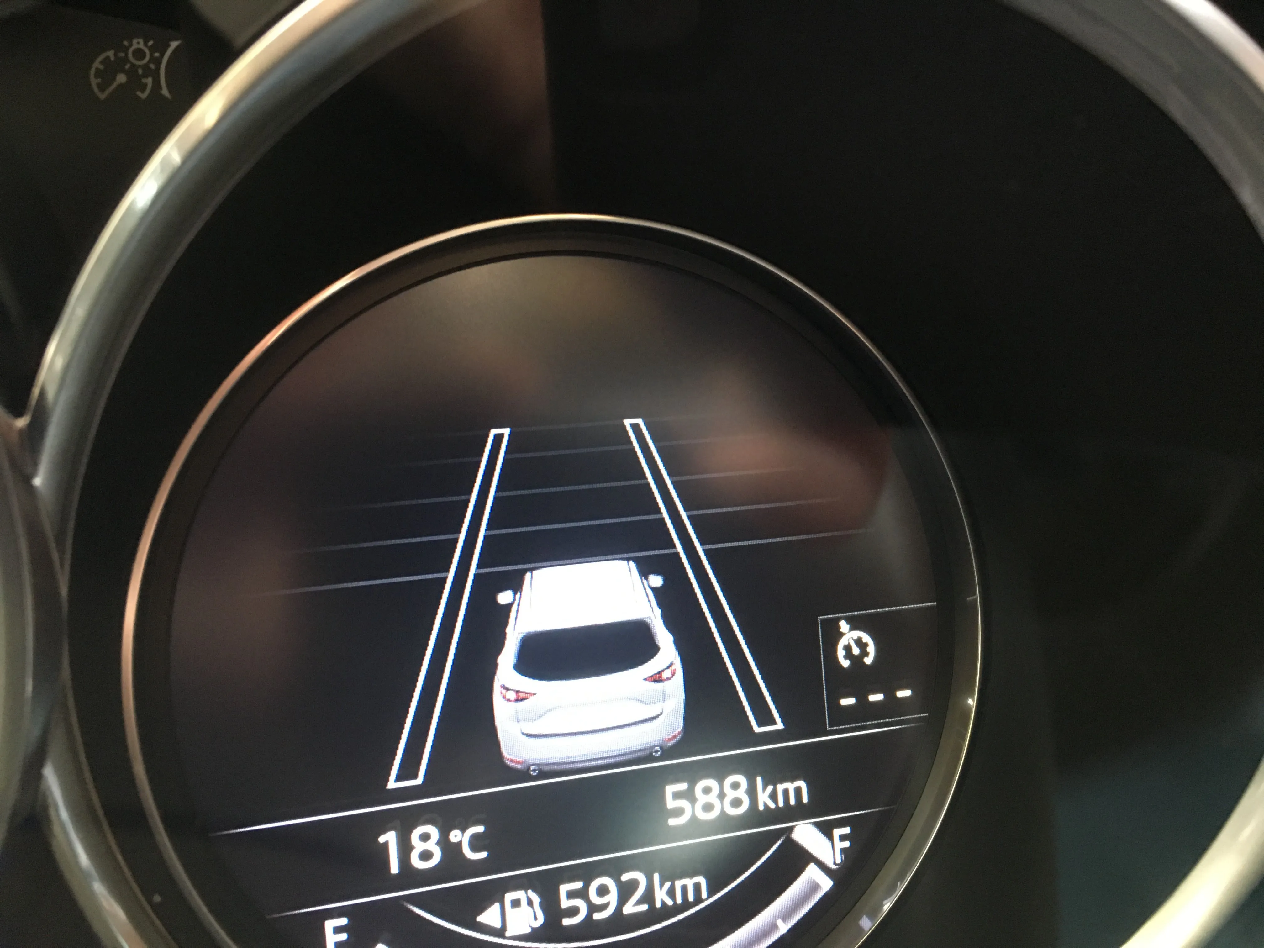

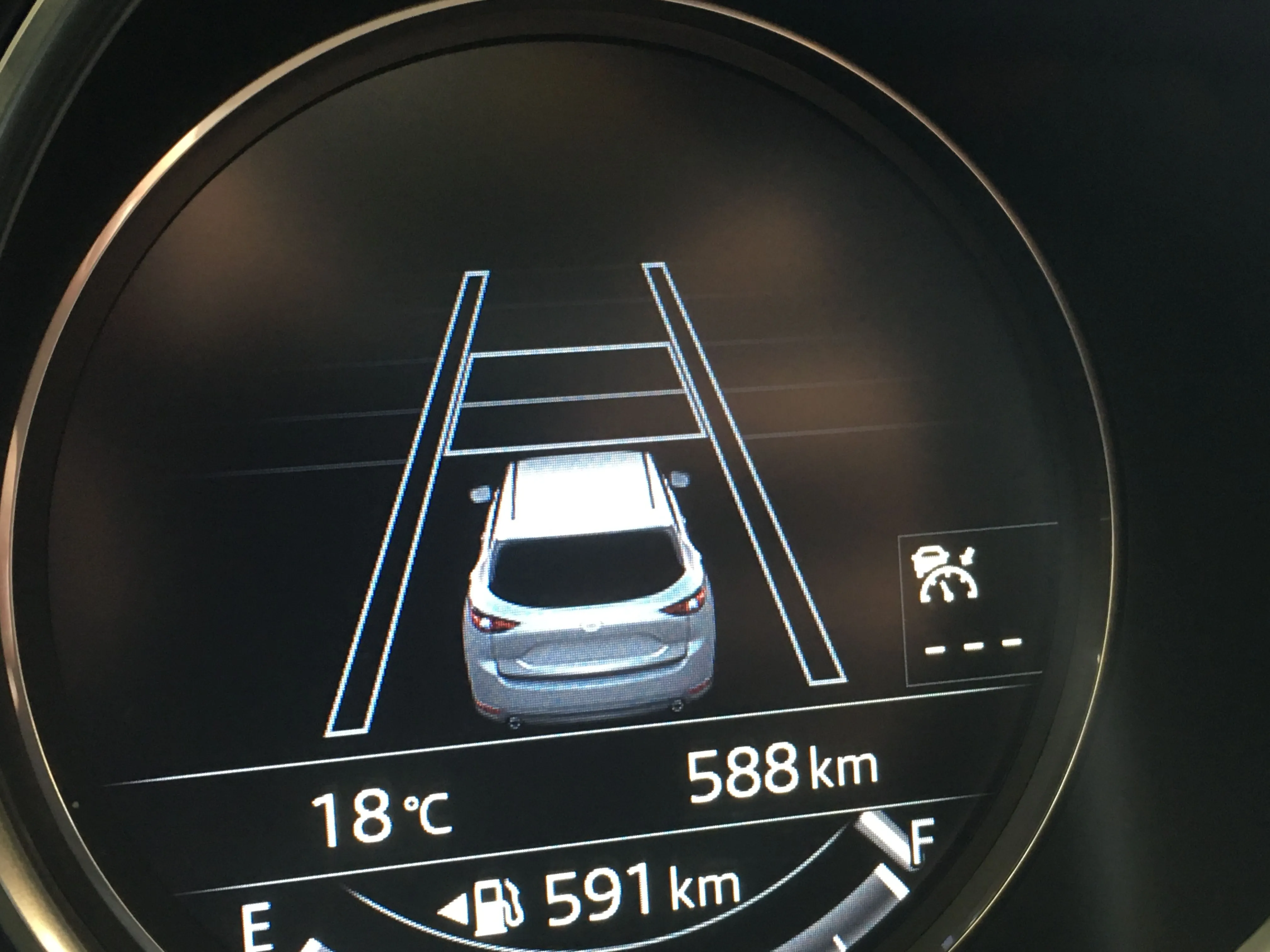

Adaptive cruise control : small picture of a car left up corner of cruise control icon + distance adjustment underline
Regular cruise control : just regular icon cruise control without picture of car

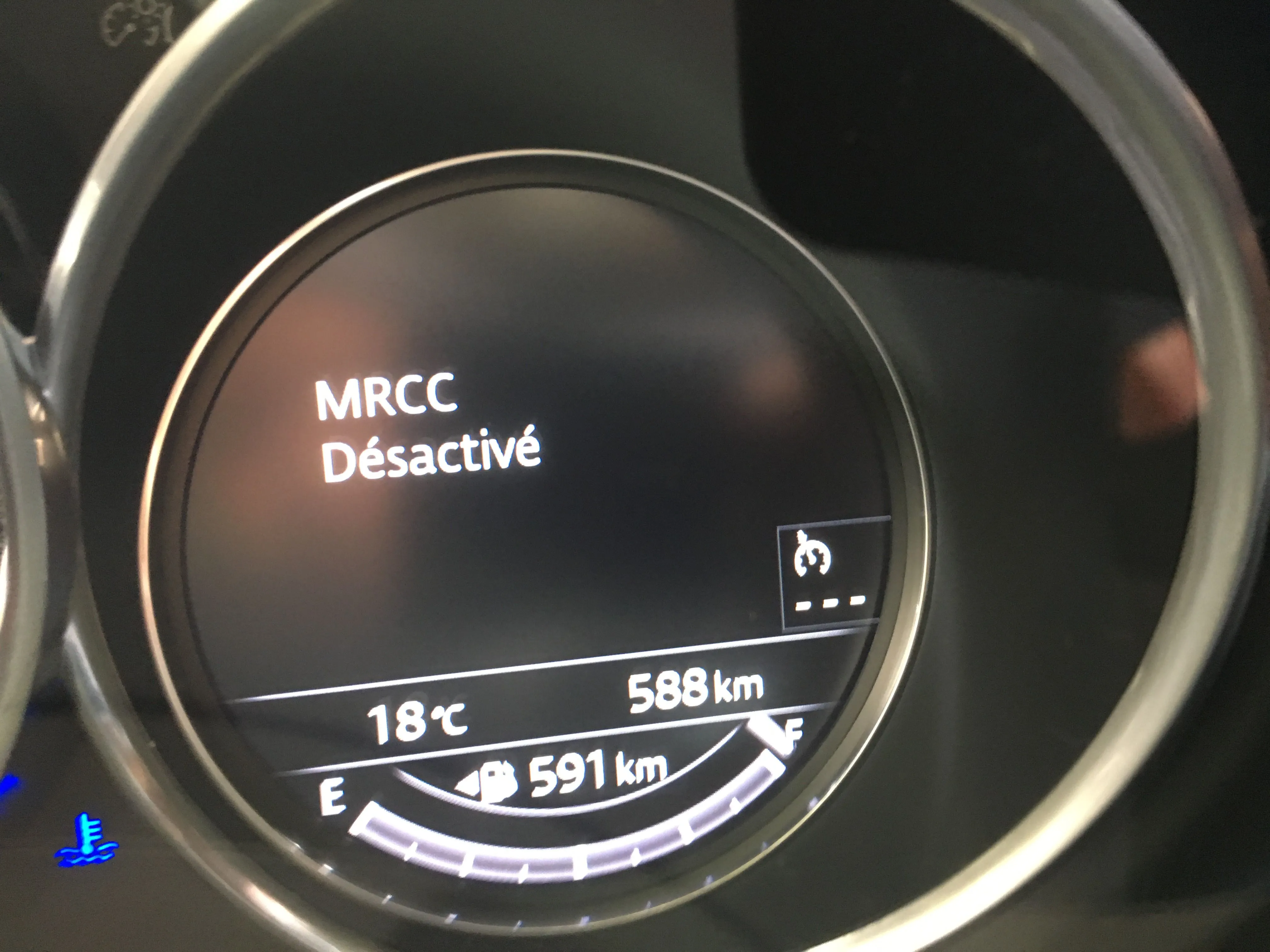

And when you hold "mode" button to pass from adaptive to regular you have a message "MRCC canceled" on info screen
I tried to insert picture of description upper but I don't know how to insert a picture on a post. It seems need to create URL.
Adaptive :
Message after hold "mode"button :
Regular :
