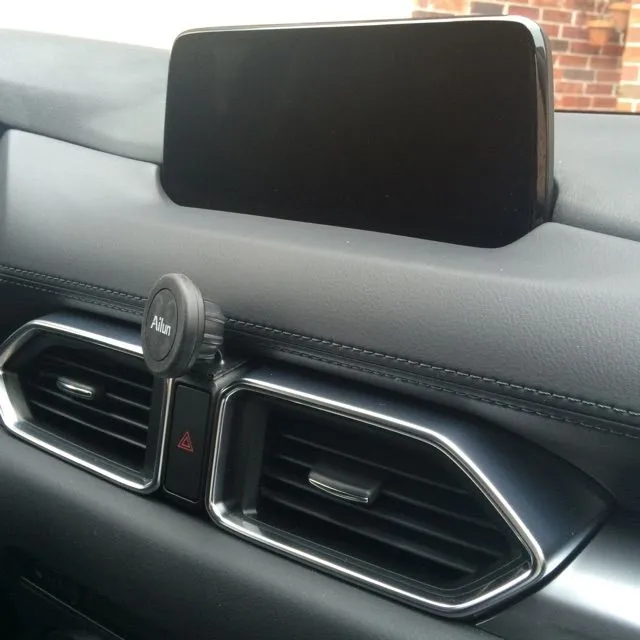

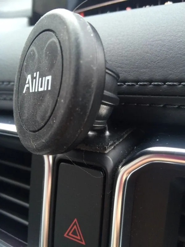

Update: Using https://www.amazon.com/dp/ (commissions earned) now and working really well.
Modified the mount by cutting off the 'top' portion as defined by the upper groove in the product image, which allows it fit really well above the hazard-lights switch. It's actually sort of cantilevered in there so very secure. Didn't want to put anything adhesive on the padded dash material, but figured it was OK on the hard plastic where it is now.
Looks perfect, really secure. Thanks for posting.

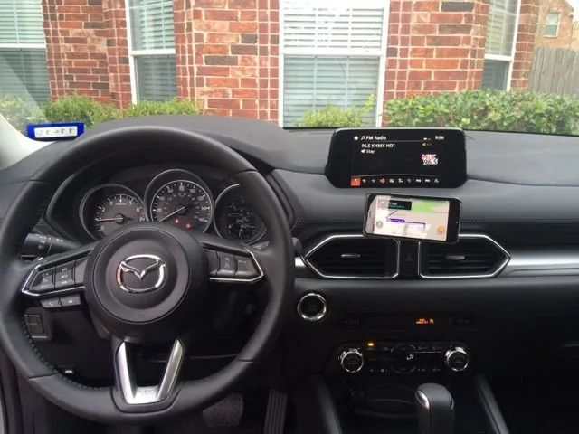

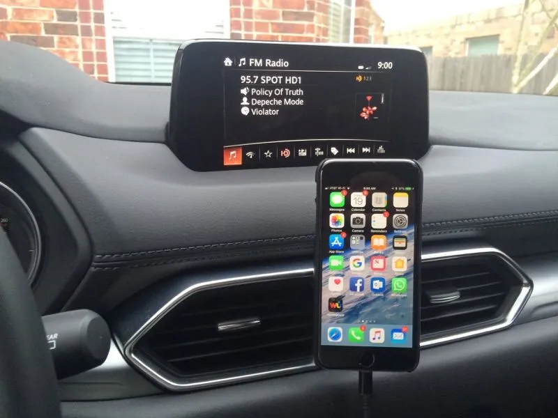

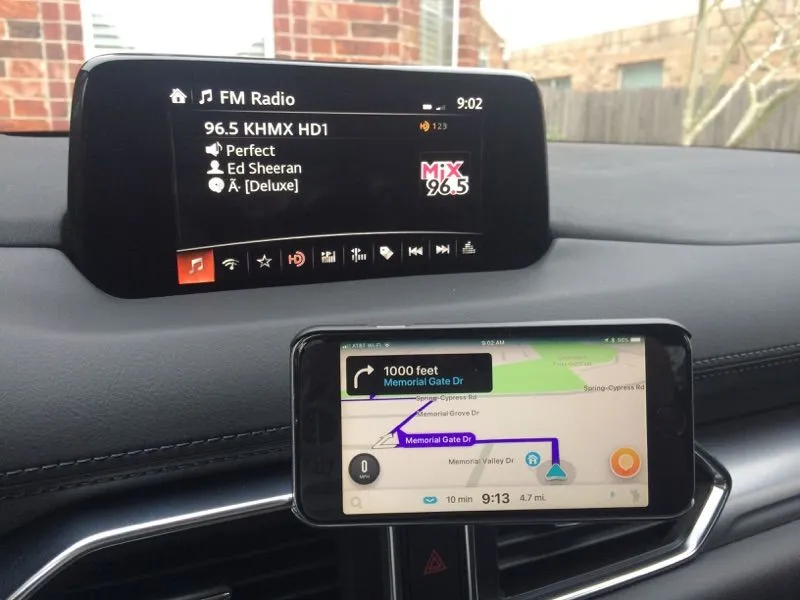

^^ This! Exact same setup I have, has been going on for ~1 month now (my CX-5 is 5 weeks old).
Magnetic holder base is made of plastic and was wider & deeper than hazard button housing, hence trimmed sides & front so doesn't extend beyond housing. Cut finish shows a bit hence tinkering with the idea of replacing with another base, however the smallest metal one I've found (LILER Mini Universal in AMZN) is 1"diameter, while housing seems to be ~0.75" wide
  • Magnetic base close-up, passenger view CX-5 magnetic base close-up passenger lores.jpg
  • Smartphone vertical w power cable, driver view CX-5 iPhone vertical driver lores.jpg
  • Smartphone vertical & cluster, driver viewCX-5 CX-5 both landscape cluster view driver lores.jpg

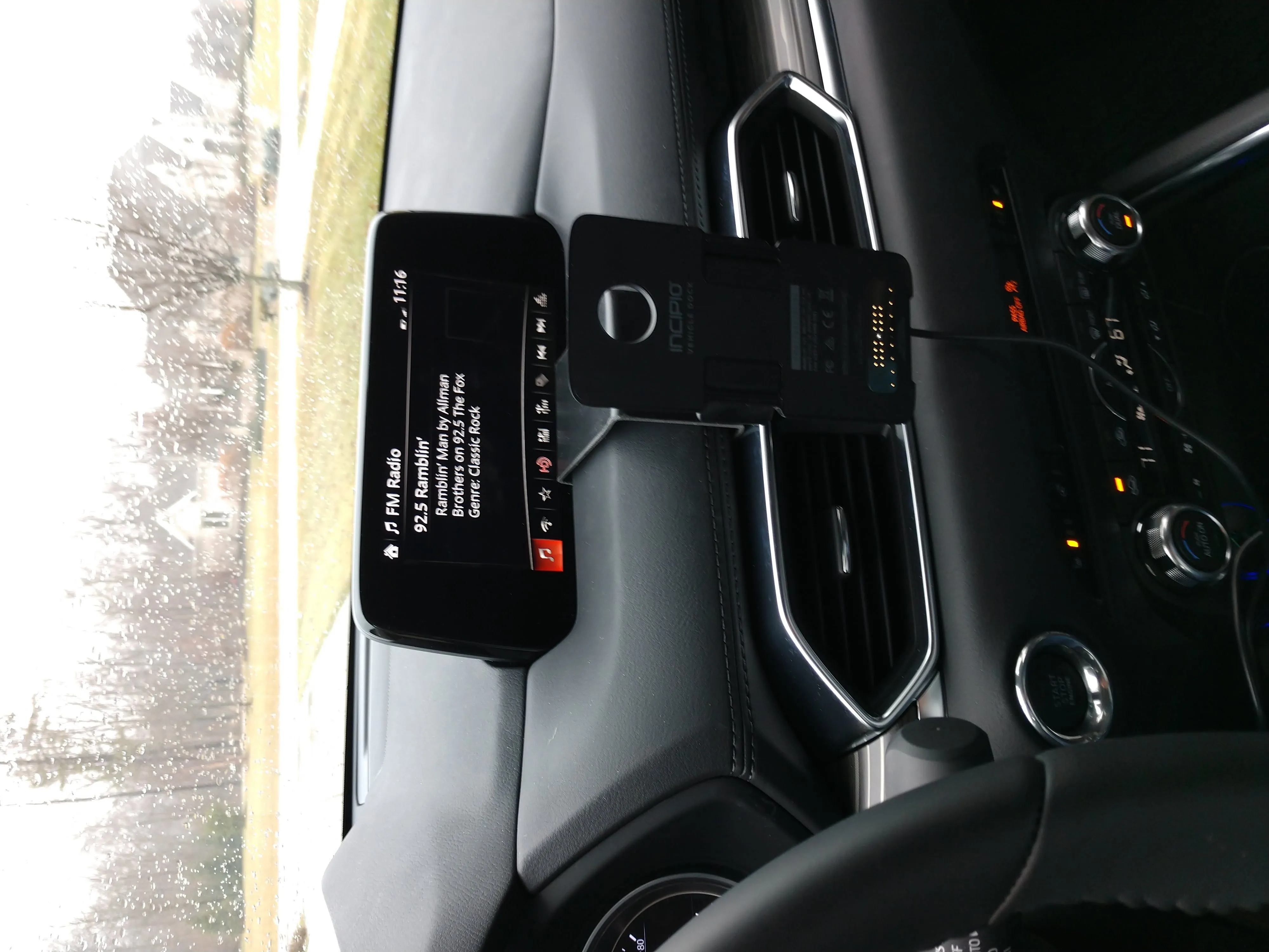

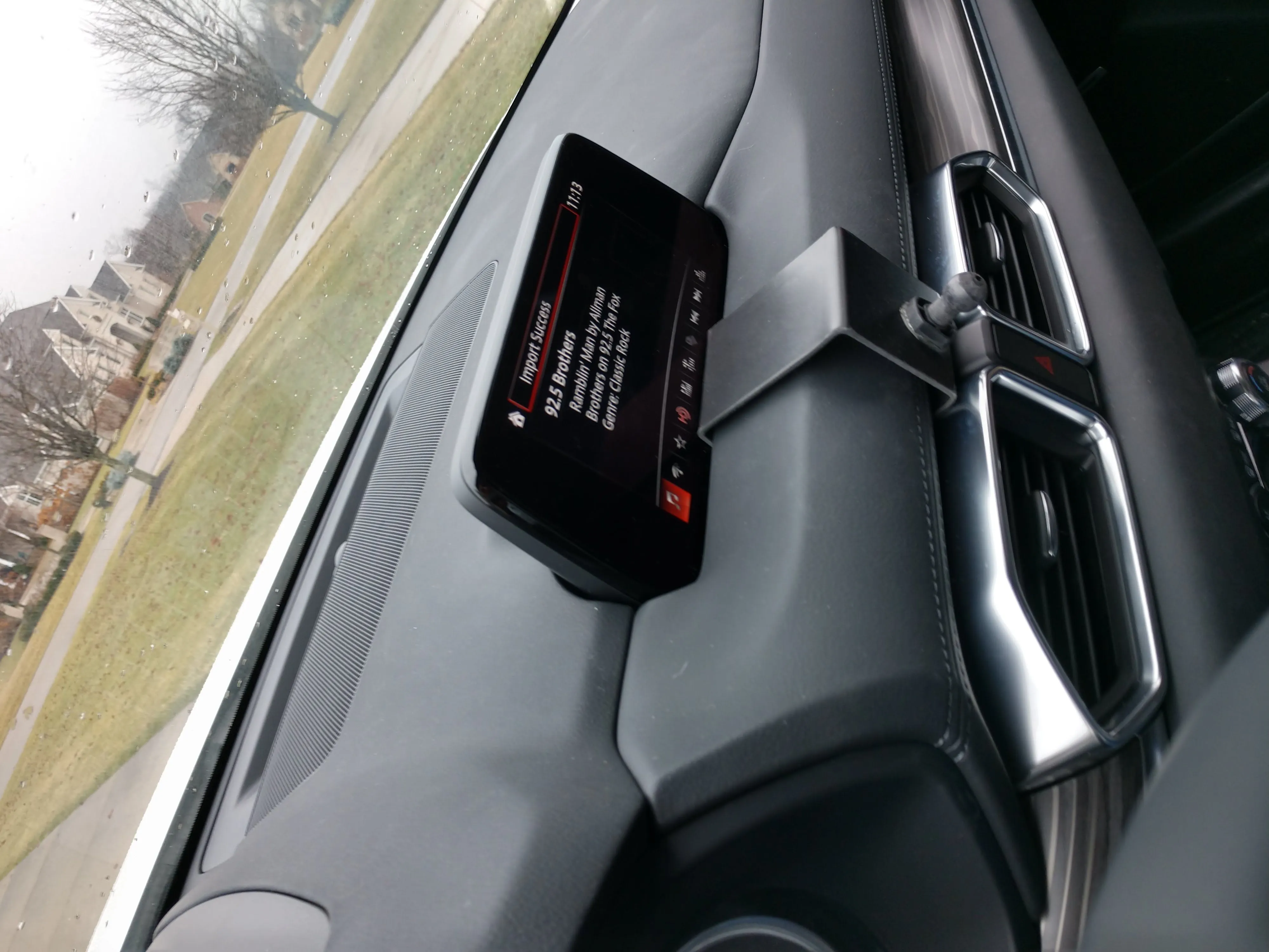

I like Google maps and integrated traffic better when I have to get somewhere on time. My phone also has a dock that charges it - i don't have to mess with a plug. So therefore i like to mount phone. I made myself a mount by thermoforming some black pvc sheet:
attachment.php
attachment.php
No tape or adhesive required.

That's pretty slick!
What kind of rig do you have to do the thermoforming?
Heat gun, clamps, blocks of wood :)
Made a few cardboard prototypes, then just cut my plastic to size, made some marks for where the bends should go, clamped the plastic between a block of wood and the work bench, heated until soft, then bent 90 degrees and held until cool. Repeat for additional bends. Used the ball from another mount, screwed and glued to the new bracket and done.
Bracket is a friction fit between the screen and vent top. I tried some black acrylic but it was to brittle. The black pvc sheet was $10 on amazon, and isn't as brittle. I think i got 3mm if i remember correctly.
Made a few cardboard prototypes, then just cut my plastic to size, made some marks for where the bends should go, clamped the plastic between a block of wood and the work bench, heated until soft, then bent 90 degrees and held until cool. Repeat for additional bends. Used the ball from another mount, screwed and clewed to the new bracket and done.
Nice. I'm impressed.

I'm going to third this as the best option out there. It fits nicely on top of the hazard switch and leaves the vents and the switch accessible. It does not obscure the infotainment screen. You can rotate and lock it down or move the metal pad on the back of your phone to suit your arrangement. Comes with extra adhesive pads in case you muck it up.
For $9 it's hard to beat!
