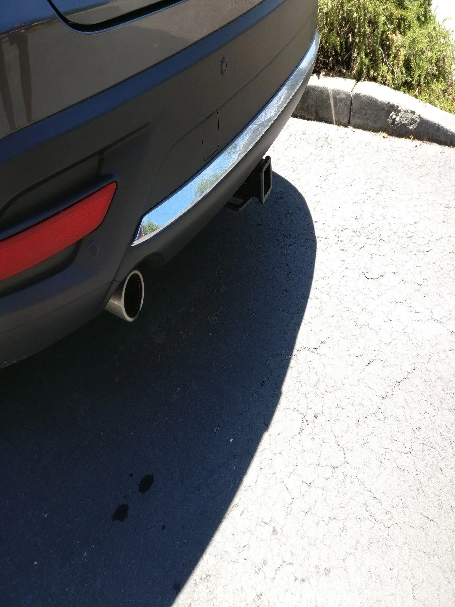

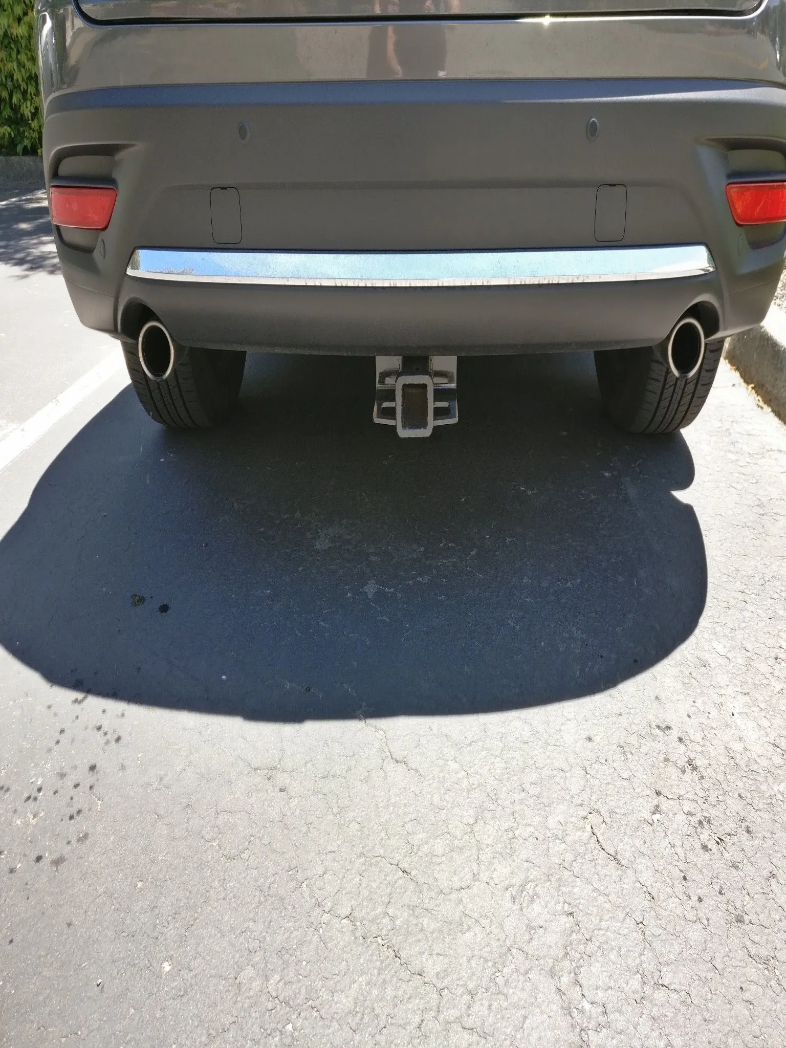

Here are two picks of the Curt Class 3 Trailer Hitch (#13284) on my CX-9.
The forum image uploader is janking the aspect ratio and making it look squished, but you get the idea.

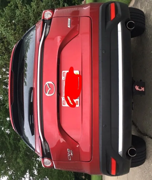

I ordered the Draw-Tite over the Curt. Mainly because it was $15-$20 cheaper. I didn't see much difference in visibility, so $15 is $15...
VERY easy installation. I installed it in my driveway, and it took me maybe 60 minutes (a good bit of that is due to several neighbors stopping by to see what I was up to).
Etrailer was great on price, shipping, tracking on shipping, accuracy on delivery date, and the video that walked through step-by-step installation.

I just purchased and installed the draw tite max frame from etrailer.com. It looks good and was relatively easy to install. Etrailer's customer service was great.
Hi, did you have to drop the exhaust and how did you support it? Wasn’t too hard to put the downward facing bolts through the frame holes?
There are youtube videos about how to disconnect the rubber exhaust hangers. Squirt some silicone lube or WD-40 into them, then push the rubber hanger off the steel piece. You can use anything you want to support the exhaust--a floor jack, a stack of lumber scraps, maybe paint cans, whatever fits the dimension.
The etrailer.com video shows how the included drawing-wires screw on to the bolts, get fished through the holes, then pull the bolts into the holes. It's easy...and easy to over-think it and make the job hard.
