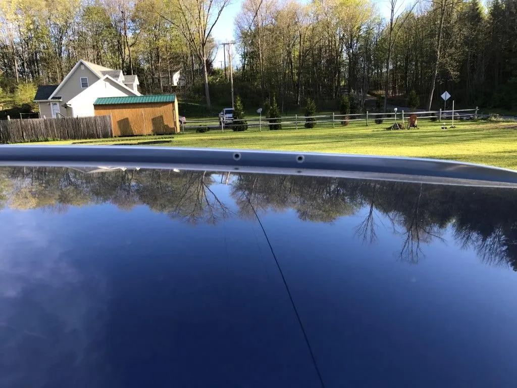

1. The Fit Kit KIT3160 is designed for a Mazda CX-9 with the flush rails. However, I looked at the CX-9 rails and noticed that they had the same mounting holes for the rails as the CX-5.
attachment.php

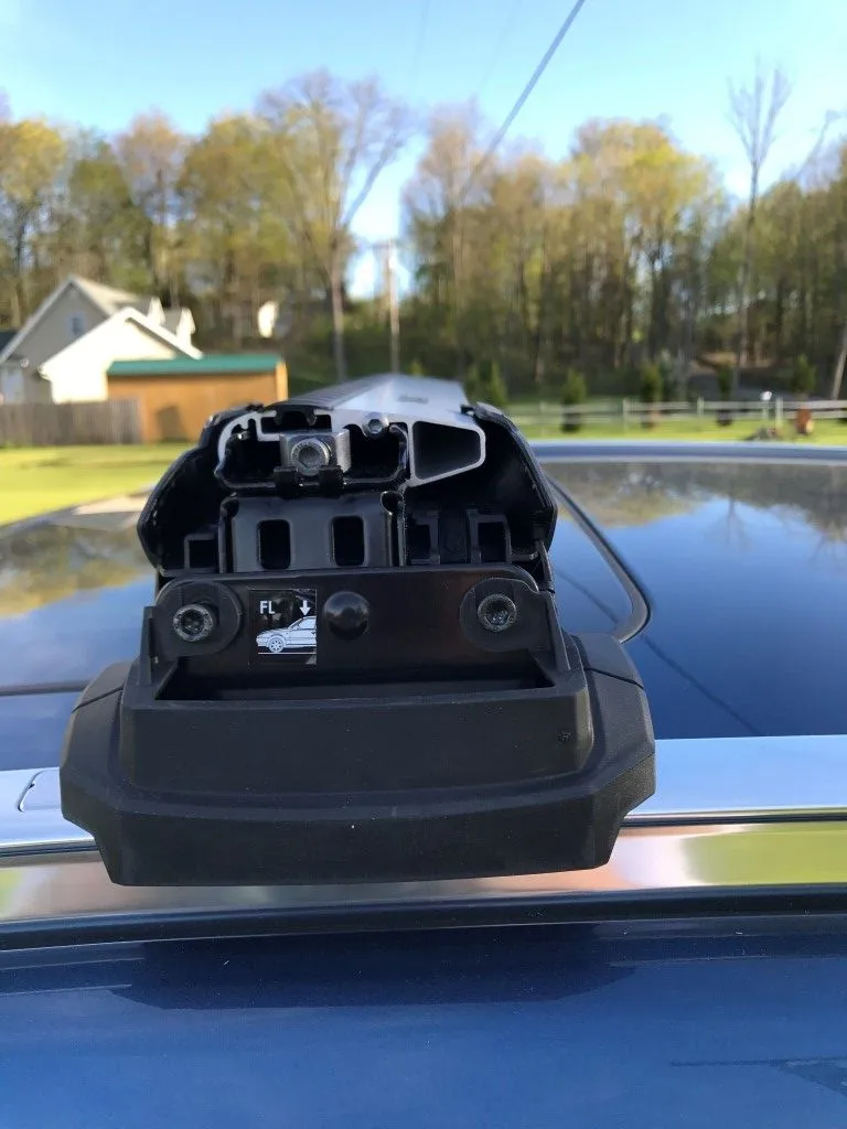

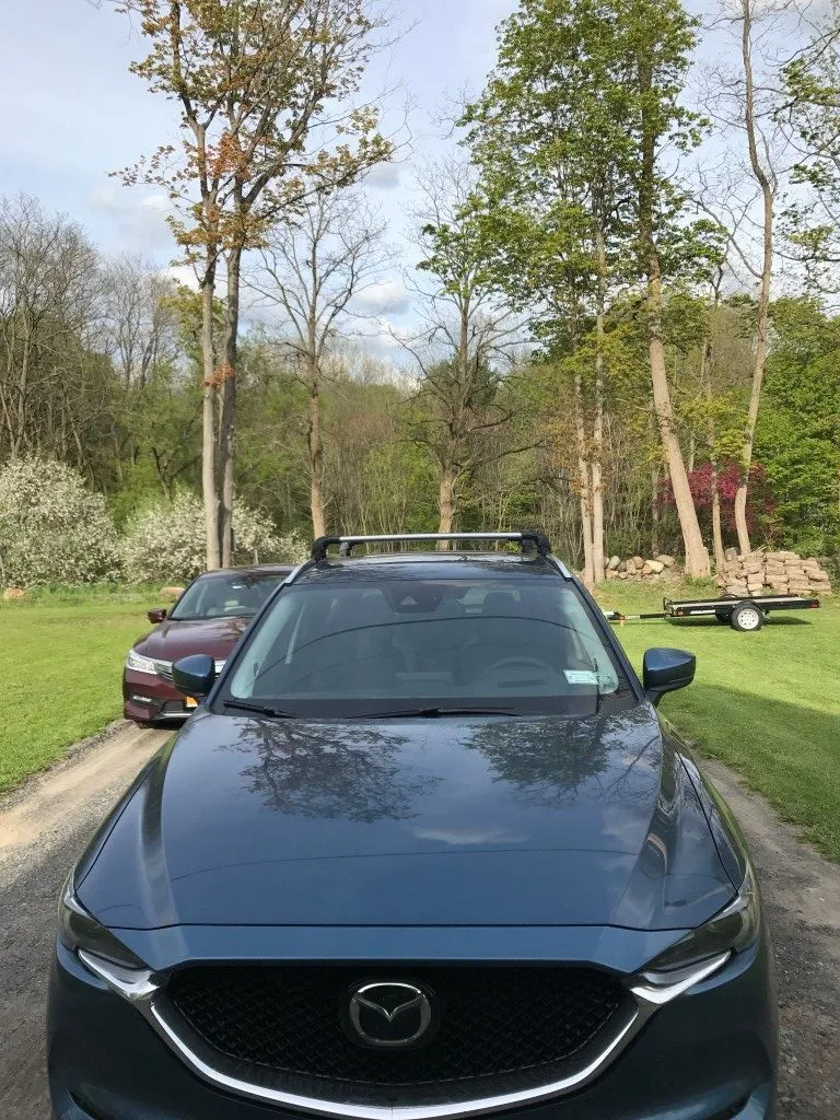

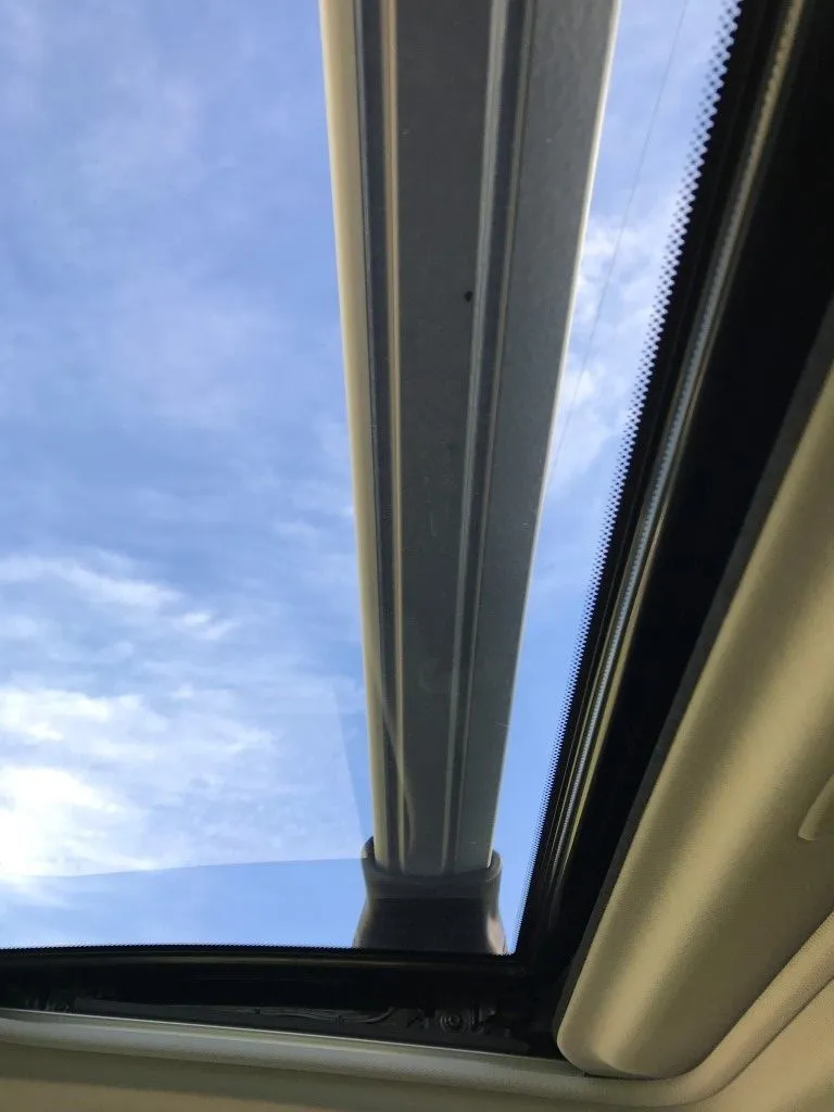

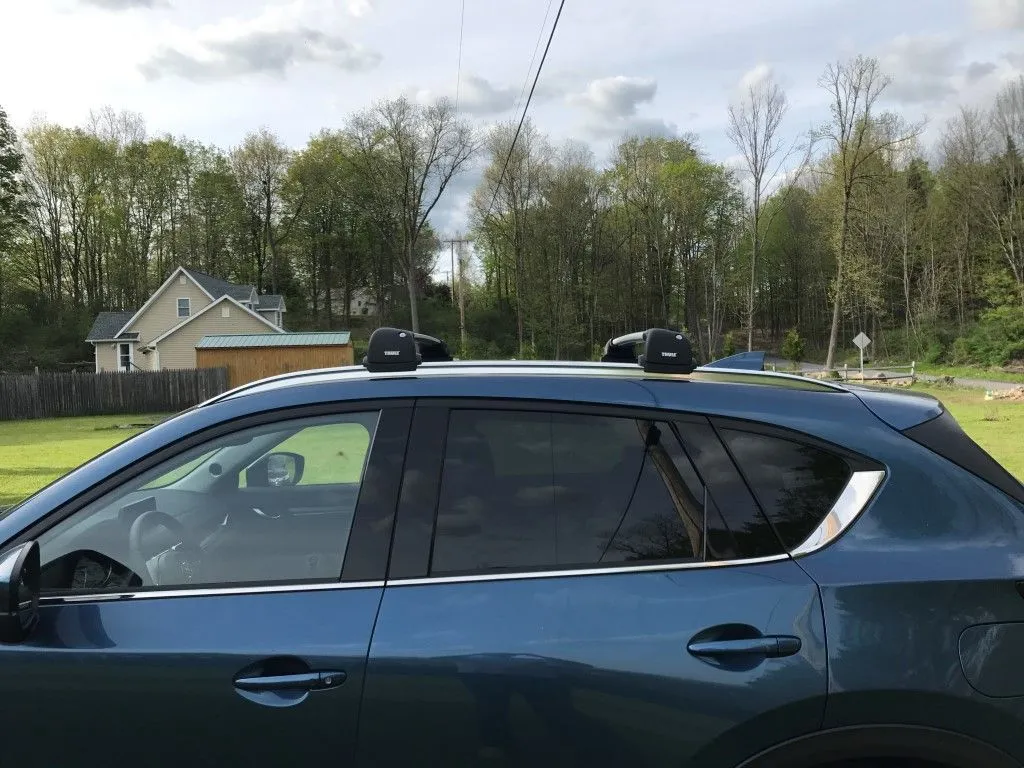

Installation Pics
attachment.php
The fit kit attached to the rail without the installation cover

Side view after install

Front view after install

View from inside the car
