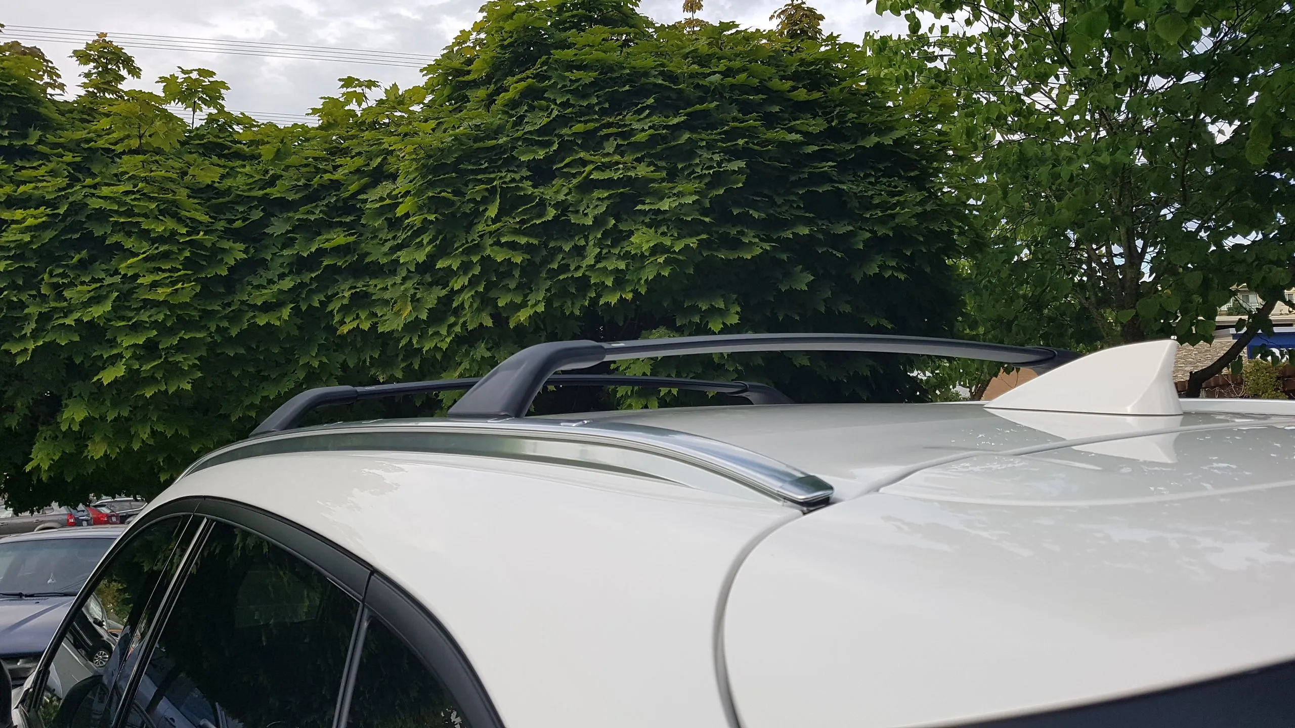

Here they are installed. Rails + Cross bars + Yakima trays
That is sweet!
