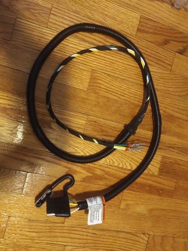

It was a pleasant surprise when I opened the box... It's plug and play except for 1 wire that needs to tap into a harness at the rear and a ground. Nothing to do up front under the hood at all. The harness is very nicely made / OEM quality. Definitely happy I held out for this and well worth the extra couple $.

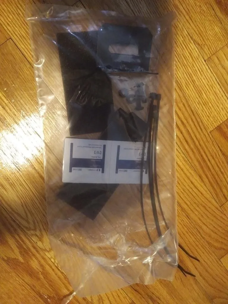

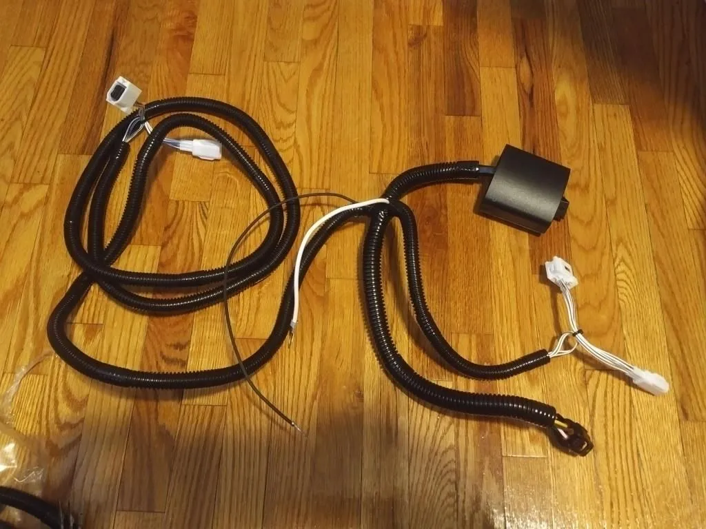

Photos attached because photobucket doesn't work anymore and I haven't signed up anywhere else yet
That's the same as what I got. They put that listing up individually because I emailed asking for a cost on the wiring harness only. Initially they had it listed only with the trailer hitch.

I almost left the harness inside the left cubby to pull out the hatch when needed but instead I used the harness mount that was included with the kit. Instead of mounting it to the hitch (bracket doesn't exist on the curt hitch like it does the OEM hitch) there are 2 holes in the bottom of the rear bumper support that lined up perfectly with the mounting bracket. I removed 1 plastic push-pin fastener and the bracket bolted right up under the bumper. Pretty happy with how it turned out.

Both US and Canada OEM adapter tap into a factory ran accessory wire in the rear harness. You actually put a pin into the harness and don't have to do anything else.
Only other difference is that US part number uses wire taps to tap into the remaining wires at rear, where the Canadian harness is plug and play with the tail light connectors. Other than that they tap into the same power line at the rear and use the same ground point at the rear.
Aftermarket powered adapters are very similar to the US ones with the wire taps, they just need a power line ran to the battery instead of putting a pin into the existing harness.
