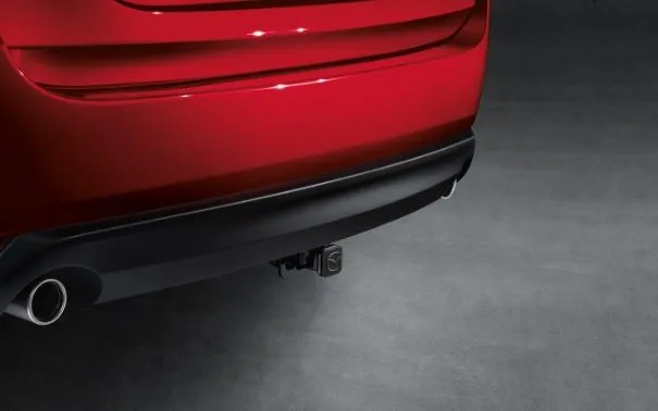

Anyone install the OEM hitch part # 0000-8E-R06. I'm getting ready to install in the next couple of weeks and I'm a bit intimidated because instructions says I the bumper has to be cut, it has a template for the cut. I was reading most of you that have installed are mentioning removing or lowering the exhaust. OEM hitch comes in 3 parts, L&R side brackets the the bar that cross contains the receiver. The instructions does not mention the exhaust. Anyone have any pictures of OEM hitch installed on a 2017. I would appreciate it.

**Update** I ended returning the Mazda OEM hitch 0000-8E-R06. The picture on mazdausa.com shows the hitch right under bumper in two different pictures but it wrong, OEM requires a cut on the bumper. The cut is much bigger than 2016.5, it was like a 5 inch cut vertical and 8 inch horizontal. After some great help from you all at forum I went with draw-tite. Thanks for all your help.

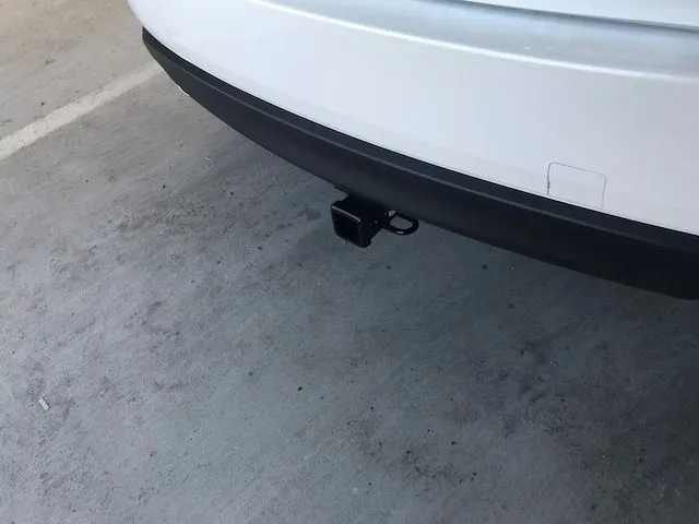

Had the draw Tite 76138 2 class III installed. Perfect fit. No wiring harness as I just needed it to fit my heavy duty bike carrier.
