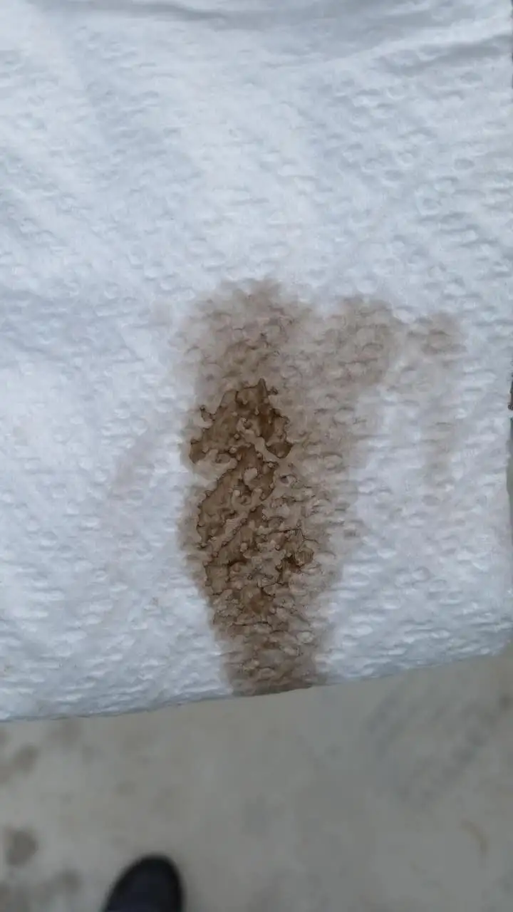

did a drain and fill today. it was pretty straight forward. remove bottom plastic guard, remove hex bolt, drain and fill. only gotcha is that I dumped the new fluid too fast and it overspilled a little.
the new fluid still looks kind of dark (after about 20 min of driving) while not nearly as bad as before, is this because of the large amount remained behind. I assume it'll get better after 2nd and 3rd change?
picture is color after today's change.View attachment 216416

How much fluid did you get out? My guess is 3.5 qts which has been my experience. I believe full capacity is about 8.5 qts so it takes several D&F's to get most of the old fluid out.
yeah, about 3.5 quarts came out. but I only had to put back just a little over 3 quarts to get to midpoint between high and low on the dipstick.
