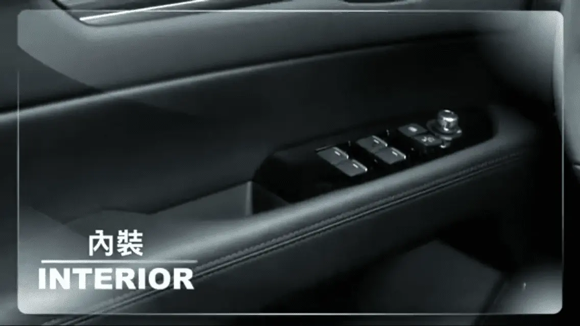

Thanks for the link! Sure looks like there're "rear DRLs" in the video from Taiwan! I also saw one-touch auto up/down power window on all windows with illuminated switches and parking sensors hopefully we eventually will get these in the US:

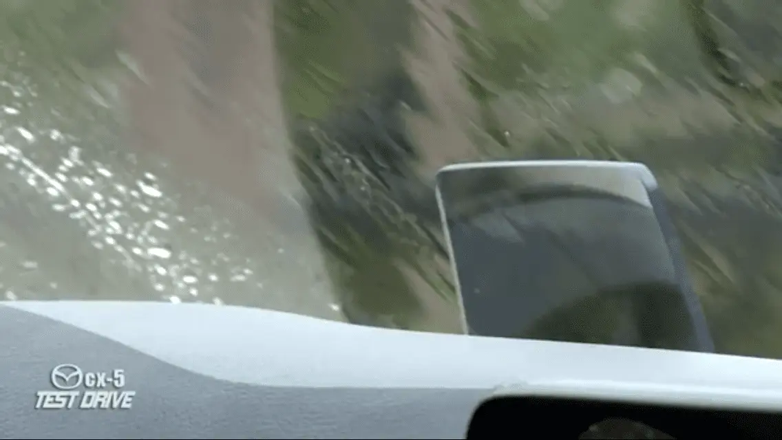

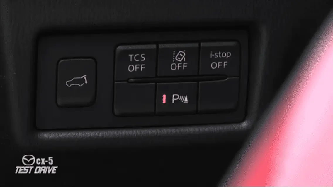

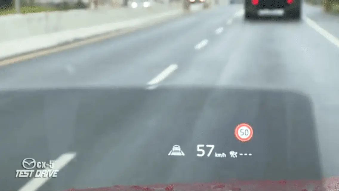

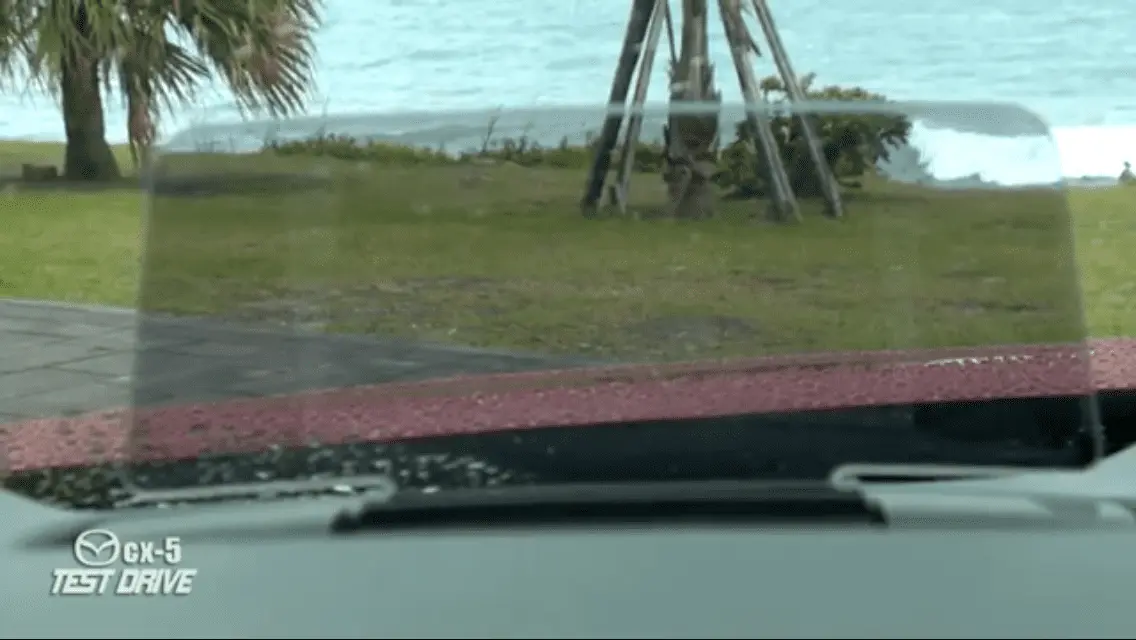

Also noticed there's no spare tire and different auto flip-up type Active Driving Display (HUD) on this top-of-line 2.2L diesel in Taiwan:

Is "all windows auto down" something common on new cars? I just don't see a pressing need for this. Most people, at least ime, don't drive around with all 4 windows down. *Fact. I know because I do...And I never see anyone else doing it. Napoleon Dynamite voice: Gah! I can't believe I have to push 4 buttons to roll my windows down! [emoji3]
Actually a pet peeves of mine. Live in Ohio. Weather finally breaks. Gets warm. What's the first thing many Ohioans do after freezing for 3 months? ROLL UP THE WINDOWS AND PUT THE AC ON. Drive me mad. 😴
I was annoyed that only one switch lights up at first, too. But after not having it for 4 months? Meh. Its a non issue now. I know where the switches are by feel. How many times do you actually need to look for those switches?

My current VW has all windows auto up/down (although is loses its memory all the time and doesn't work correctly). When my 2017 gets here this week its going to take awhile to get used to it, but whatever. Not a deal breaker for me.

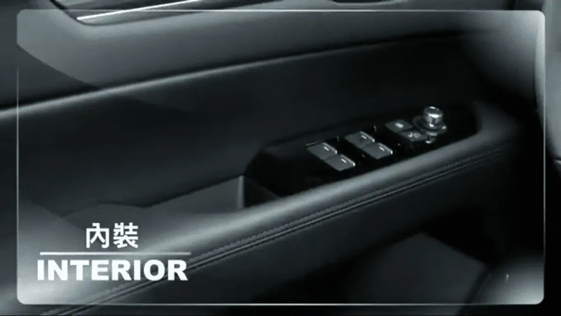

We have auto up and down windows here. Became standard across the range from this new model.
As for HUD, here pop up is on Touring. Windscreen HUD is on GT and Akera (2nd highest and top models). No HUD on base Sport or Maxx Sport
Sent from my XT1585 using Tapatalk
When it's raining and you need to close all 4 windows quickly then it becomes a necessity
