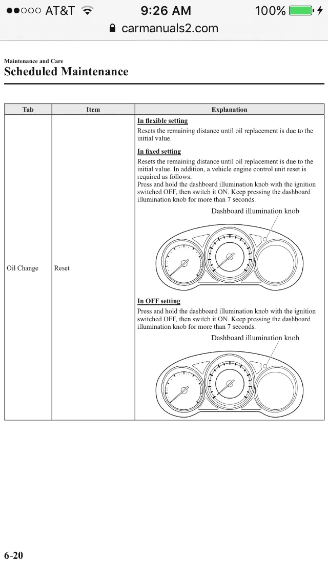

Today I had dashboard showing "Service soon" with about 500 miles left. This couldn't be true, so I tried to reset it, but it didn't go away. I've tried two methods. 1) Selecting [Reset] from Oil Change section of Maintenance Monitor application. 2) Turn off ignition. While pressing dashboard illumination light knob, turn on ignition and kept pressing it for 7+ seconds.
Both approaches didn't work. After fiddling with it a little more, I've changed the Oil Change schedule to Fixed and found that it shows exactly the same miles left. Now I could reset it. So there seems to be a bug that Engine Control Unit thinks it is Fixed mode while infotainment thinks it is Flexible mode.

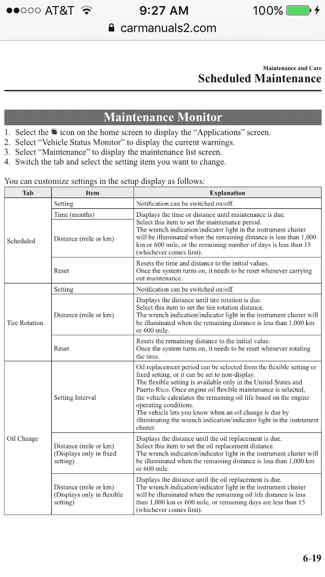

Here is description of CX-9's Maintenance Monitor and oil change resetting procedure:
attachment.php
attachment.php
The infotainment and the ecu don't talk to eachother when it comes to service reminders unfortunately- it doesn't make any sense. You cannot sync them unless you reset them at the same time.

I had this occur recently at around 7.5K miles even though I had my first oil change just at 5K. I successfully reset in fixed setting by holding the dashboard illumination knob in ignition OFF then back ON for 7secs. Took a few tries but I was able to get rid of the annoying oil change due message on my dashboard every time I turned turned on the engine. My infotainment and dashboard remaining oil change intervals are also in sync now.

I just deal the this issue; the "hold down seven seconds" does not work anymore - with the current firmware, it's all done in the maintenance monitor.

For the record, the "7-second trick" worked to reset my service light.
