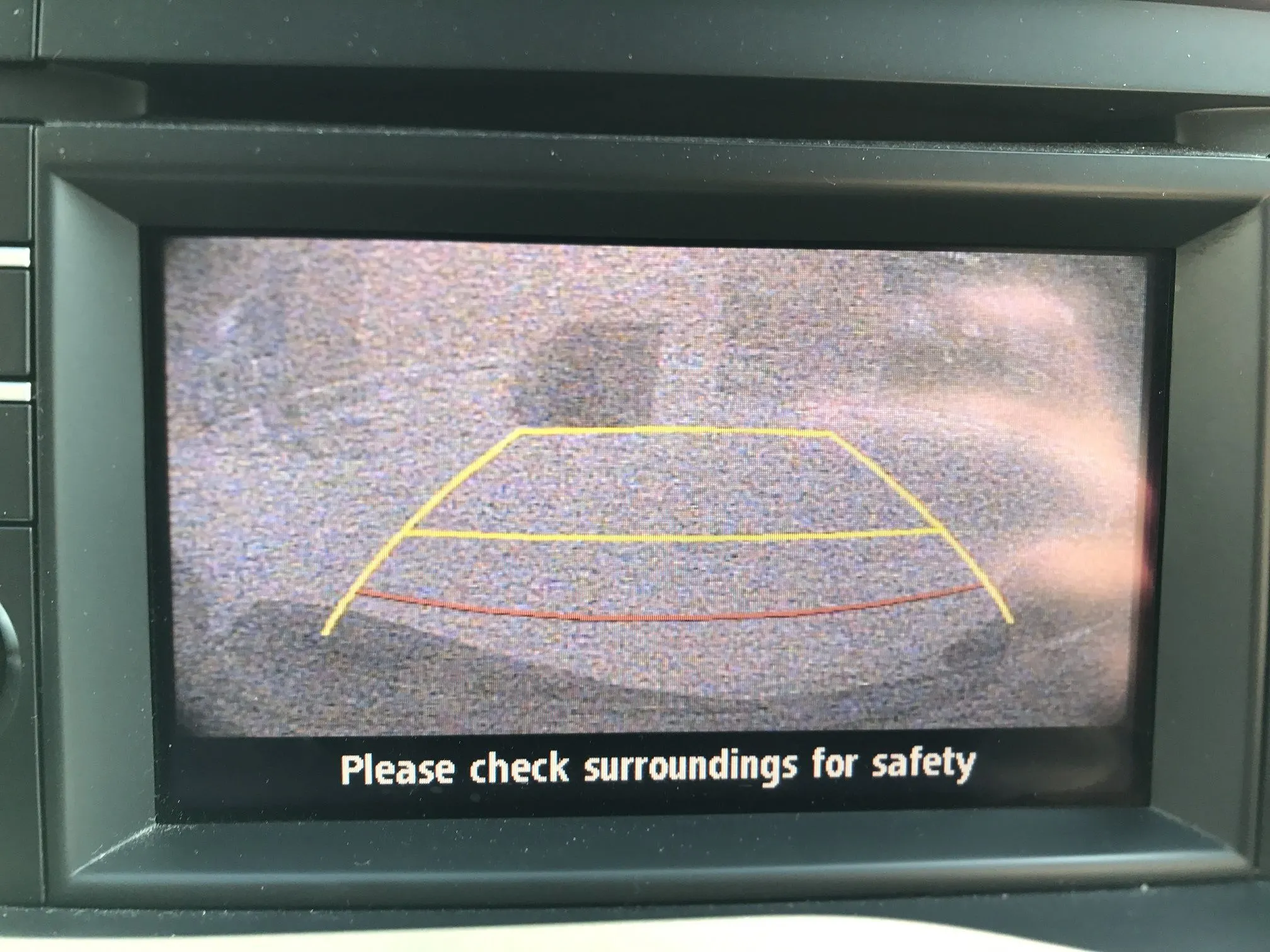

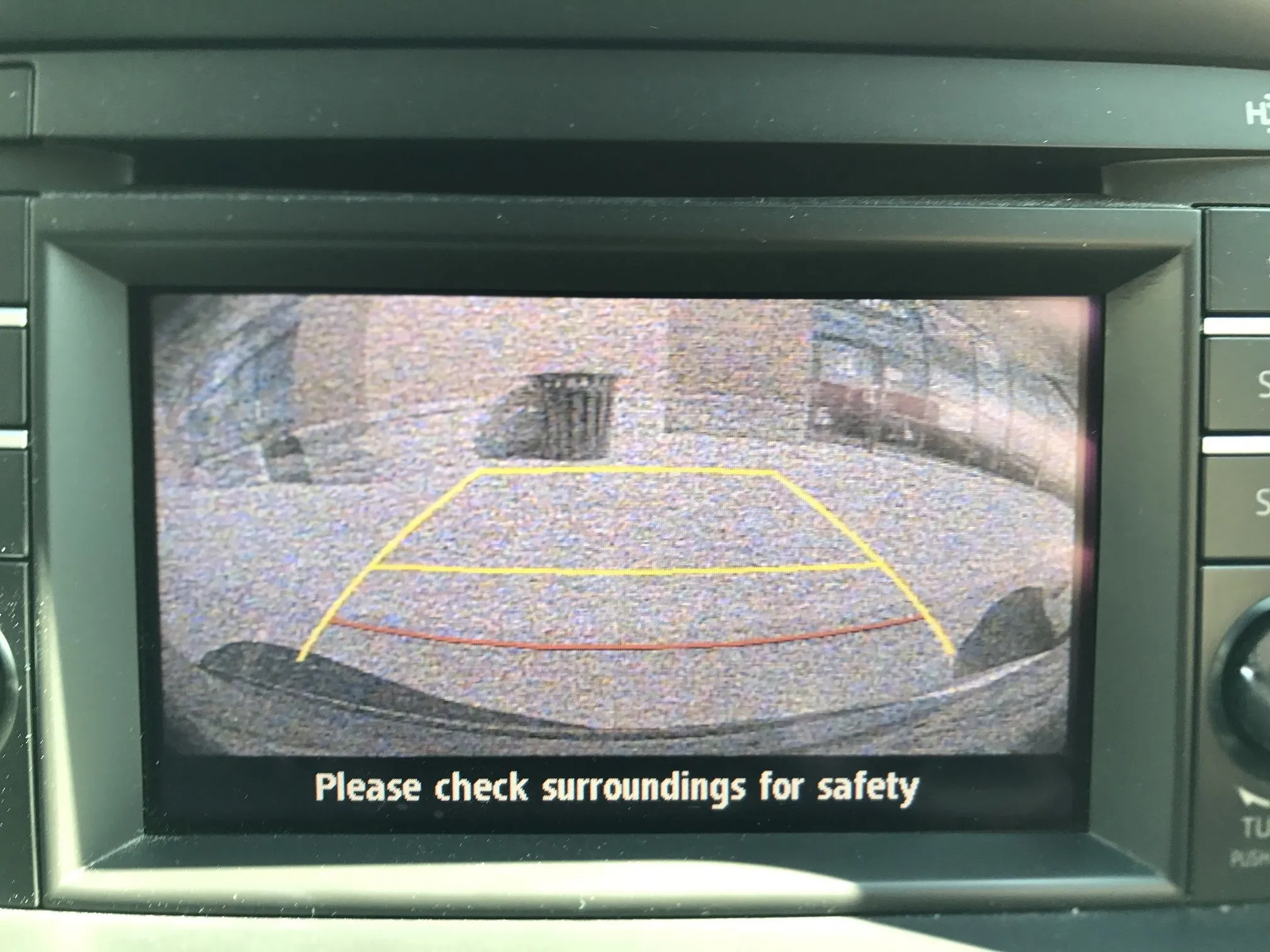

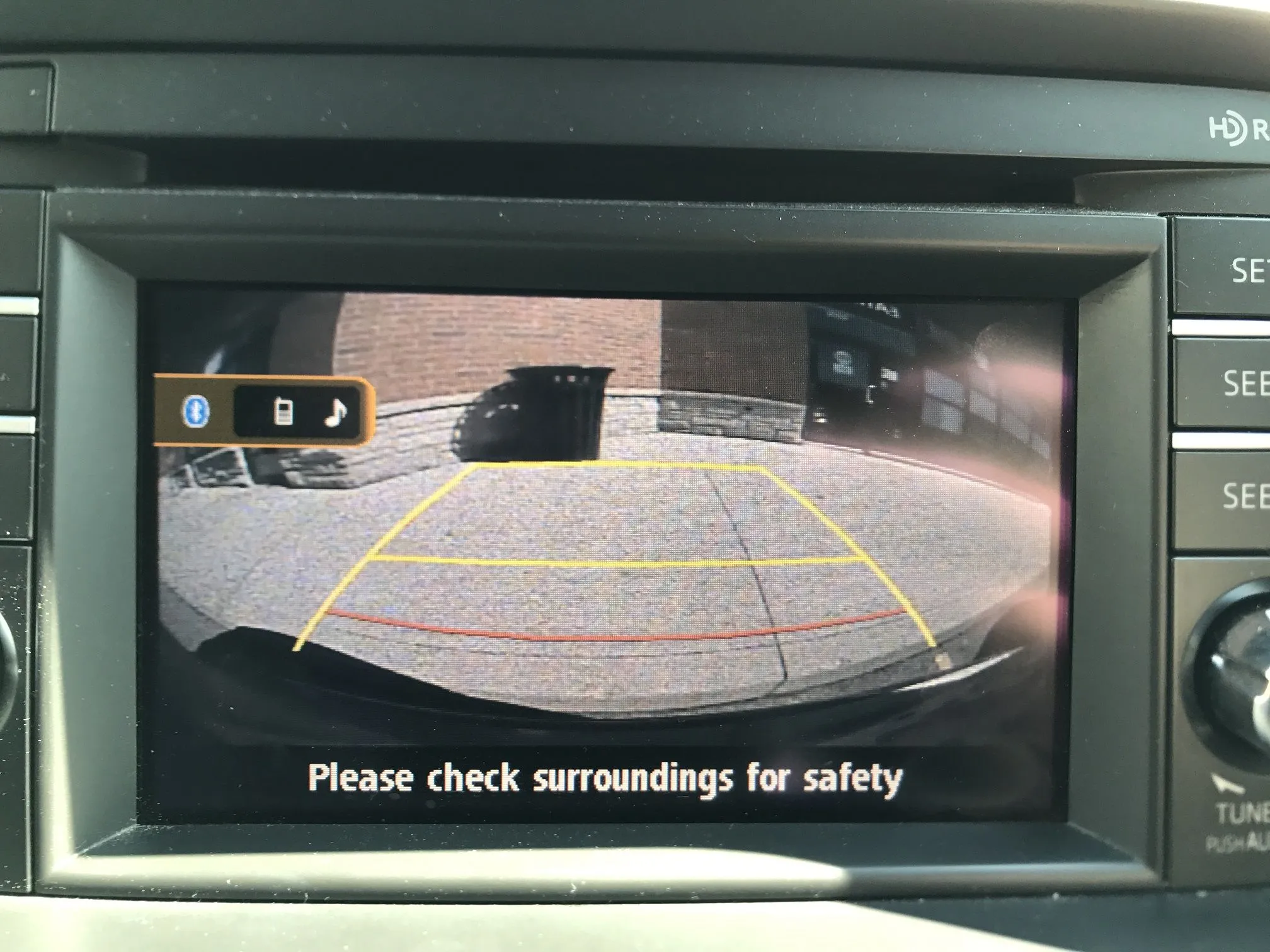

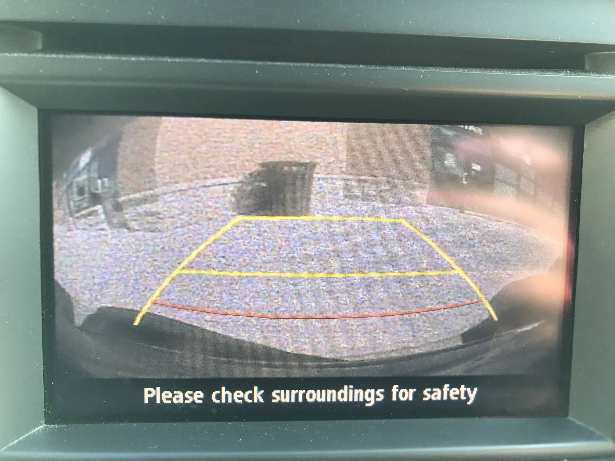

I am wondering if anyone has seen any failures with their backup cameras. I was reversing on Wednesday when the screen flashed and suddenly the camera looks fuzzy. It now is completely random whether or not the camera is clear or fuzzy and everything in between.
All of these pictures were taken within a few seconds of eachother.
Any ideas?
