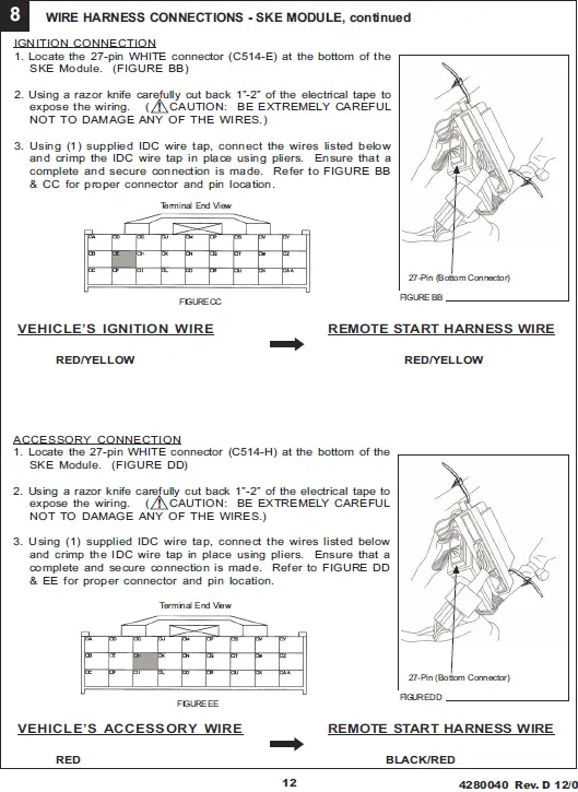

I've got a 2011 Mazda 6 with pushbutton start and I am having the exact same problem. I've been doing some research and I think that the remote start installation manual may have an error....

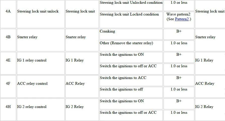

In the troubleshooting section, it says that 8 honks means, "Accessory is ON or steering wheel lock is not engaged." I looked at the remote start schematic and there's no steering wheel input. The Accessory connection wire is red and is supposed to connect to SKE (Keyless Control Module) terminal 4H. In the service manual, terminal 4H is IG2 relay. That seems pointless. It has nothing to do with sensing if the car is in Accessory On mode. It actually duplicates the remote start's Ignition Wire (red/yellow) that goes to SKE terminal 4E.
I looked closer at the service manual and I'm guessing that the remote start's Accessory connection red wire is either supposed to connect to either SKE pin 4A or 4F. 4A is the steering wheel lock input. 4F is the Accessory relay coil output. I haven't tried re-wiring my setup yet. First I'm going to try connecting to 4F and if that doesn't work, then I'm going to try 4A.

BTW, the thing that blows me away is that if this is the problem, it made it in to two revisions of the Remote Start installation manual. The manual that came with mine was Rev. C from 8-2011. the one that you can find online is Rev. D from 9-2012. Maybe Mazda sent out a TSB for this but I'm just a shade tree mechanic so I don't have access to that.
(This is the Mazda6 remote start manual. The connectors are flipped left-right vs the above service manual diagram.)
