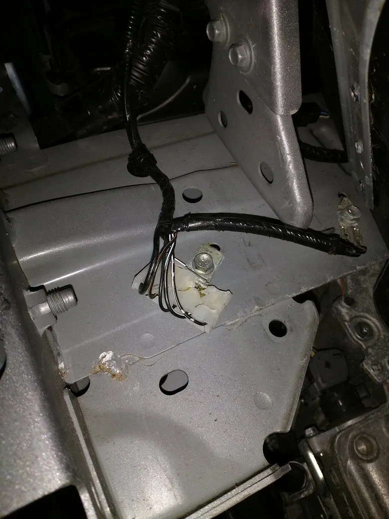

Replaced my front bumper after an accident, but then started having issues getting car to start. When it did start, got check engine light with OBD codes U0100 & U0115 (lost communication with ecm/pcm).
Decided to remove bumper to see if accident caused any other damage, and saw the attached behind the left front wheel. I believe those are ground wires that are connected to the chassis. The accident must have shattered the plastic housing for the cables and loosened some connections. If I move the wires, I can get the car to start.
Does anyone know the part number for the plastic housing that is shattered? Much appreciated!
