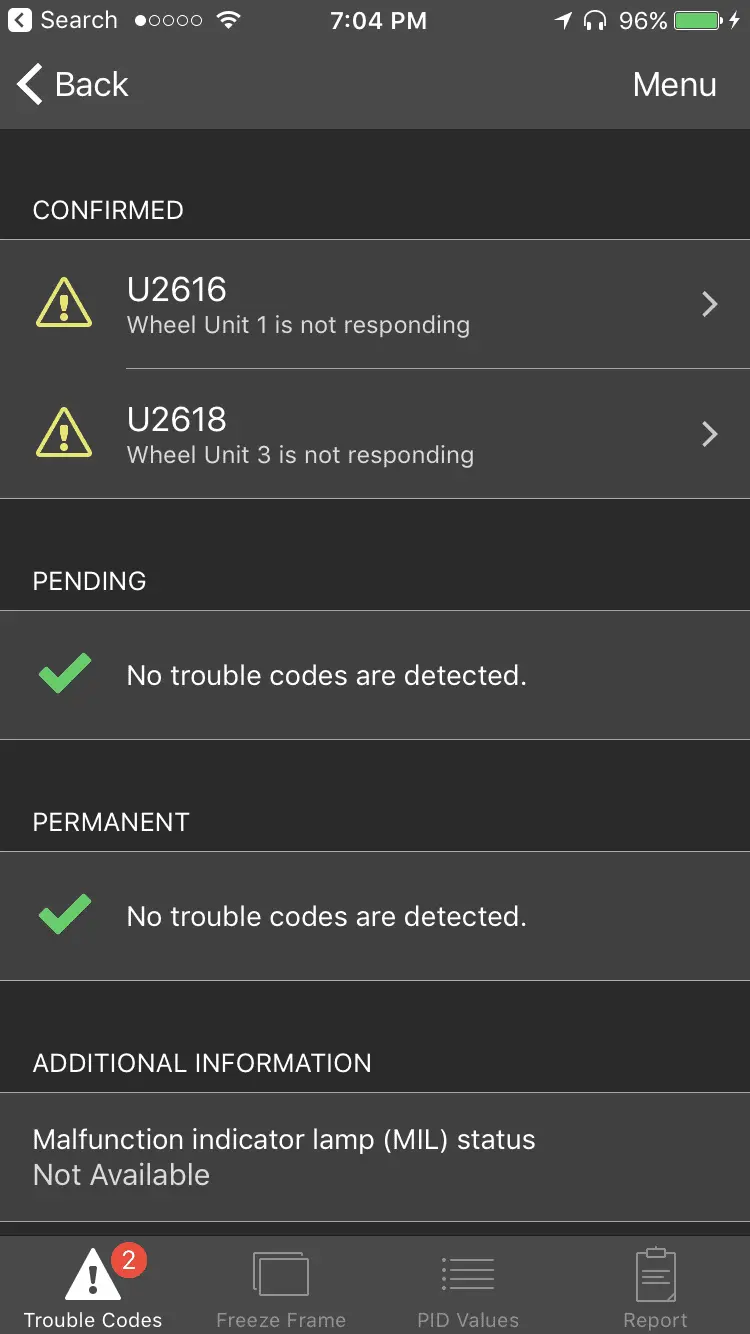

Using OBD Fusion with the Mazda5 add on, I was able to determine that "Wheel Unit #3 not responding". During driving I've gotten errors: U2618 (wheel unit #3), and U2616 (wheel unit #1)
