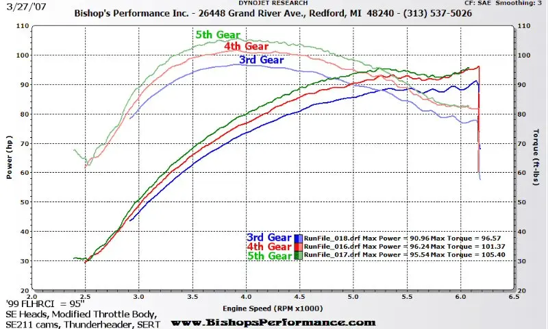

There's something wrong with that dyno chart... It seems to show that torque (equal to the car's acceleration, equal to the push-in-your-backside) is higher in higher gears. That's clearly not the case. I wonder if the clutch was slipping in the lower gears, or if the calculations that the dyno PC uses isn't taking into account the higher drum speed.
I don't think there is anything wrong with the chart.
The dyno PC likely takes info account the higher drum acceleration and compensates for it, but it doesn't correctly compensate for the inertia of the engine/transmission/wheels.
If you fit a lighter flywheel, or even different rear-end ratio to a car you'll end up with different dyno numbers, but in reality the engine is still producing identical torque.
Here is a quote I found on another forum:
Here's the reason, I'm quoting Patrick G on LS1Tech.com:
"Higher ratio gears will give you lower chassis dyno numbers for a strange, but logical reason. In essence, the DynoJet calculates hp based on the time it takes to spin up the 2800lb roller assembly. It's basically work divided by time and rpm. Think about this: If you car is at idle in neutral and you stab the throttle, it will take time to accelerate to redline...let's say 1.1 seconds. Now let's say it takes 8.2 seconds for your car to accelerate the DynoJet from low speed to top speed with 3.23 gears and 7.3 seconds with 3.73 gears. Dyno printout says 355 rwhp with 3.23 gears and 346 rwhp with 3.73 gears...why?
Think aabout this: In the 8.2 seconds it takes to spin the rollers with 3.23 gears, it would still take the motor about 1.1 seconds to overcome its own inertia (idle to redline). There's about 13.4% of the work used just to accelerate the motor itself. With 3.73 gears, the time to reach redline decreases to 7.3 seconds. Divide the 1.1 seconds into the 7.3 seconds and you will see that overcoming the internal engine inertia costs 15.1% of the work with 3.73 gears. There is less hp available during this time period to spin the rollers so the DynoJet will read a slightly lower hp figure. Make sense, or did I lose you?"
That makes sense, and I think I was looking at the chart from the wrong 'direction'. This has been a very informative thread, thanks to all who participated!
