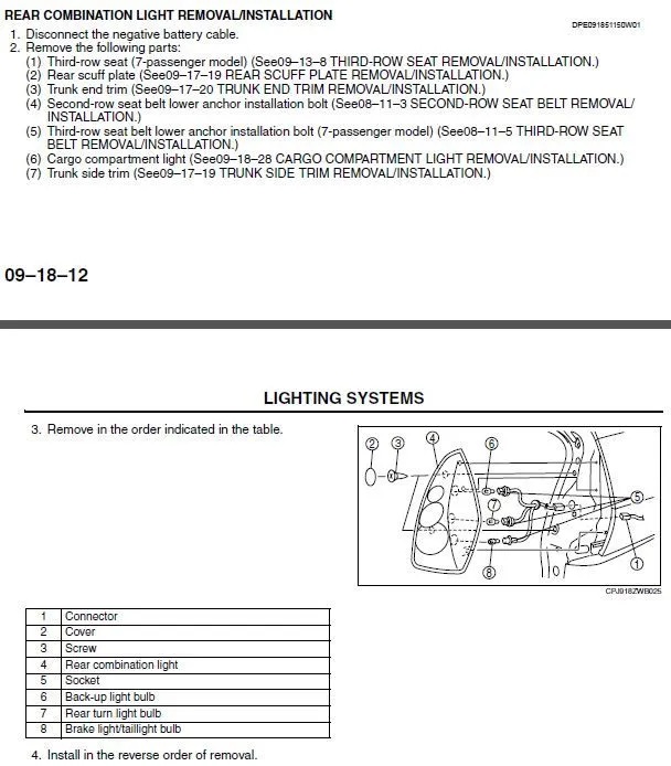

I was able to pop off the old tail light but unable to remove wiring harness. Seems like it may require removing interior parts & 3rd row seats..etc
This is what the workshop manual says:
