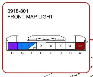

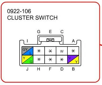

6. Now wiring the harness which will need some modification as it's japanese so right hand drive the switch will on the right.
The lavender/ red wire on the foot lamp harness will be tap to map light connector 0918-801 (see attachments) on lavender/ white wire. (this will be the positive)
The gray/ black wire on the foot lamp harness will be tap to map light connector 0918-801 on voilet wire. (negative)
The yellow/ black wire on the foot lamp harness will be tap to the cluster switch connector 0922-106 on yellow/ green wire (positive)
