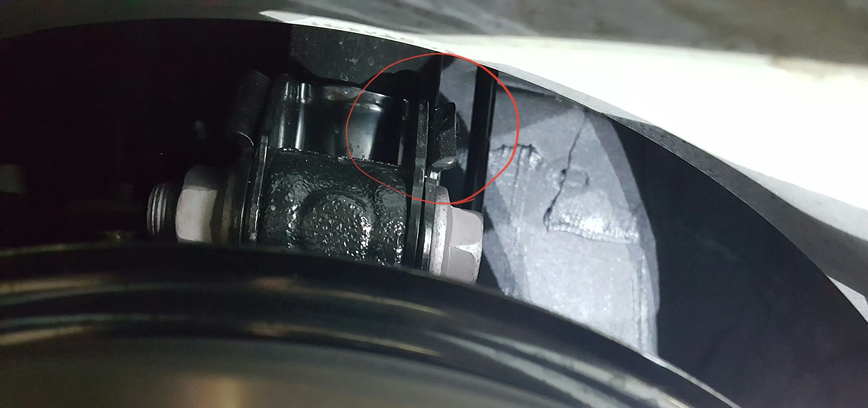

    We have a 2016.5 CX5 Touring with stock 17" rims. We happened to have a set of Security Chain Company SZ143 super Z6 tire chains for another car, and they say they fit the CX5 stock wheel/tire size. Before a trip to Utah this winter, we test-fit the chains on the front wheels. While they do "fit" the tires, on the back side of the tire the blue plastic-covered cable that holds the chains together rubs against a somewhat sharp piece of the strut. It doesn't rub much, and it's possible that the action of driving along with the tension from the rubber tensioner on the front of the wheel would make the chains clear the strut completely, I wasn't 100% convinced they would actually work. I did not test them with actual driving, we just moved the car a few inches in the driveway to confirm the contact between the chains and the strut.
    At least in California we're covered for R1 and R2 with AWD and snow (M+S) tires, and I'm told by the time CHP goes to R3 (chains for everyone) they close the road anyway, but there is still a requirement that all drivers carry chains in winter regardless of their car's AWD capabilities. I'd hate to be stuck trying to get off a mountain and have my chains shredded after 100ft of driving (or worse yet getting caught up in the suspension). I'll be researching this some more before our next show/ice trip.

    That sounds fun! Any issues clearing the strut in the area circled in this photo? You can see it right through the wheel with a flashlight. This is the area I was seeing contact with our cables.2016-12-24 02.09.46.jpg

    SZ143 Super Z6 chains do not work for the CX5. They fit the wheel great, but the cable in the back hits a part of the strut. Even tho the contact is minimal, I would not feel comfortable driving with these, as the contact would wear down the cable over time.
    I installed the cables as instructed, then lifted the car off the ground and spun the wheel to test for contact. Lifting up the car does not change the spacial relationship between the wheel and the strut, as they move in unison.

    Please be advised that if the SZ143 is hitting the strut, Part #*s Z-571 & SZ343 will definitely hit the strut * these need more clearance than #SZ143
    So cable chains are out of the question, unless the inside circle is greater the rim size of 17" to clear the strut mounting bracket.
    Another option that it "might" work is the Peerless 0155505 that has a solid inside circle. Again, the inside circle has to be 17" or greater.
    https://www.peerlesschain.com/tire-c...tirechains/178
    I emailed Peerless again to ask if they can get the diameter of the inner circle and the thickness of the ring so that it might clear the strut tube?
    Edit #2:
    Just installed the Peerless 0155505 and looks like it will not touch any part of the strut.

    In case anyone is wondering, I tried my SZ143s on my 2019 GT's stock P225/55R19s (Toyo A36), and while the chains do fit onto the tire, the inner cable hits the same part as above. Can't say how much damage it would do over time, but probably not worth risking it.
