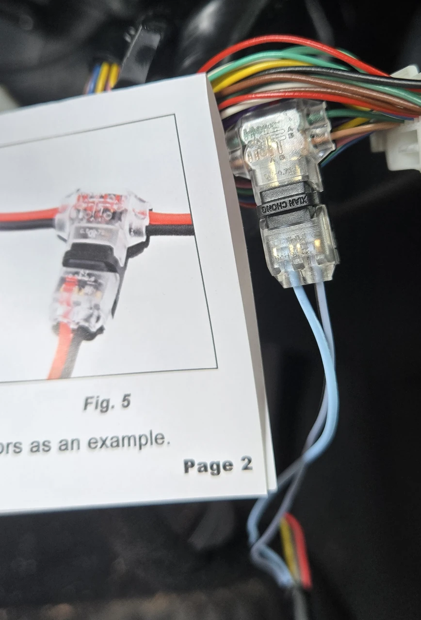

I just installed this system on our 16 CX-9. Here is my list of parts:
Fortin EVO-ALL
Fortin THAR-MAZ1
Crimestopper Revo 1.1 RF kit
Fortin Flash link Updater 2
Single pole toggle switch
I got the RF kit because the OEM remote has limited range. I still programmed the OEM remote to start the car but the RF kit remote is what we use when at the office.
The T harness is what makes this install pretty simple. The two wire splices you have to make are pretty critical though so use the right splices parts for a good connection. The splice wires are 24-26 awg wires so I spent unnecessary time troubleshooting a bad connection due to the splice connector not making good contact.
The hood pin and override switch is to prevent the remote start from turning the engine if someone is working on the car. A reasonable safety expectation. But I found it pretty difficult to run a wire into the cabin. So I settled for just the override switch and have to remember to switch it when changing oil or the like.
The one wire in the fuse box is a bit cryptic. It asks you to shove a wire into an empty position of one connector. Try to find a wire that fits snug like 22 awg. What this does is the end of the wire will engage the pin at the bottom of the connector and is small enough to "mate" with the wire.
Then there is the "optional" driving light connection. I did this but it is not simple. The turn signal stalk pops out from the steering column and must be disassembled to get to the wires. There isn't enough room to use quick splice connectors so I had to solder bus splices to the wires. This means handling a soldering iron and heatshrink tubing.
The programming instructions are reasonable. I highly recommend removing the OEM remote battery for this part. The placement of the remote is pretty sensitive and was the most frustrating part for me.
The T harness has plenty of wire length and I would even remove some of the unneeded wires just to lessen the bundling.

jm- how many wires did you splice in? I only want to do a remote start and include the parking light integration.
thanks!
I used a maz1 kit on mine. Had to tap two wires. The maz3 no taping. I did not tap my parking lights and they come on when started.
Thanks, correct me if I'm wrong, but looks like pins 8 and 9 (both blue from the car side). I have the maz1 as well. Thanks again!
That is correct, also don’t forget about under the hood grounding.
Great, I don't think I'll be doing the underhood grounding (if you're referring to the hood latch). I'll be the only one working on the car.
The only other question I have is whether both remotes are necessary to program the remote starter? My 3 year old is a level 100 thief and has managed to misplace my 2nd key (at least that's my story).
You have to add a ground wire in the fuse box under the hood or it will not start. Shows the example in the instructions.
Aha, understood. I will not miss that. I appreciate you correcting me.
