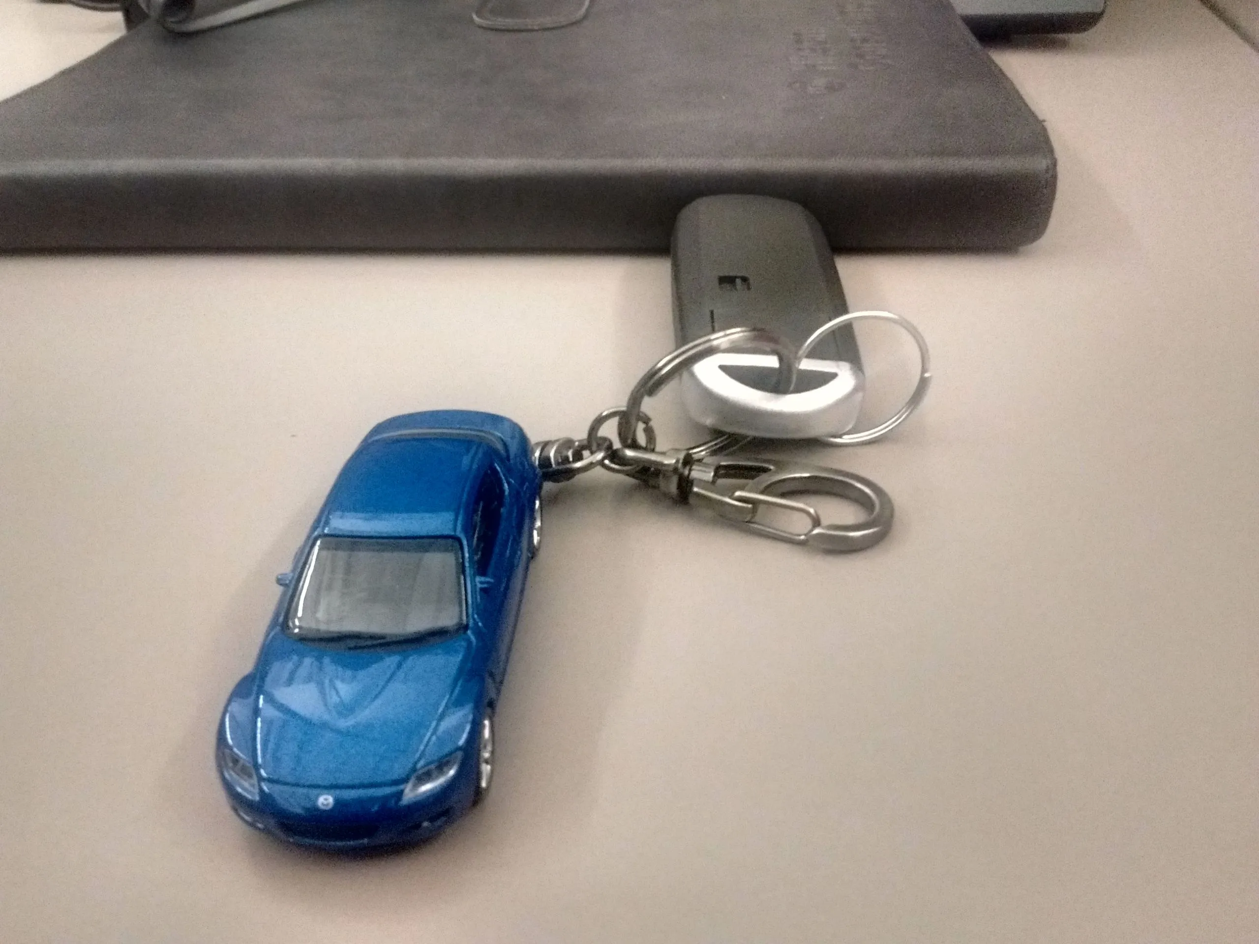

speaking of fob, if my battery on the fob dies I just use the Rx-7 to jump start it. jejeje
attachment.php
OMG, everybody here complained about having to carry a second key fob for their remote starter, and you actually have a freaking RX-7 instead. I so hope it's a key fob in disguise :)
