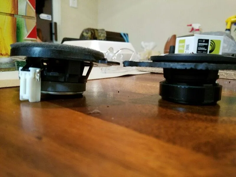

Left and right dash speakers replaced with components.
Toneb210
2016 Mazda CX-5
Components used are as follows:
1. Dayton Audio rs75-4 for the woofer in stock dash location. I cut out a bracket for it and it fits just fine
2. Crossovers and tweeters come from a pioneer component set (ts-d1730c). I used the woofers on another install and was left with crossovers and tweeters so I figured I'd put them to use here. Crossover point is @4800hz, which works great in this case because that about where the Daytons begin to roll off their upper frequency response anyways.
The crossover has 3 tweeter settings. -3db, 0db and +3db. I ended up using -3db setting
The location I chose for the tweeter is where I thought it would be easiest to install. Before making any cuts I played around with a few different locations for the tweeters and this one was the best in my opinion for sound and ease of installation.
Also keep in mind, you can do this project while using the stock dash speakers if you want. You just need the passive crossovers and tweeters. Parts express has a good selection.

Yes I've read about configuring like that also. There really is no 1 way of doing it. It's all trial and error and what is appealing to your eye and especially your ears. Time alignment is a great feature. It's basically just adding delay in milliseconds. Also, in this case, making a component set out of the dash speaker, mounting a tweeter in the pillar was just way easier. If your component set involves a door speakers, we'll then it would be easier to install in the little plastic triangular trim piece at the top of the door. At the end of the day it's whatever makes you happy

Yes bose amp is still powering the dash speakers, rear door speakers and the 2 small speakers in the cargo area. I'm running 2 added amps. 1 for the front doors and 1 for subs. For the dash speakers, you have to remove the plug that goes to the speaker. Once you have just the speaker wire, that will be sent to your passive crossover. Coming out of the crossover you will have a wire that goes to the woofer (dash speaker), and a wire that goes to the tweeter. If you elect to do this with the factory dash speakers, you would just re attach the factory plug that was removed to the wire that goes from the crossover to the woofer. That way it would plug right back in to the factory speaker.That's about it.
