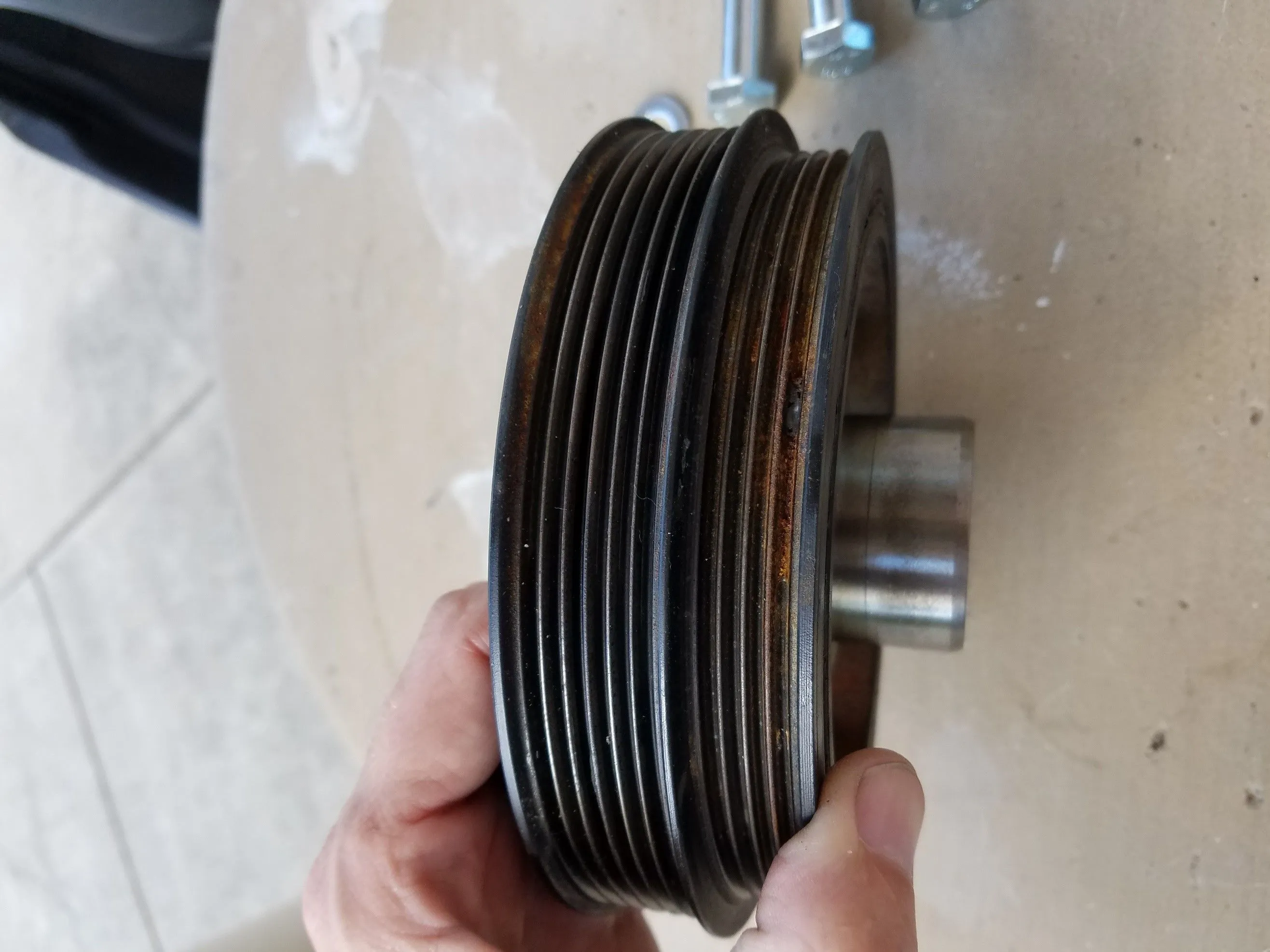

Unlike the primary drive belt that goes to the alternator and ac compressor, the power steering belt does not use a tensioner or adjustable mount to allow for the belt to be slipped on and then tightened. It uses a stretch belt and this was the first time I have tried to install one of these. There were some tools out there that I tried, but none seemed to work properly for this particular vehicle. Many of the slip belt vehicles allow for the belt to go over the accessory (power steering pulley in this case) and then is "slipped" onto the crankshaft pulley. This will not work on the CX-9 because the power steering belt goes on the back side of the crankshaft pulley and it would have to fit over the larger primary drive pulley portion (the crankshaft pulley has two sections on it, one for the primary belt in the front and one for the power steering belt in the back) which proves to be too large to stretch over as I tried this first and broke the belt.
Here is a pic of the crankshaft pulley so you can see what I mean:

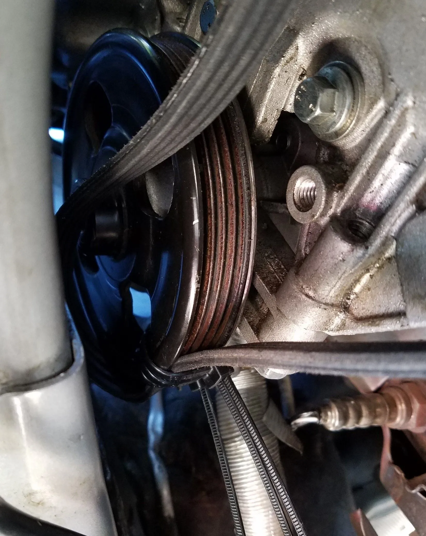

Step 1: Use three large zip ties to attach the power steering belt to the bottom of the power steering pulley (see pic below)
