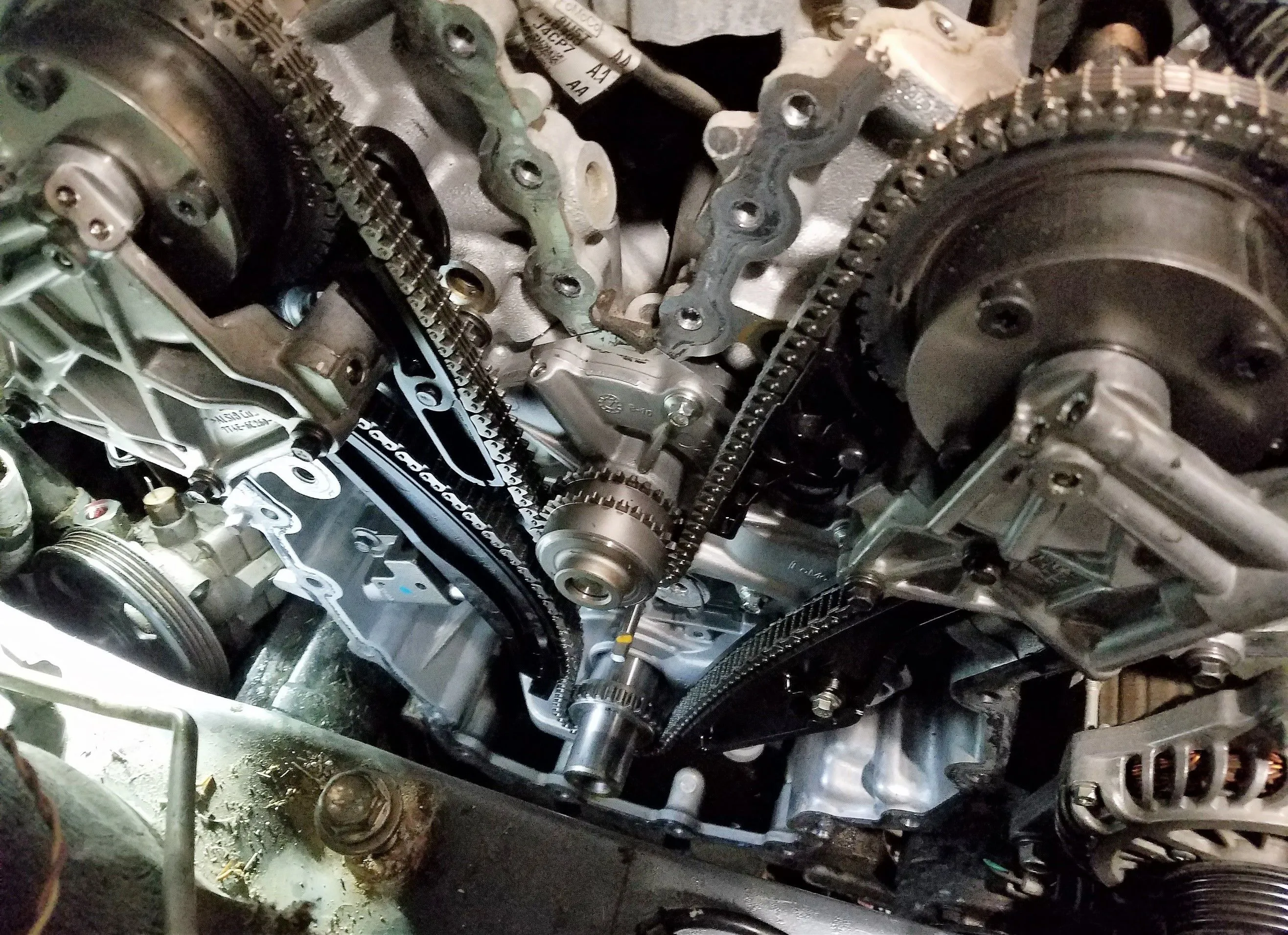

Here is a pic of the actual water pump, it is in the center of the timing chain path and it is driven by the timing chain:
Wow... that's a pretty sexy looking unit if I say so myself. Looks like a fun job. I plan to do it myself as well. I have to say that water-pump does look like high quality. Not a junk part at all.
