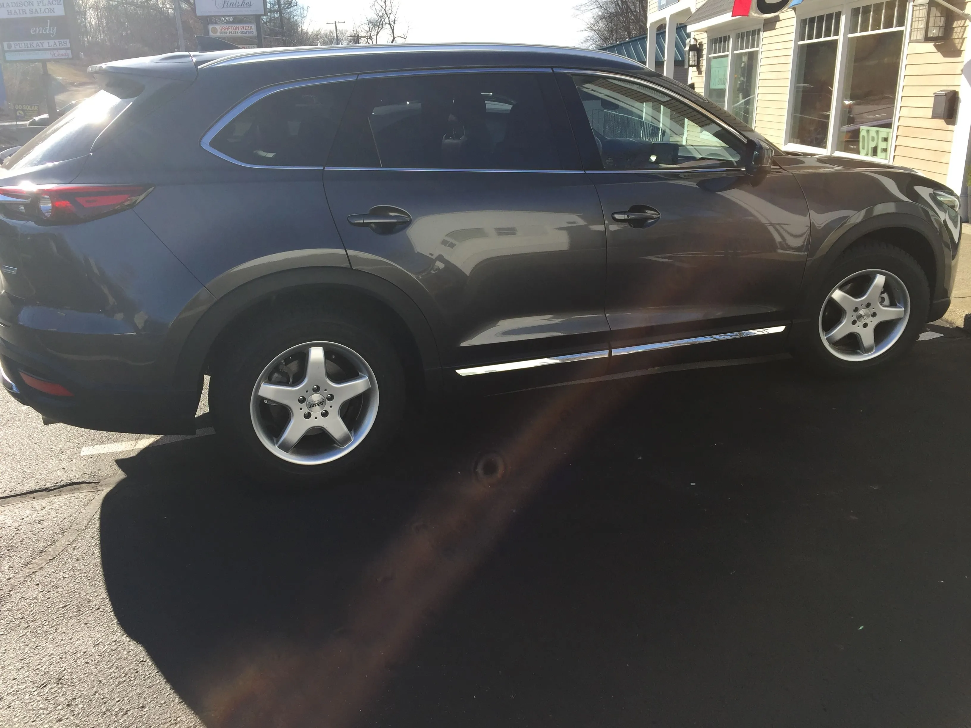

When I bought my 2008 CX-9 the 255/50 R20's Blizzaks were ridiculously expensive and the stock tires which came on the car were garbage on dry, wet and snow. So I bought a set of Blizzak's and cheap rims from Tire Rack. Size 235/65 R18. They are the EXACT same circumference, about one-half inch not as wide, but were about $500 cheaper. Good news is the 2016 Signature uses the exact same size tire and just had my old Blizzaks installed. While the tires fit, it's time for some new tires. It was extremely painful explaining to my dealer why i wanted this size tire on my new car. They eventually agreed I wasn't crazy.
Anyway, here's a photo with the old Blizzaks. New ones should be in before end of next week.
Just curious based from your experience of having a slightly narrower tire (235mm which was you said half an inch narrower than OEM) did it affect the driving/handling of the CX9? I was considering replacing my OEMs and the tire shop was recommending the slightly narrower width but same O.D. as the OEM spec..the 235s were a lot cheaper than the 255 spec.
