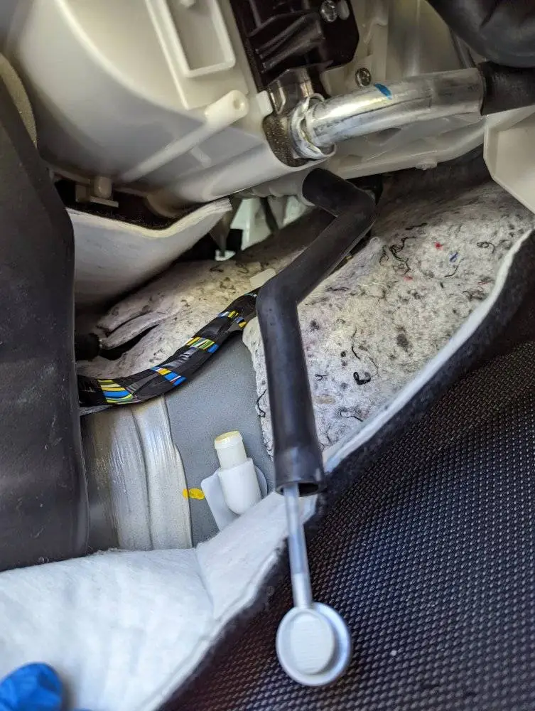

My 2019 (54k miles) started doing this the last week or two and this video greatly helped.
I did notice the hose is slightly different on the 2018 as it didn't have that retaining clip on the top part of the drain hose.
I was able to get the kool-it line all the way into this hose and emptied the can into the line.
had some discolored fluid leak out of it into a container while I let it sit for 15 minutes so you could tell it was definitley cleaning it out.
After starting the car up it appears the smell is greatly reduced / gone but I'll keep an eye on it the next few drive cycles.
one interesting things is I drove the car around for about 10 minutes after cleaning (with that kick panel removed) and I did see a bit of water on my floor mats. Not much but dripping from somewhere.
The drain line doesn't appear to be clogged as it was dripping into a tupperware container earlier so maybe it's just some extra condensation / fluid that I missed earlier. Something to keep an eye on the next few days.
small leaks from lower vents when you do it this way. if its sprayed from the other side thriugh the blower motor (motor has to be removed) it doesnt leak. Also most likely your spray doesnt evaporate immediately. Not all sprays are equal.
But at the end it works :)
