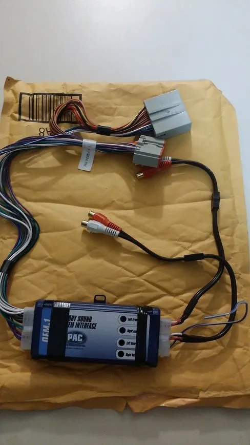

I bought a PAC AOEM-MAZ2 adapter from amazon per this thread in the hopes I could hookup a Rockford Fosgate P300-10 Punch Powered Loaded 10-Inch Subwoofer Enclosure to my 2016 CX-5 GT Sport without cutting/splicing any original manufacturer wires. I went to the glove box to hookup the adapter....and the connectors were incorrect. I looked at the pics provided in this thread and i noticed I'm missing the light brown wiring connector. My PAC adapter was also shipped without original packaging or any instructions. It was just thrown into a packing sleeve. Since i bought from amazon the return will be easy.....However, I don't want to take another chance on getting a used\incomplete item from Amazon. Where did you guys buy your PAC from?
Pic of what I was sent: 20160622_235529.jpg
Upon closer look of the wiring harness i was sent, it looks like the PAC AOEM-FRD24 Add-On Amplifier Interface with 24-Pin Connector for 2005-Up Ford Vehicles was sent to me rather than the PAC AOEM-MAZ2 adapter I ordered.
Mine came in original packaging and has 1 brown plug and 1 white plug.
Was yours sold and shipped from Amazon. Mine was.
fyi, I assumed this would work, considering a 2015 3 and a 2016 CX-5 has the same Bose wiring, but the 2015 CX-5 w/ Bose doesn't seem to have that white wire harness.

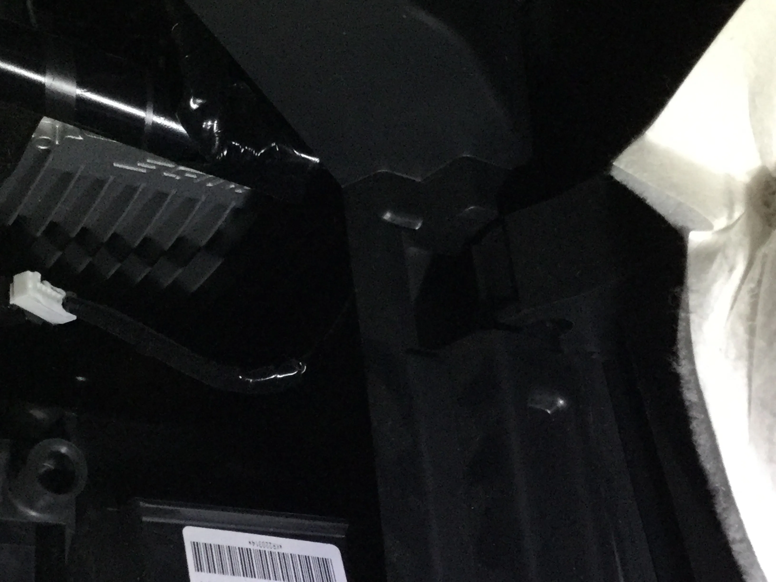

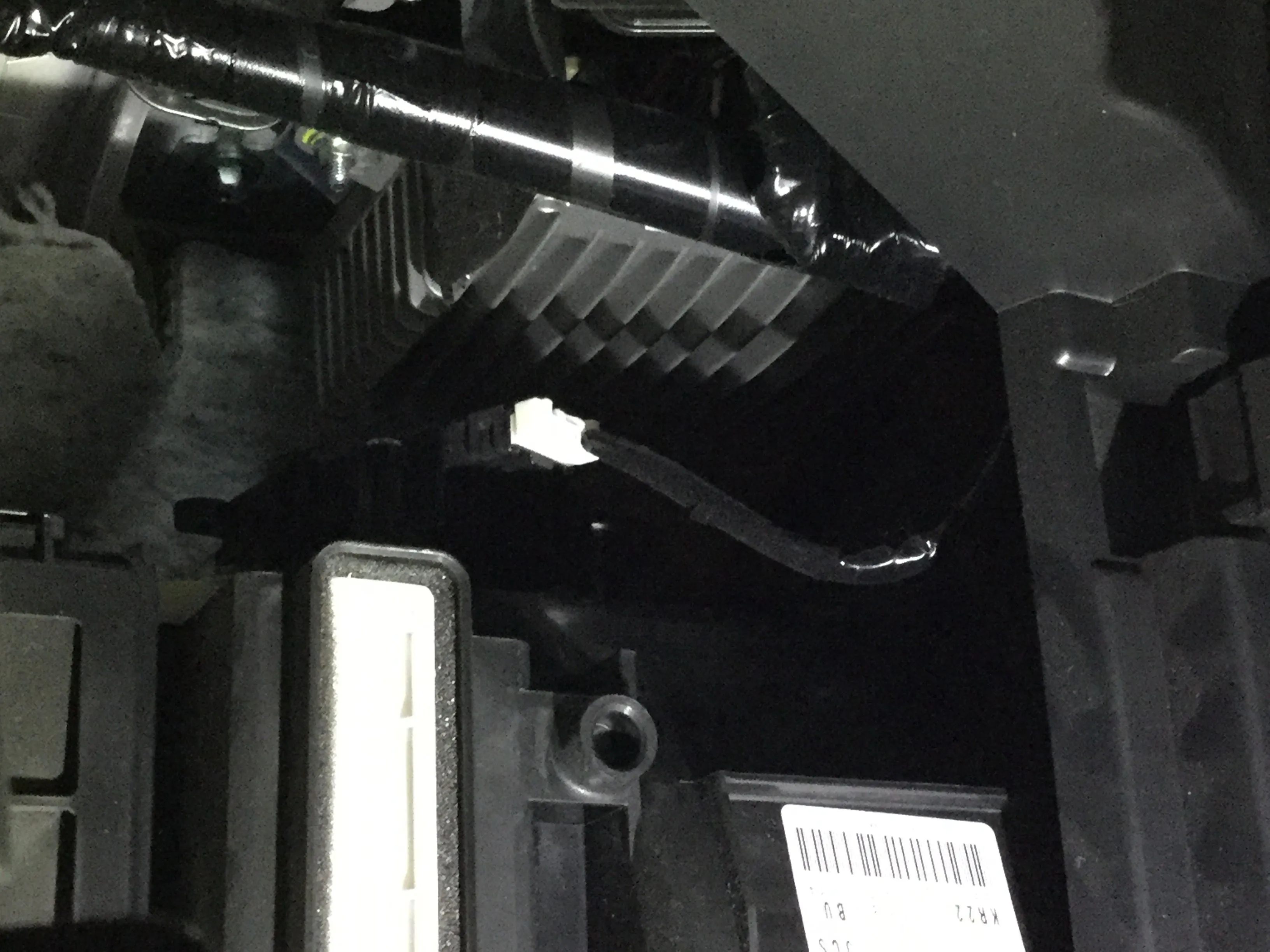

The Bose amp is in the glove box on a '14
My harnesses are black, green, black. Going vertically from bottom to top.
So does that mean this harness won't work?
In the 2016 at least with Bose, there's a TAU (tuner/amplifier unit) in that position behind the glove box and into which the PAC interface plugs. The actual Bose amp, however, is located under the front passenger seat.
From what I can see in the 2014 service info (see attached), looks like indeed the Bose amp unit is behind the glove box instead. I don't see a separate TAU unit for the 2014, so maybe it is built into the headunit instead and that connector if identical is located on the back of the HU itself...??
If not, then this PAC module would unfortunately not be compatible....(FYI the info for the 2015 appears identical to the 2014 in terms of the entertainment system layout)
