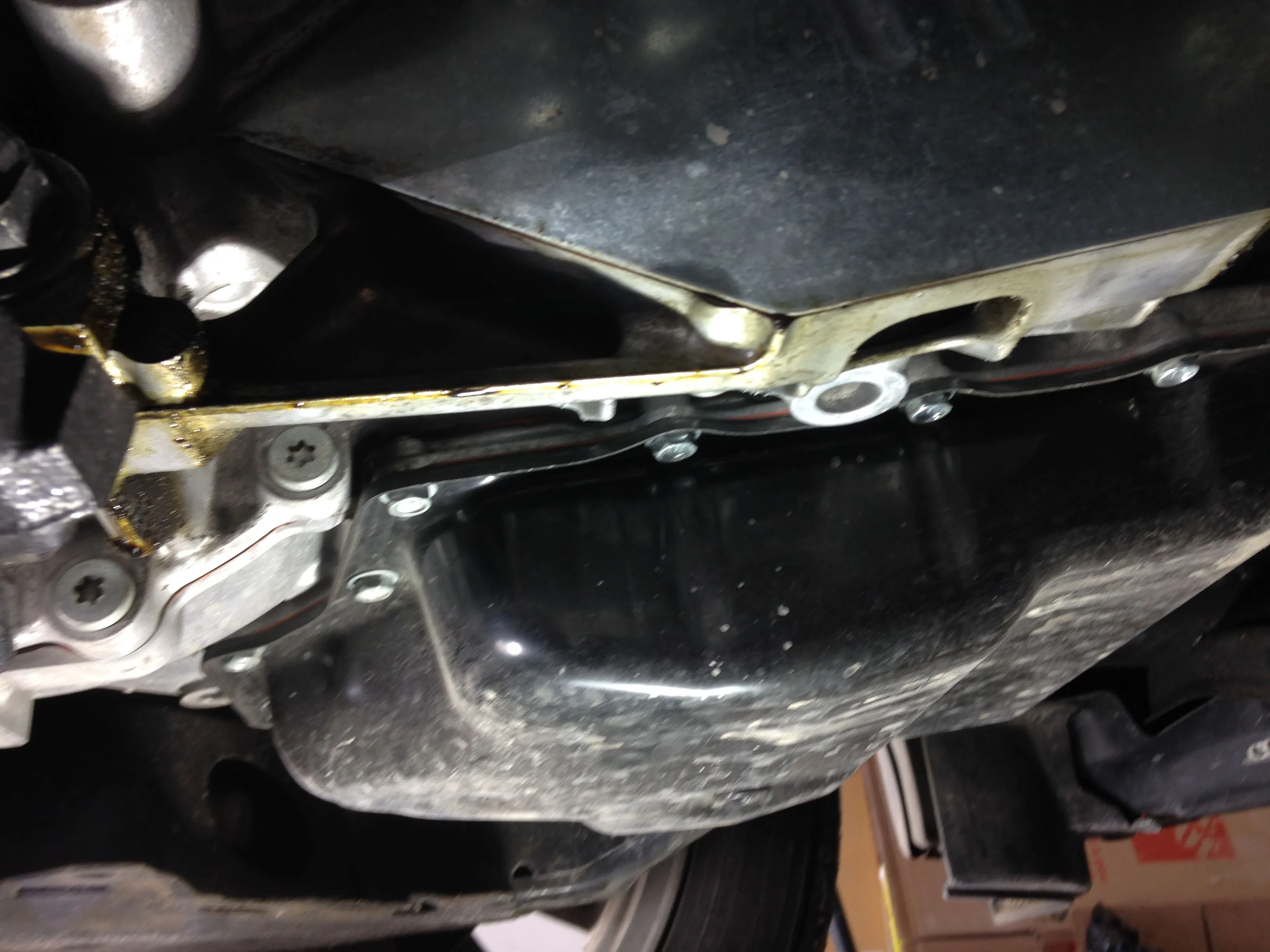

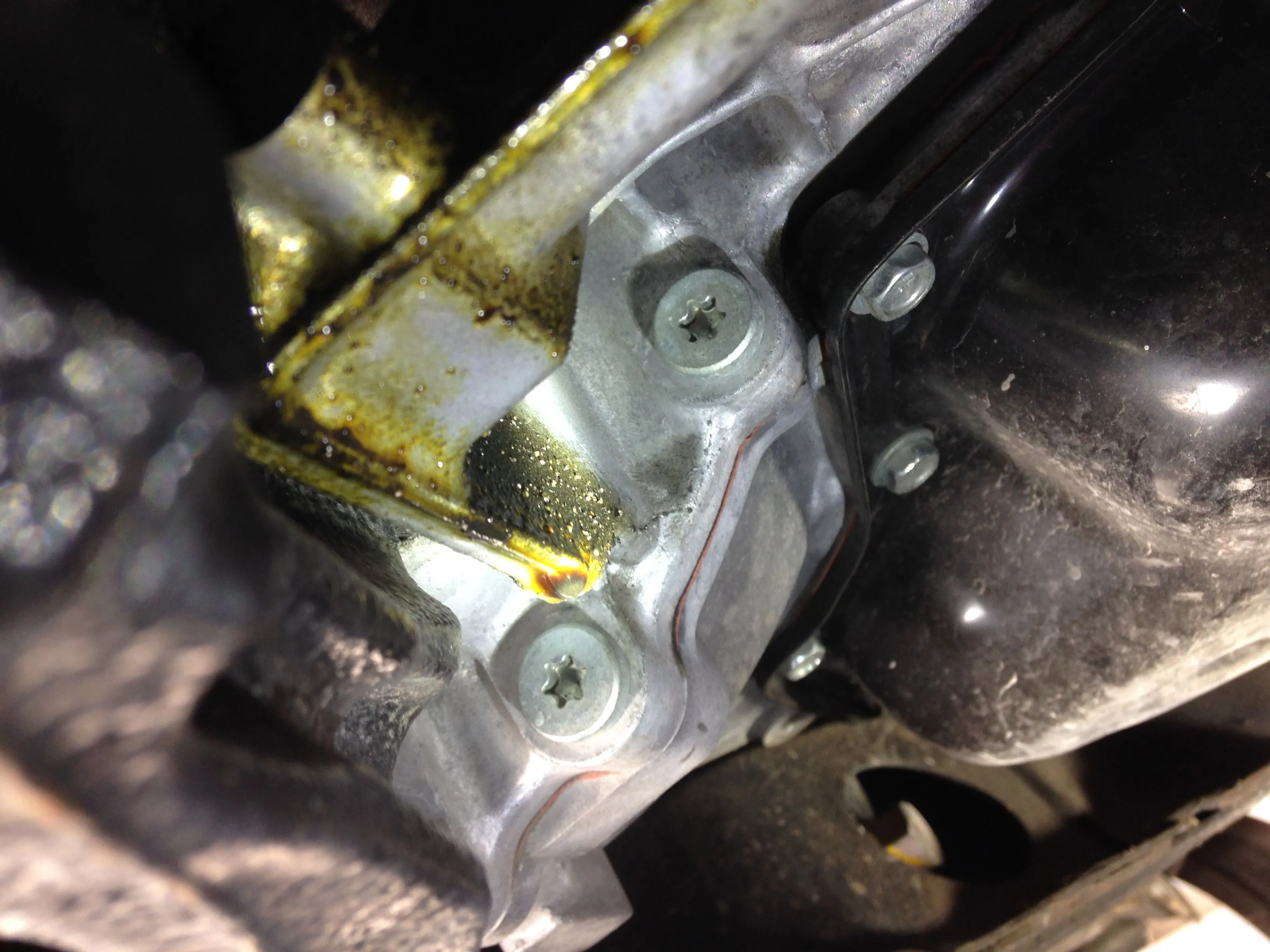

Looks like I will paying the dealer a visit. I noticed some of this residue when I changed my front diff and cleaned it up as well. I thought somehow it was leftover from oil change. Apparently not. Nothing big enough to accumulate on the floor but you won't see it unless you drop the front under-shield. Not hard but just a lot of screws and fasteners. Sorry for big pics... may not be easy to see on phone.

Just trying to cover all the angles. It seems to be weeping from somewhere around that solid cover.
Crankshaft cover I guess...
EDIT: Pics in this thread look the same as mine
EDIT2: It was about the same as pics but there was some residue on the top of the front plastic splash shield when I changed diff fluid in January. It was solidly clean when that fluid was changed about 4K miles ago. I only removed the small cover to change oil a couple months back and didn't look further.

I think it might be coming out of the hole that sits at the bottom of the cover.
This was solidly clean everywhere 4K miles ago after I cleaned it the first time. There was some accumulated oil in the top of the splash shield. I will keep you all posted on what gets replaced.
So this is between the engine and tranny?
Correct... hard to see if you don' t drop the under-shield as this area is mostly obstructed by oil pan. One might be able to see by just removing front fasteners on splash shield and shining flashlight back there though...
EDIT: This would not be easily seen with an oil change.
It looks fresh. Does it smell like gear oil?
Nevermind, its an AT. So it must be engine oil. Possible rear main seal. I've seen it happen on certain new vehicles. Sometimes it's residual from factory, but you've had the CX-5 for awhile and it was clear 4K miles ago.
I cleaned it up about 4K miles ago.. it looked similar at the time when I changed diff oil but thought it was just spilled oil from previous oil changes. The only other time I dropped the front splash shield was when vehicle was new to just look at things. It was clean at that time.
