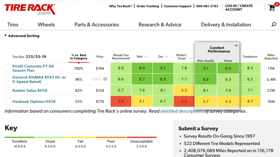

Currently for 225/55R19 tires, Michelin Premier LTX is the most expensive tire at $212.97 each from TireRack.com. The cheapest name brand tire is Nitto NT850+™ CUV at $107.65 each from ExtremeCustoms.com.
Consumer reports has different ratings than TR in different categories. What is the most suitable category for a more comfortable and safer tire?
I'm not sure how do tire ratings get constructed by Consumer Reports. I only check their used-car reliability ratings as that are based on thousands of subscribers' experience. Car reviews by their editors are not that good IMHO. Tire ratings from Tire Rack are also based on many consumers' opinion which I feel more comfortable to believe. Tire Rack also offers their own opinions with their own tire test too. As you can see, Tire Tack ratings have "Comfort Performance" which includes "Ride Quality" and "Noise". For safety consideration of these tires other than better performance on wet、dry、winter/snow conditions, I definitely choose a tire with higher maximum inflation pressure rating、A-rated UTQG rating on traction and temperature、and a name brand.

Thanks, I agree with it and have been trying to do the same.
- No UTQG BA or BB for me.
- Similar or better load and speed rating than OEMs
- Wet, dry, ride quality and noise numbers from TR rating as you mentioned
I'll also start looking at max inflation ratings now.
