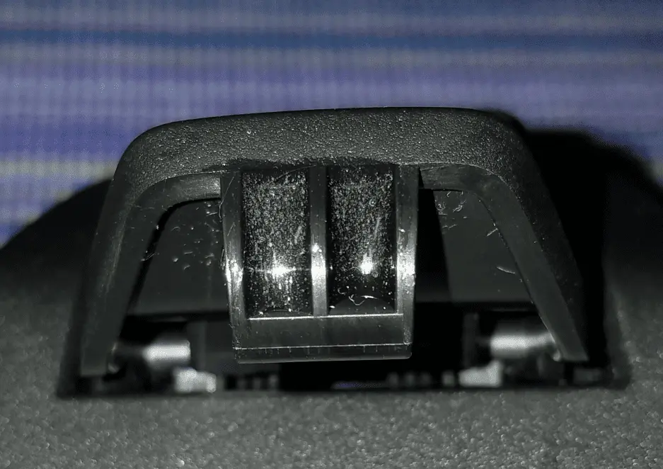

It's a poor design. Ours broke in the first six months. Replaced it ourselves with the instructions posted earlier in this thread (Thanks!). To keep the new one from breaking, we filled the voids with epoxy, as shown in the pics below. Bulletproof!
